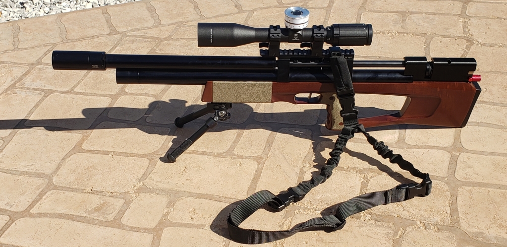

I just went through this myself . I wasn't thinking clearly and ordered an Mlok picatinny rail section. The problem is these are made for AR hanguards and have a protrusion on the bottom side that fits in the holes on the AR hanguards. Since I had it and didn't want to wait to order the correct one I just filed it off flat then mounted it on my Veteran. You need to order one that is just a flat bottom mount.

The wood is plenty thick in the fore end and I countersunk the holes for the nuts on the inside so they sit below the surface. As for a sling I went with a single point with the loop mounted on the scope rail.
