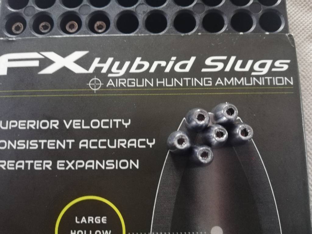

I've only used the NSA. But it looks like the effects are much lighter lots of empty space on the inside. Maybe you already know this but you're almost like a shell in the shape of a slug as opposed to a solid slug. The NSA are more solid, with a decent hollow in the point but not a big open interior cavity. Also the base is flat - no indentation or cup. The fx hybrids have and indebted base... not quite like a pellet, but going in that direction.
Have used and tested both. Hybrids are, just as the name implies, a hybrid of pellets and slugs. That is, they have a slug shape but with a pellet's weight. Nielsen's slugs are true slugs where they are much heavier since the only area without lead is the hollow point. The hybrids have a much larger cavity which is why they are so light compared to other slugs.

🔶FX Hybrid Slugs:🔶
🔸12 cents per shot
🔸1 diameter offered
🔸1 weight offered: 22gr
🔸Expands more, penetrates less than NSA slugs, because it is less solid due to its large interior cavity

I think something that is being missed here is the entire premise of what the FX Hybrid Slugs represent = slugs at normal for caliber pellet weights. This allows for cross platform shooting without changing your tune settings...not to mention expansion that nothing else even comes close too.

The Hybrid Slugs were never meant to be for backyard plinking...they're a serious hunting round made for serious hunting.
Yes! IIRC the specs are 32 grains & .415" long...it's been awhile but the long range .25's will be available next year sometime.
A ton of people think slugs are strictly for long range shooting and that's simply not correct...with my design it's all about terminal performance and expansion at 'typical' hunting distances.
If you have an impact velocity north of 800 fps the Hybrids will expand very well...depends on MV what distance that occurs at but using Strelok+ and similar apps are your friend for determining max distance 🍻
