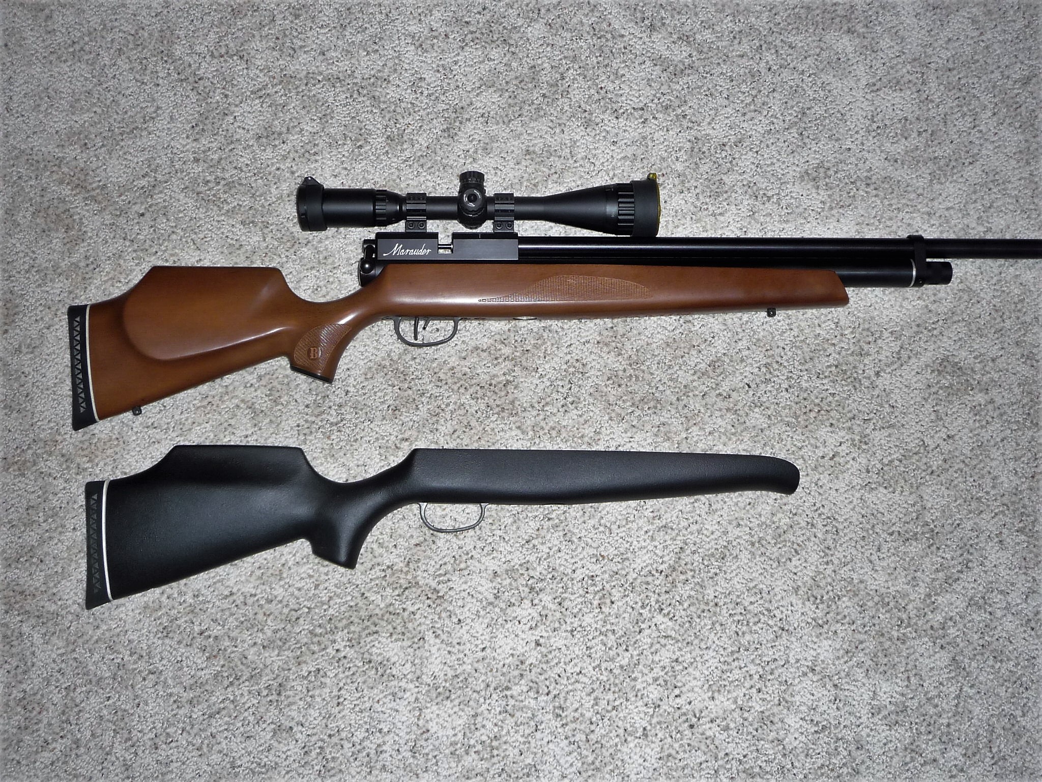

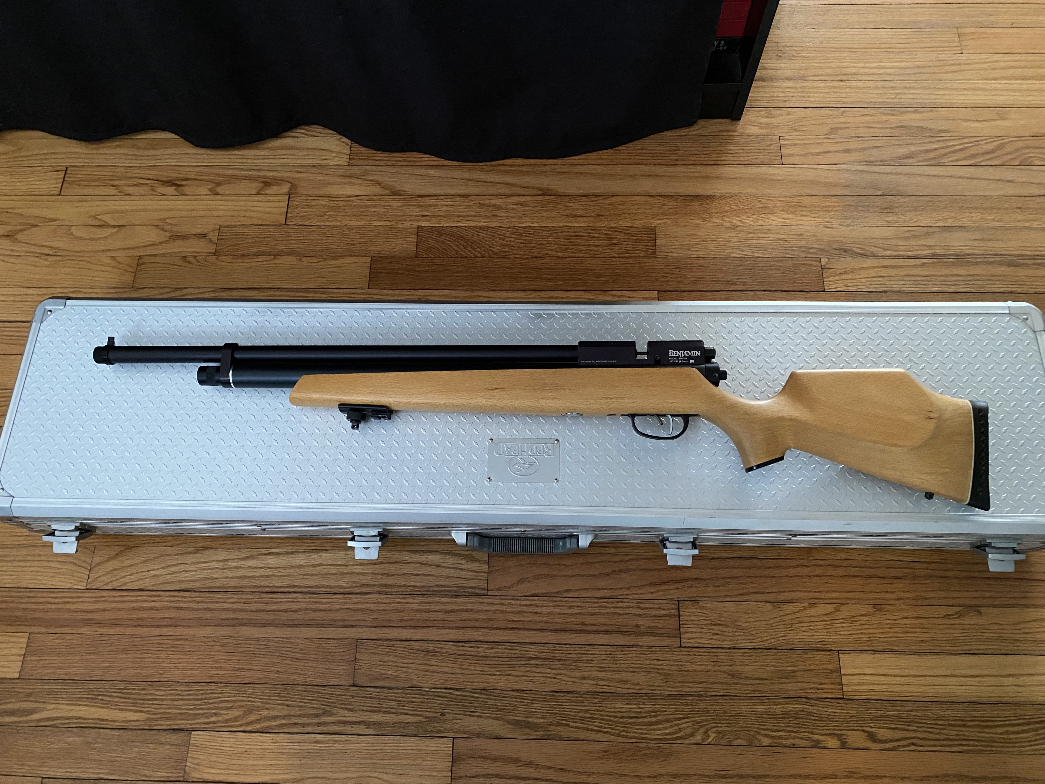

I had a Gen 1 Mrod and reworked the stock removing 1 pound of wood. Made the ugly stock much nicer.

I just got done with putting my Marauder Semi-auto on a diet. To make it balanced and pull to the shoulder easy I cut off 6" of the forestock and a total of 1 1/4" of the butt including the rubber pad.

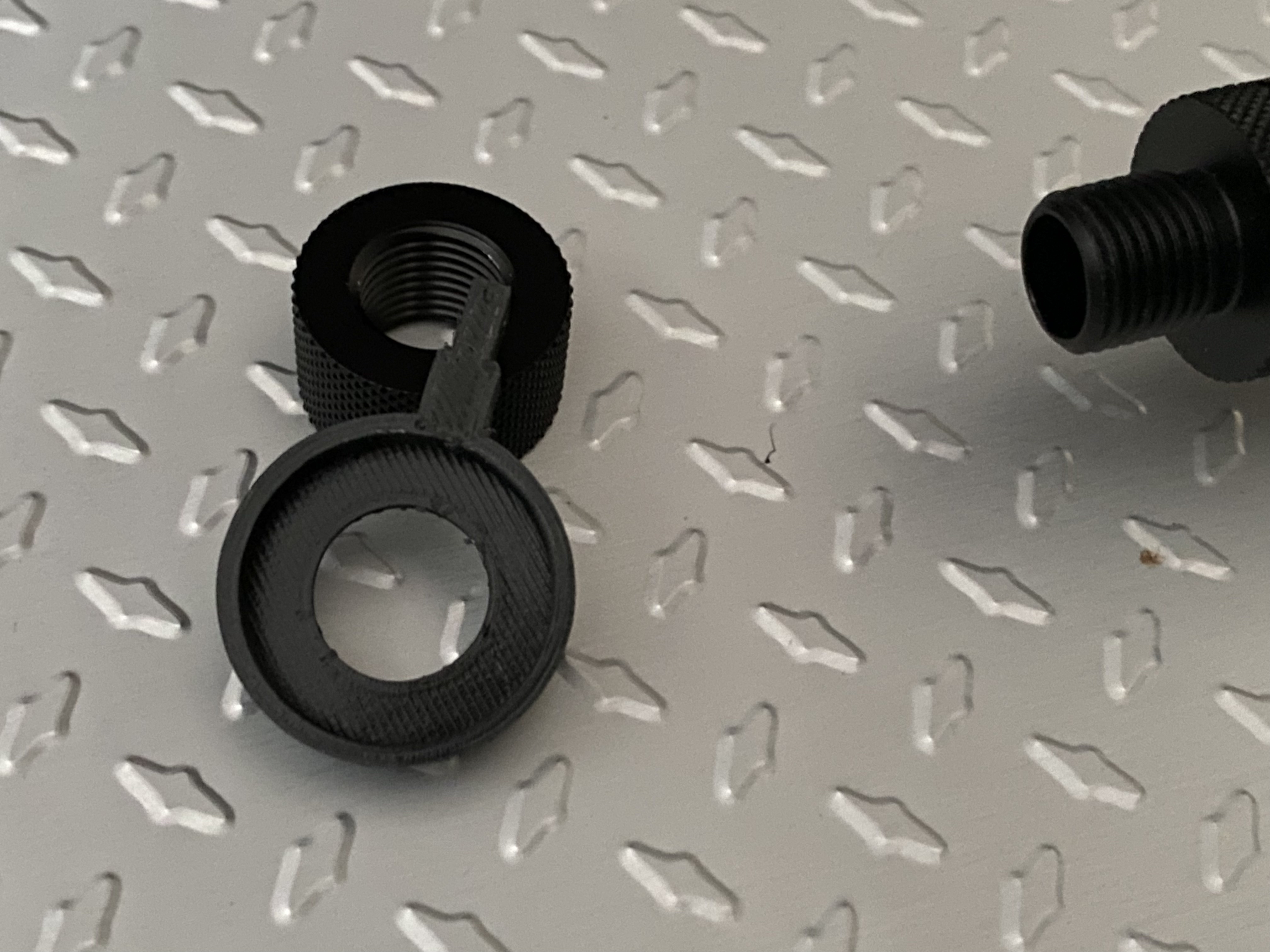

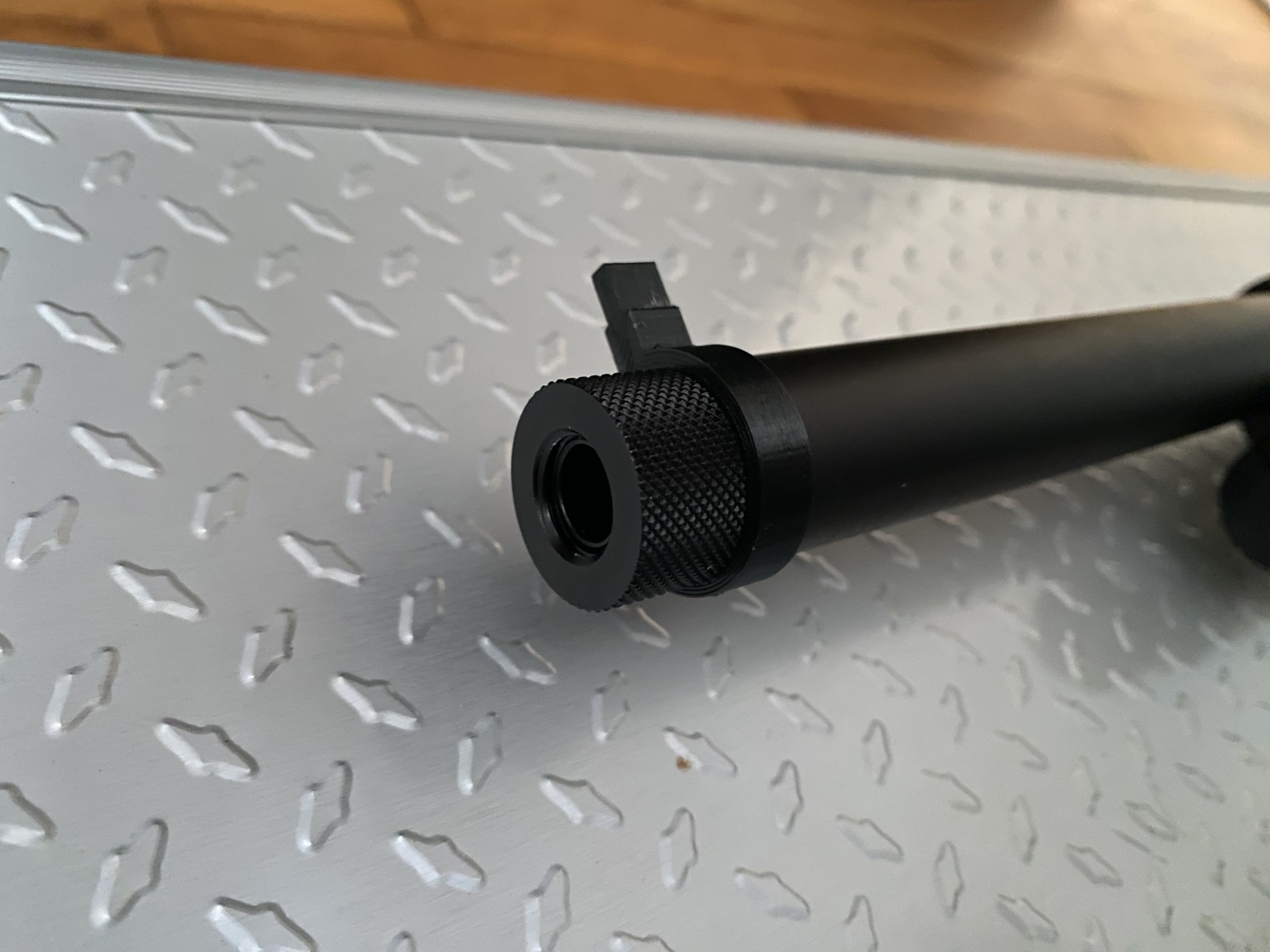

I am considering a stock chop myself, but I've decided to experiment with losing the optics all together and going with peep sights. I've done all I can myself by creating the front blade in OpenSCAD and printing it. I have a DFL Tanto I swap between the Dreamline and the Mrod and this slips tight enough to grip the knurl on the part of the adapter that attaches to the shroud. So it is sorta clickable and easy to center up. Then the thread protector holds the deal in place. It isn't fool proof, but it'll do. Now I just have to pony up about $80 for a proper rear sight, weighing somewhere around 2oz. If it works out, I save 24oz of top-heavy scope weight.
