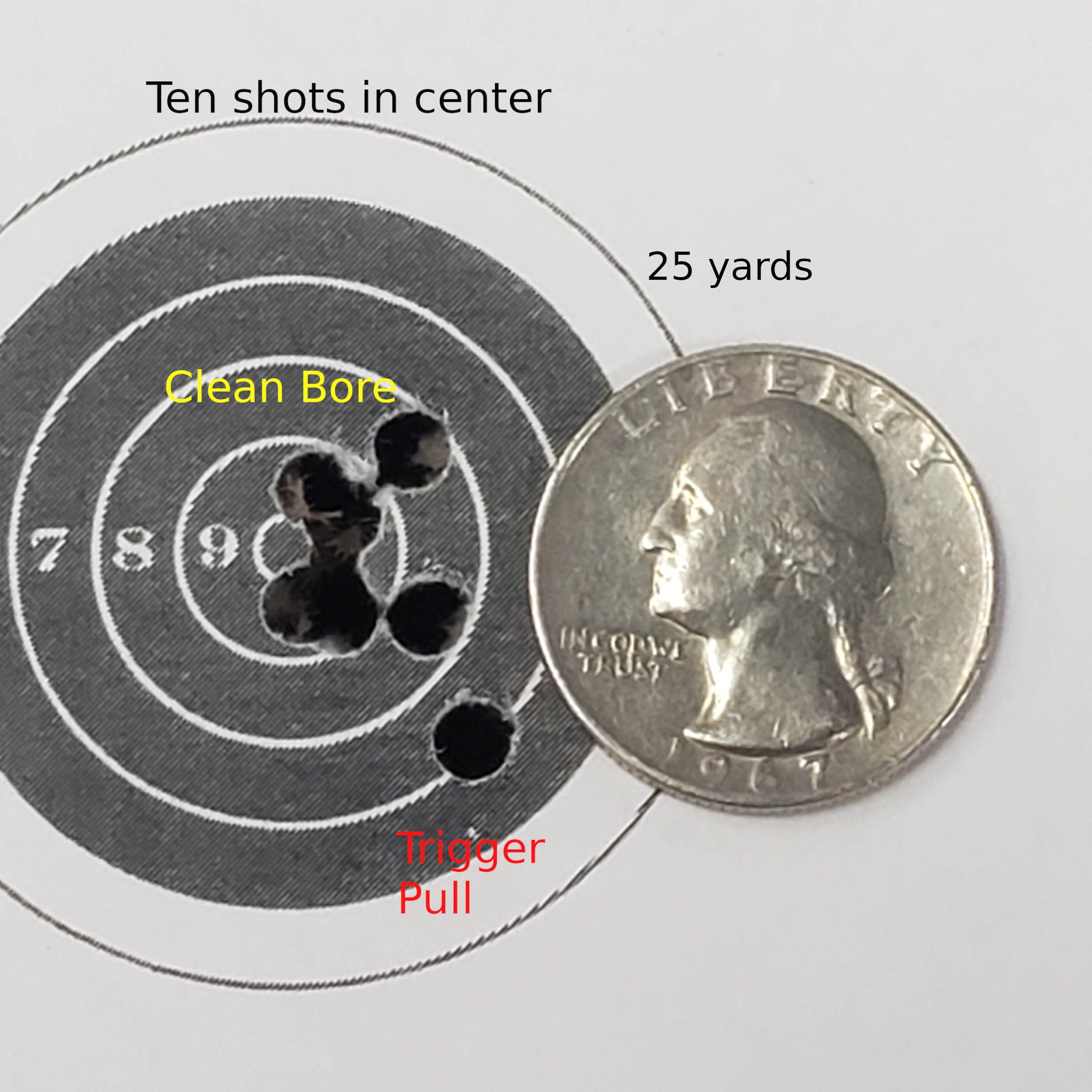

I acquired Jorge's .177 Stoger X10 rifle and set up a 25 yard range in my back yard. Using NRA 50 foot .22 targets I conducted a test for accuracy for an oiled and dry air rifle.

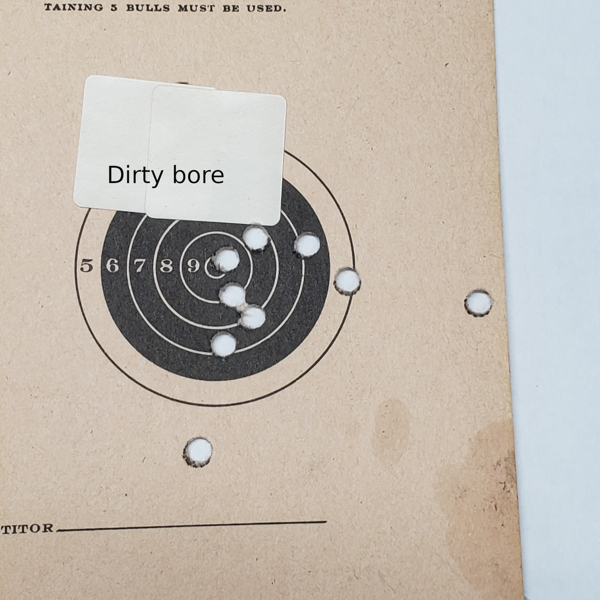

My first attempt to shoot for accuracy was a combination or normal a Dieseled shots. Accuracy was very poor.

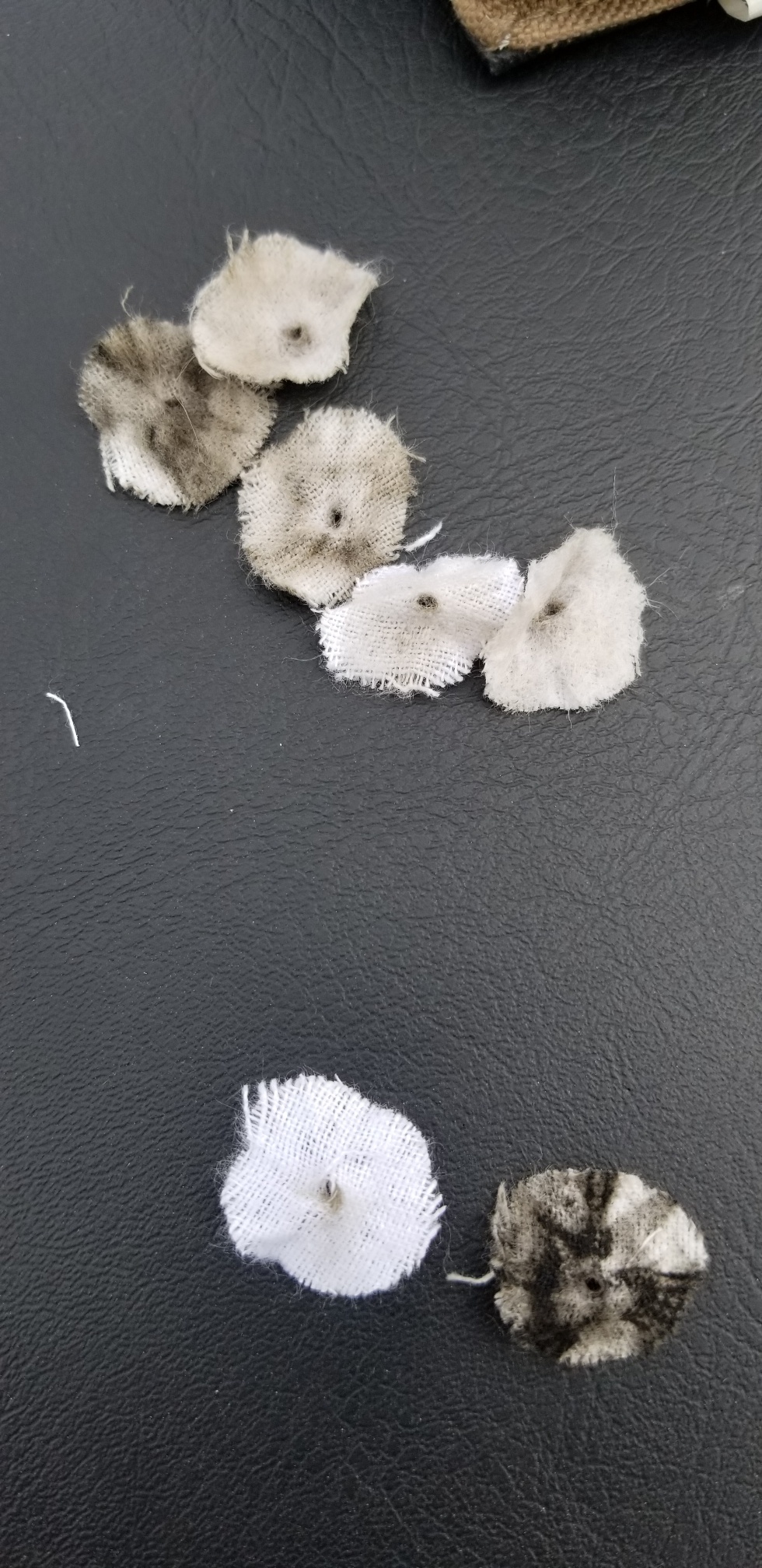

I ran a dry patch down the bore and it came out like I just fired off black powder! The bore was a gooey mess with the grooves filled full of crud. shots went all over the place.
I cleaned the bore until all of the crap was out and no lead fouling was seen.

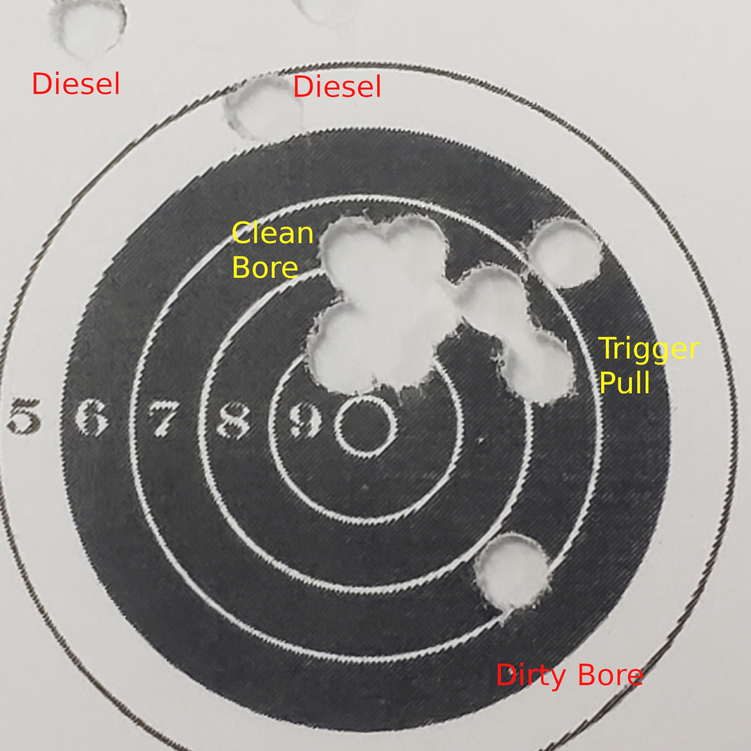

I then repeated the accuracy test and all went well until the years of gun oil got back into the chamber area and two shots Dieseled and went high and off target. The third shot went low right and the hole in the paper had a black ring of crud around the hole!.
I cleaned the barrel again hoping the Diesel action was finely gone and it appears that is has.
Now the problem is the Stoger X10 trigger pull. It is so hard to pull through to the 2nd stage that after ten shots in five minutes I start to "palm" the stock throwing my shots off of the bull to the right ( I'm left handed )

Note the crud rings around the holes

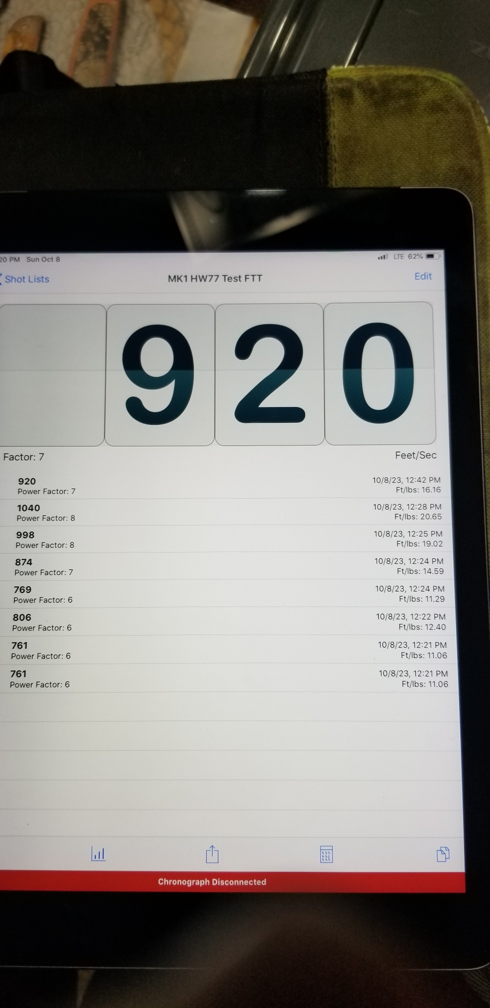

Very sorry to hear about your loss. What you’re describing sounds more like detonation than dieseling. High powered springers are going to diesel slightly if petroleum lubricants are used. Tom Gaylord has done articles and videos discussing. Nothing to worry about. Detonation on the other hand will cause accuracy issues and can damage the rifle. I’m assuming you have a chronograph. If you hear a loud bang and get a big velocity increase it’s likely detonation. Hopefully it’s solved. Sqwirl57 he said it’s a .177 Stoger X10. I don’t know anything about it. I’ve seen others that do post through so hopefully some help is on the way soon.
