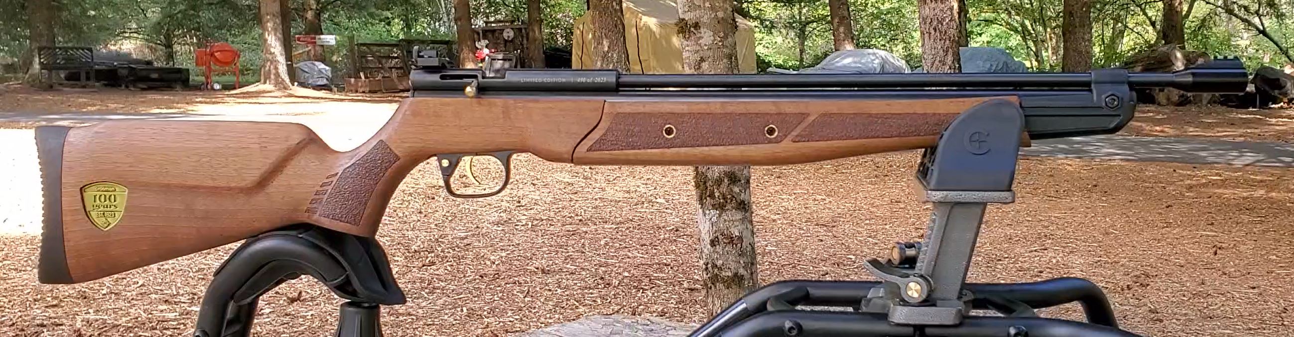

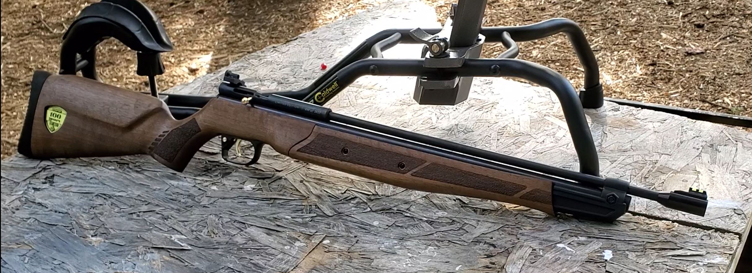

I got the 100th annivesary edition. #490 of 2023 made. So beautiful. Williams peep site. Fiber optic front site. Super light weight, yet solid.
It won't pump up. It did at first, but then I :
dry fired it many times filming the trigger
shot it once with the bolt open, it snapped shut
When I sat down to film the shooting portion, the gun would not pump up.
Did I do that?
Are you not supposed to dry fire pump guns?
Like this gun? I posted a thread with alot of close up pics here: https://www.airgunnation.com/thread...man-326-close-up-pics-2023-were-made.1297072/
I'll bet that's going to leave a scare. :oops:
It seems like a tragedy, but one o-ring later it will be good as new. It may be broken now, but it will ALWAYS be #490 !!

I wouldn't think dry-firing that pumper could result in any problems. It has essentially the same mechanism as the 1322, doesn't it? I've dry fired mine many times, without any problems. I'd first look at the seal between the action and where the compressed air is stored, immediately below.
As mentioned maybe some o-ring got dislodged somehow. Maybe one was damaged, but I'm having a hard time imagining which one could have been damaged.

Great, thank you for the info. I feel better. I can update this thread when I find out what happened. I will look at it.
so, let me get this straight
you pumped up the rifle, left the bolt open and slammed the hammer against the open bolt slamming the bolt into the breech and now it will not pump up
will it dry fire, can you cock the gun and the hammer moves back and is held with the sear or is it jammed up against the valve holding the valve open
i am going to say this, trying to be mean but that is a careless mistake
and for an Oring to be damaged ????? the valve could have been damaged
you will tell us sooner than later i figure

Oh...that may have done it. Nothing seemed jammed. The bolt was going back and forth okay. I tried everything to get it to hold air so I'm sure I tried to cock it. I think that Crosman will have to fix this one, but I can still find out what happened I think.
Cock the gun before pumping. With no air pressure the hammer is opening the valve.

OK here;s what happened" pulling the bolt all the way back in cocking position then pulling the trigger bolt goes forward not quite aliened and hit the poppet vale and bends it off center then holds vale open so when pumping the air goes through the vale that is opened and bent will not seal until straighten up"Sorry man" but that's the way the cookie crumbles.
