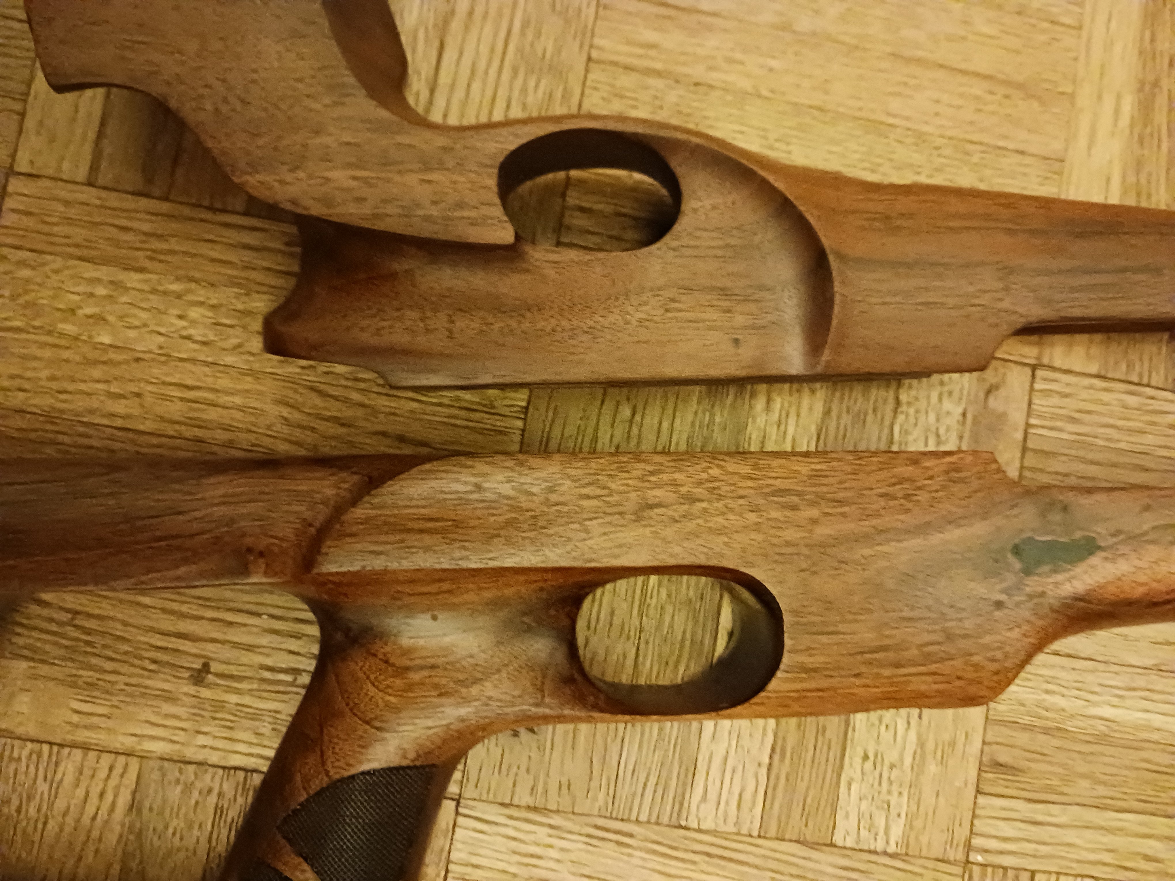

FX Did FX Racheros come with different triggers?

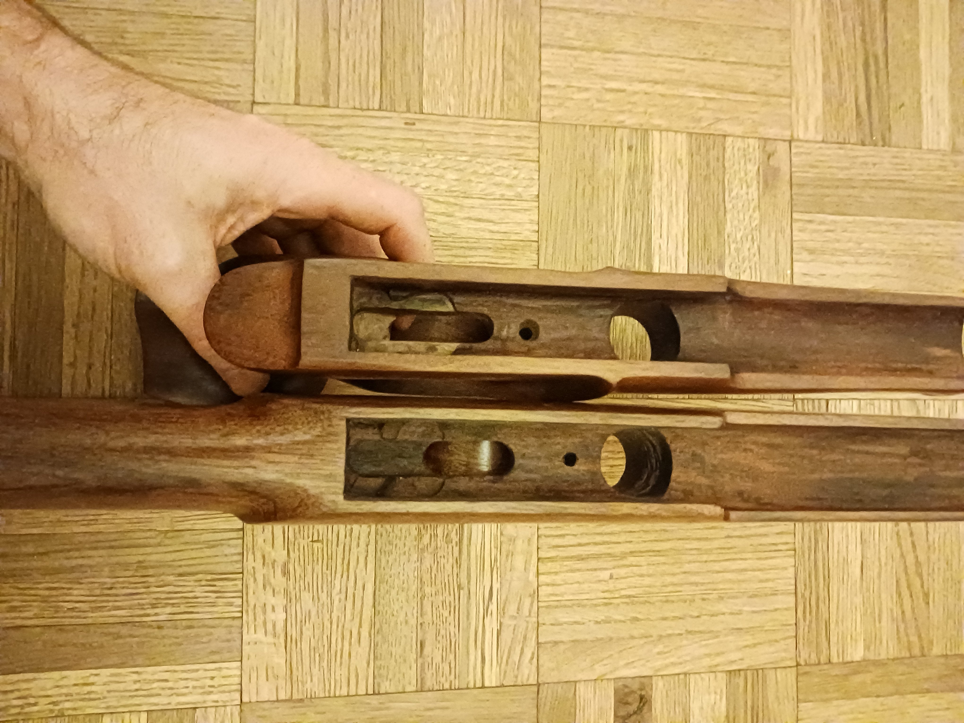

Got a Steve Corcoran stock that appears to be quite old for a FX Ranchero. My Ranchero appears to be quite old as well. The inletting is for a different trigger. With the trigger blade removed my gun does fit in it. But you can see the differences here.
Reactions: Nutcracker
Well, flipping the trigger bar around backwards worked. Mounted the blade in another hole. Had to rearrange the set screws on it, and still need to modify one screw or the blade for clearance. So, that is less than ideal that'll have to be done any time I switch stocks. But that seems to be the fix for now. Maybe in the future I will just make a custom trigger blade I can swap.
