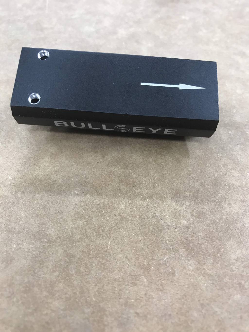

Received my order from PA today and was disappointed to say the least. Ordered a Diana "Bullseye" mount for sixty bucks. Received a mount made in china marked "Diana" on the side. If I wanted a cheap $20 mount like that I would have just bought a $20 Ohunt mount on ebay. I was invoiced for a Bullseye and their pictures and decription say "Bullseye". Seems deceptive at best on their part. Needless to say it is going back.
I was under the impression that PA was selling the real McCoy.
Diana went the cheap route and the "Real McCoy" is Made in China. Usually they are decent quality but as with most China stuff not always. Also some play in the unit is acceptable and will not affect accuracy. As long as the unit locks up tight in its resting state. Try it out and see how it werqs for you before you quickly dismiss the unit.
As with most things if you have it made in China the usually poorly made copies will be right out.
I I understand that many quality products can be made in china. Heck I bought a 46U from Mike at Flying Dragon and had him do a full tune on it. But I made an informed decision to do so and it was priced accordingly. Using a pic of the "old" version seems dishonest. As I mentioned before it looks exactly like $20 mounts on ebay.
As far as the mount itself It will not reset by itself and there is notable lateral movement with even minor torque when I hold it my hands. Not impressed even if it real deal these days.

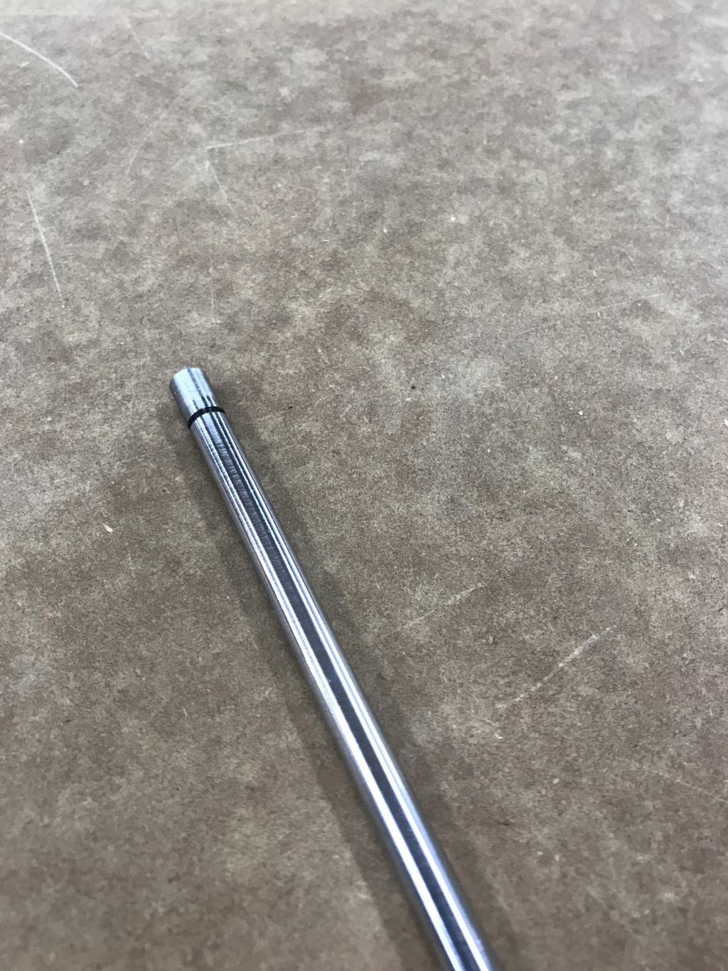

As Odoyle said, most of these PRC no name bullseyes work well. The trick is in how you put your scope into them and fix the sliding pins into the mount (threadlocker) ... Experiment a little and you will see it usually stabilizes the sliding mechanism. And keep in mind a little slop won't hurt.

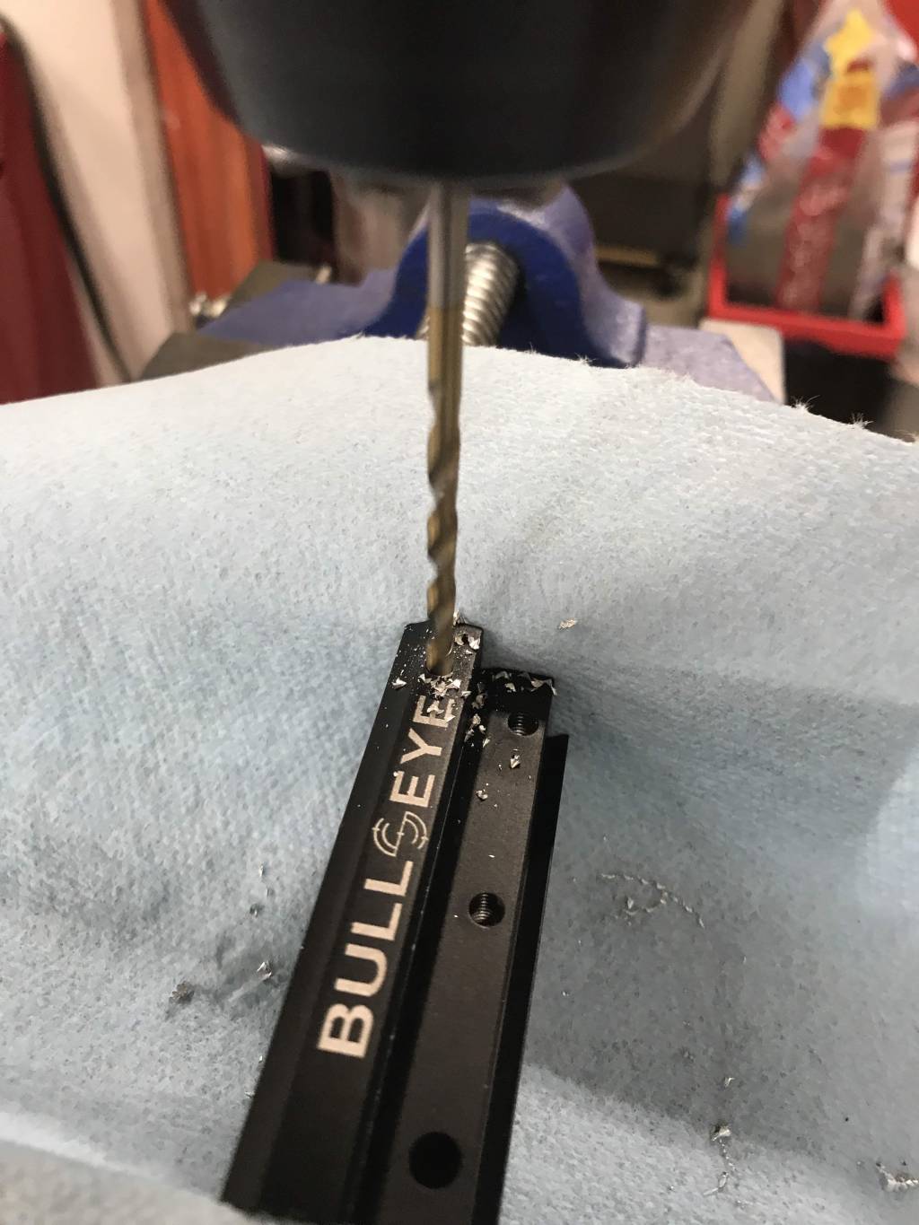

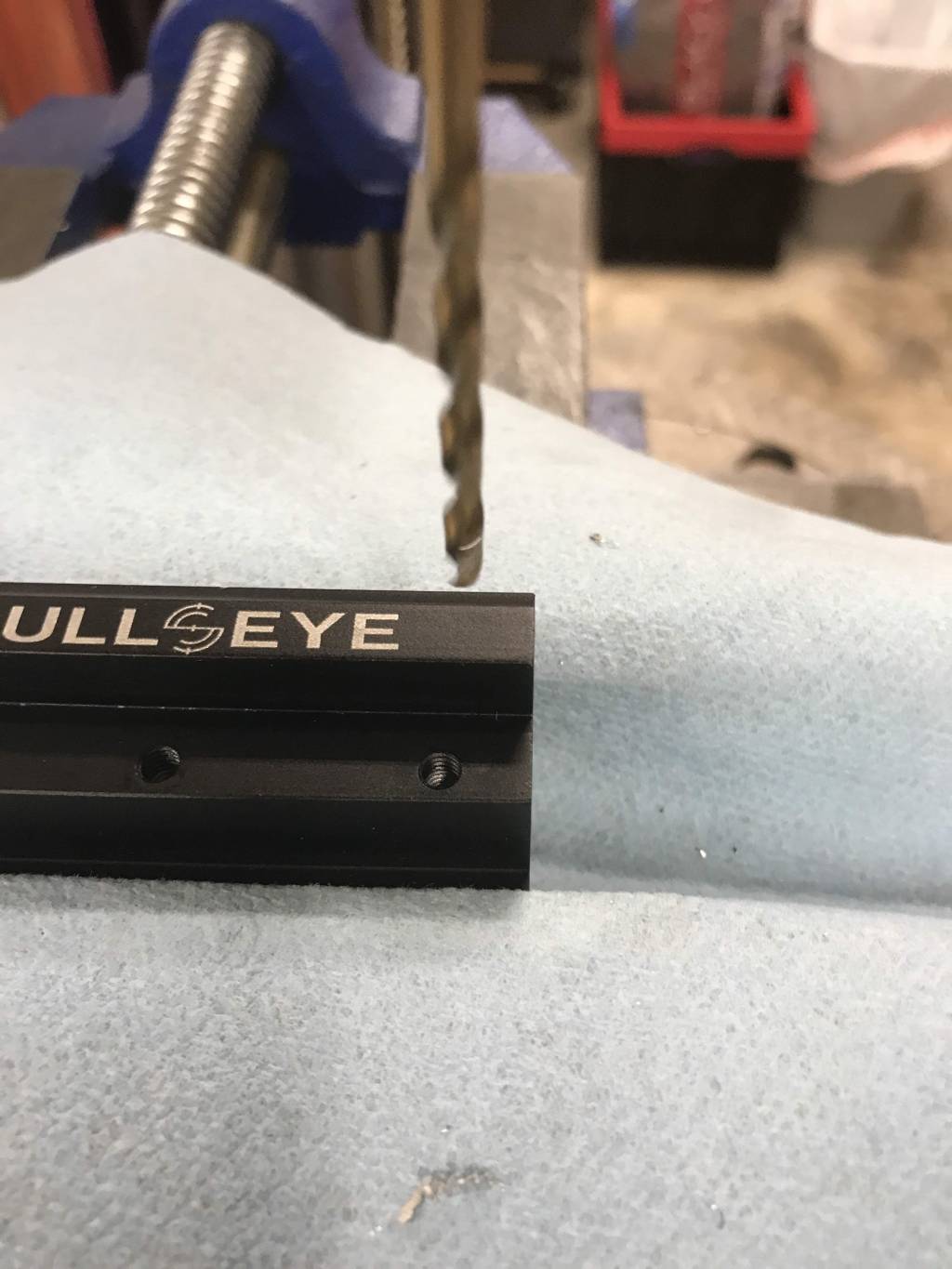

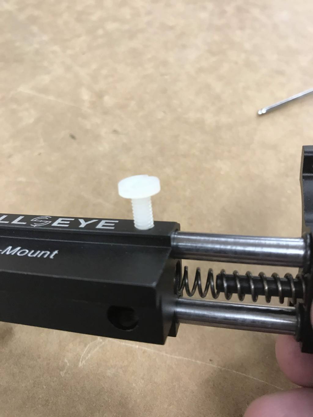

One German guy I know couldn't stand the slop, went all out and machined pins that are a fraction thicker. Another cut 2 screwdrivers to pieces for thicker pins. Another (me) tapped a hole into either side of the mount for an m4 nylon screw to pressure/fix the pins slightly. Spielerei ... I would simply put in some industrial type grease and experiment with the tightening mechanism until it feels reasonably steady.

I do however like the idea of the nylon screws as it is the same thing I was going to do with mine if I had to. But after some cleaning and lube I managed to get it loosened up so it would slide well. Although it still has a little play in it when it is in between stations it locks up tight when in the home position and that is all that really matters.
