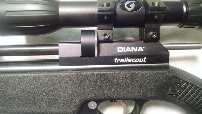

I received the rifle on 11-7-19 , it was in good order, nice looking little rifle; Black synthetic stock/butt pad, with nice checkering on the forearm and pistol grip area, blued barrel/anodized breech, adjustable rear sight push type safety on trigger guard, adj. trigger, muzzle shroud and 11mm scope grooves on the breech, OAL 39.5”, 5.4 lbs! Nice lightweight compact Rifle! The front sight looks sort of like a sharks fin, odd, but I understand it, the front sight height is .675” above the top surface of the barrel; because of the rear sight height and location. You would not want a tall slender front post at that height; it could easily be bent etc. so this design gives the front sight the needed support at that height!

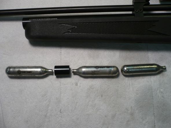

Included with the Rifle was a small plastic bag with, 10 assorted o-rings (replacements I assume there was no EVP or schematic included) and the “adapter” for the 3-12 gm cartridges as they now call it, (*called the cartridge carrier in the Shot Show video!) The Adapter is a one inch long round cylindrical anodized aluminum housing with a .075” hole in the side and houses two recessed piercing pins, one in each end, which allows 2 cartridges to be pierced with the third pierced at the valve, which pressurizes the tube sealed by the o-ringed screw on cap at the front of the tube.
After insertion of Co2 carts, in the “right sequence”; first cart in small neck first, second cart small neck up, then the Adapter and the final cart in neck down! There is a toggle lever attached to the threaded 0-ringed seal cap that hangs down, that; after tightening, it is raised up which forces a plunger to press all three Co2 cartridges into the piercing pins which will thereby pierce all three Co2 Cartridges at once! (INSTRUCTIONS ARE INCLUDED IN THE OEM!) Simpler than it sounds!! Also included were 2 magazines one of which came with the Rifle and the other the extra I ordered.

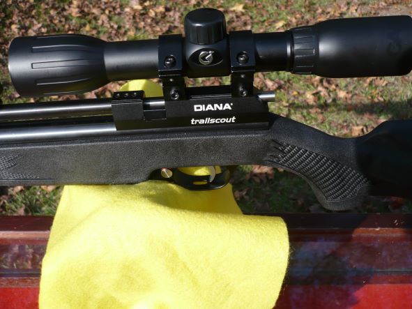

All of my initial testing (first 100 shots will be with open sights initially, however I do intend to scope the unit in its final iteration for accuracy testing. I have a NIB Gamo fixed 4X with Parallax set at 25 yds. I have had around for a spell should be a good fit for this rifle. I set the trigger @ 1lb 12 oz.
After checking all stock screws etc. was ready for the first C02 charge, one note here, I found the toggle lever securement bolt and nut very loose, retightened and good to go that’s why it’s always a good idea to check all attachment bolts screws etc. particularly on any new rifle! I used some Silicone grease to lube the Co2 cap o-ring and the inside lip of Co2 tube (*Note original cap o-ring appears to have been a standard rubber o-ring and was “unusable” after first charge due to swelling; replaced with a poly type that was in the o-ring kit that came with rifle for subsequent charging!. The cartridges and adapter were installed in the proper sequence with a drop of silicone oil on each tip, and the tube cap tightened, once the tube cap was secured (* I used a 2.5mm Allen wrench inserted the long end into the tube cap allen cap screws to do the final tightening) I lined up the toggle lever and raised it up which forced all three Co2 cartridges to be pierced simultaneously!! The rifle was now charged. I cocked the rifle and fired once to be sure; and there was just a “phfttt” sound, I thought what the heck, hammer must not be hitting the valve stem hard enough???

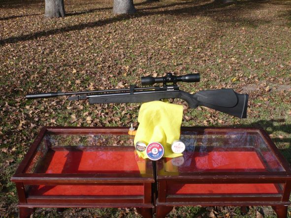

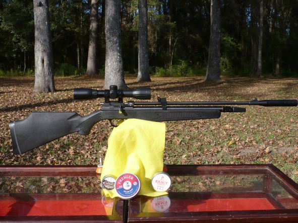

I am now going to mount the scope and try to get in some accuracy testing; I will use the single shot tray for all accuracy testing; testing will be done at 25 yards from bench rest. After mounting scope and preliminary sight in I started the accuracy test. Got a break in the cold weather 76 degrees!!!! I used 3 pellets – Polymag Predators 8.0 grain Crosman PMHP 7.9 grain and JSB Exacts 8.4grain.

The Trailscout Co2 Rifle is a good lightweight compact Co2 rifle with an 85 useable shot count (600+FPS). Yes it will achieve a 100 round shot count; it would be the owners choice as to when to stop and recharge!
I found the accuracy to be very good with the Polymag pellets and acceptable with Crosman PMHP/JSB Exacts. There are a few additions from the factory that I think would be helpful; a degassing system, Poly type o rings thru out and a second barrel band, and finally a EPV Schematic included, other than that this little rifle is good to go!! Charge it up load the mags and your good for an all day excursion, unless of course; one shoots more than 85 – 100 rounds!
