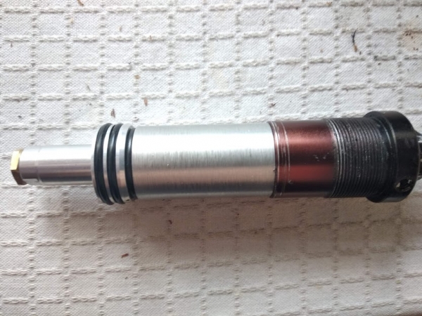

I want to buy the Skyhawk mod it for more juice to shot distances between 50 and 120 meters
I have read somewhere i guy sling the jsb beasts to 880 fps thats a good number for those heavy pellets.

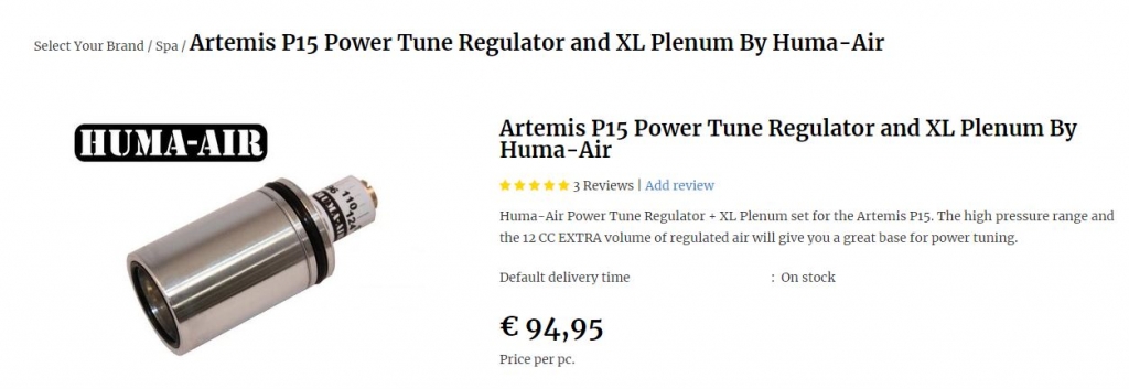

Huma sells a regulator for the m10 that have a bigger plenum and will fit in the p15 aka skyhawk and can set to 170 bar i think.
Is this enough for gain more fps or do you need another valve?

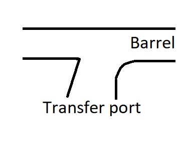

Work on transferport and pellet probe can be done.
