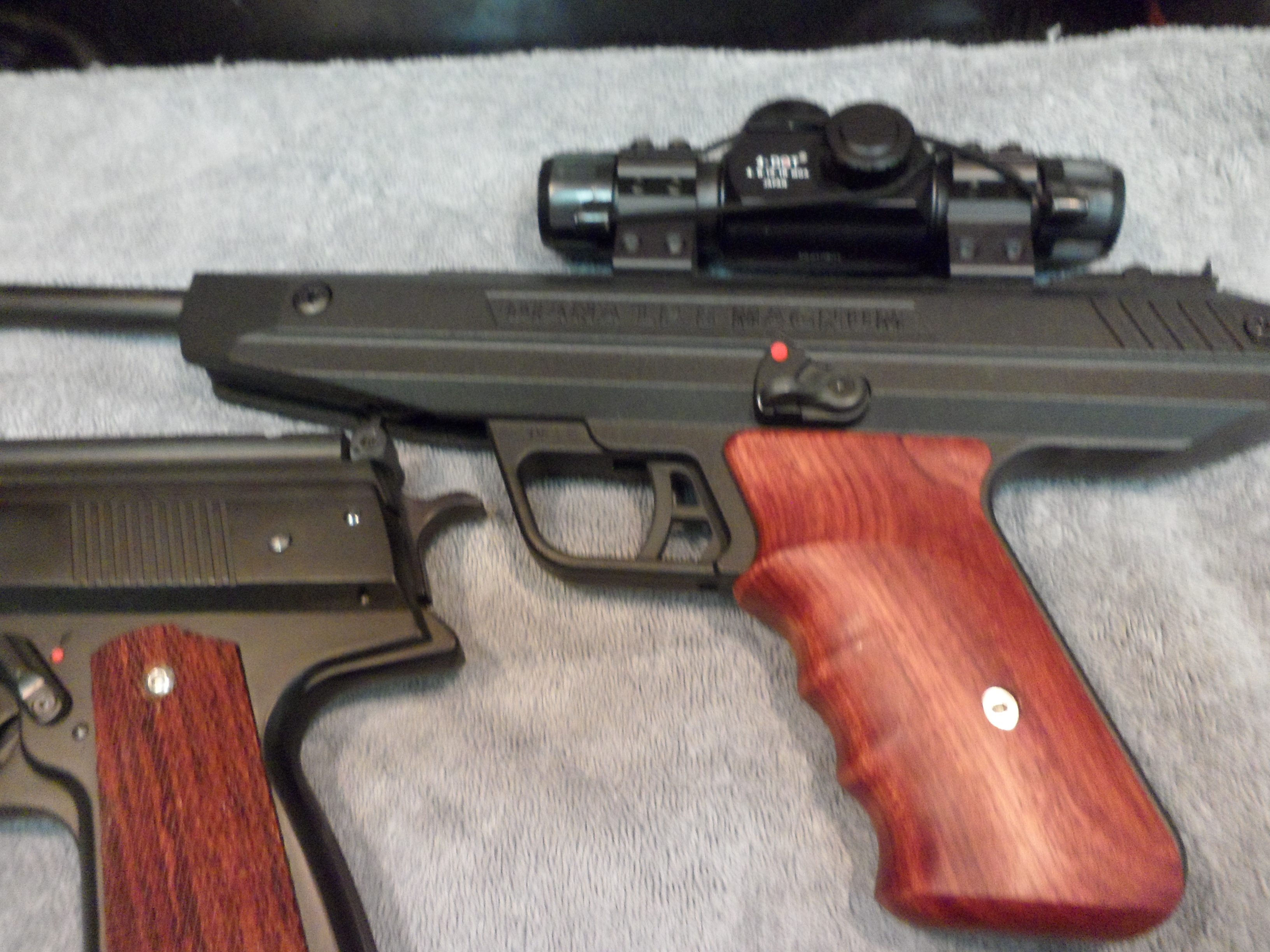

it is very big and it is heavy and the trigger is very poor for us trigger snobs like myself
i completely rebuilt mine to the point it is as good as a target pistol

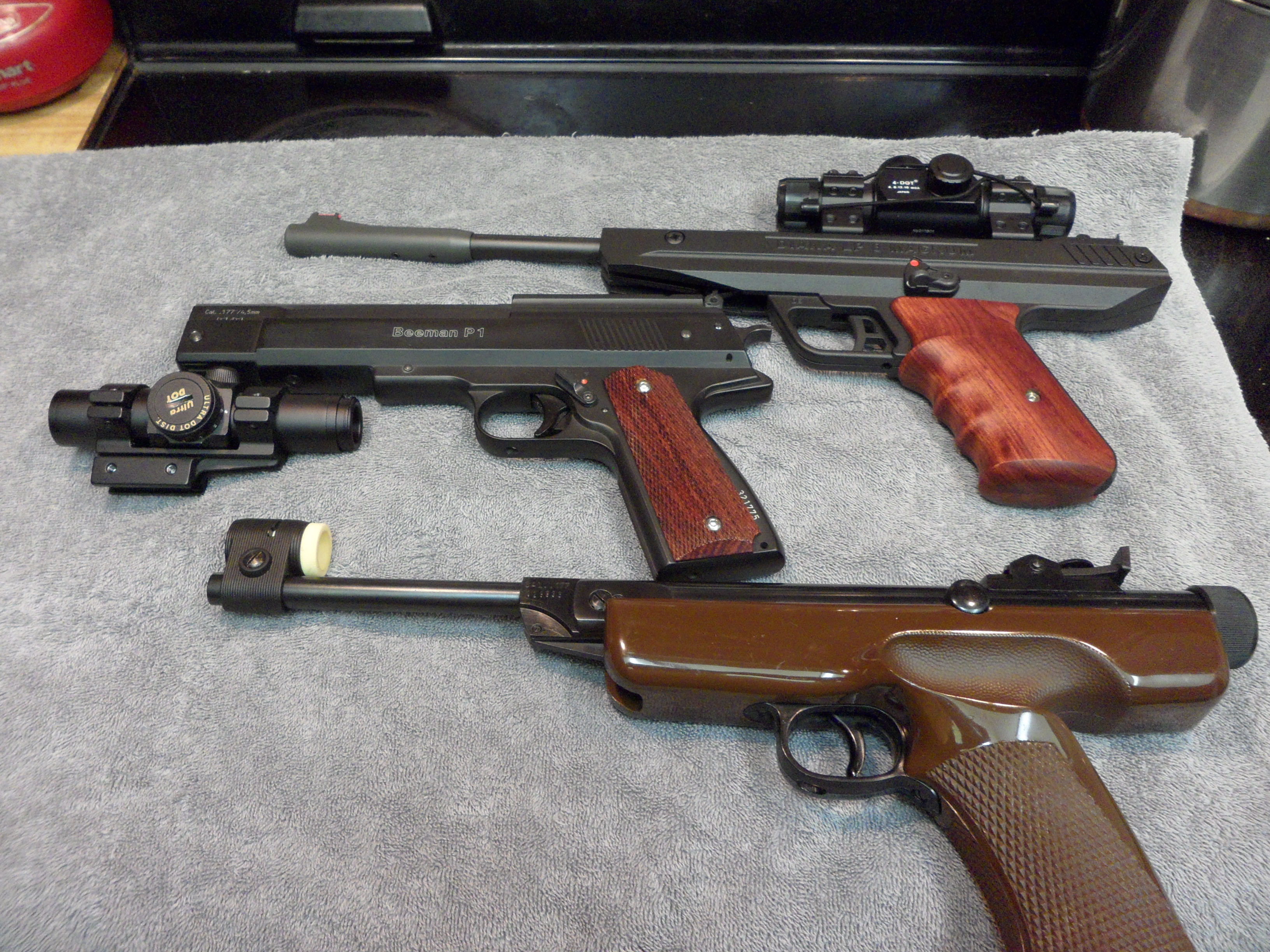

there is the LP8 with a Beeman P1 and Diana model 6
those are Ultra Dot Red Dot sight
