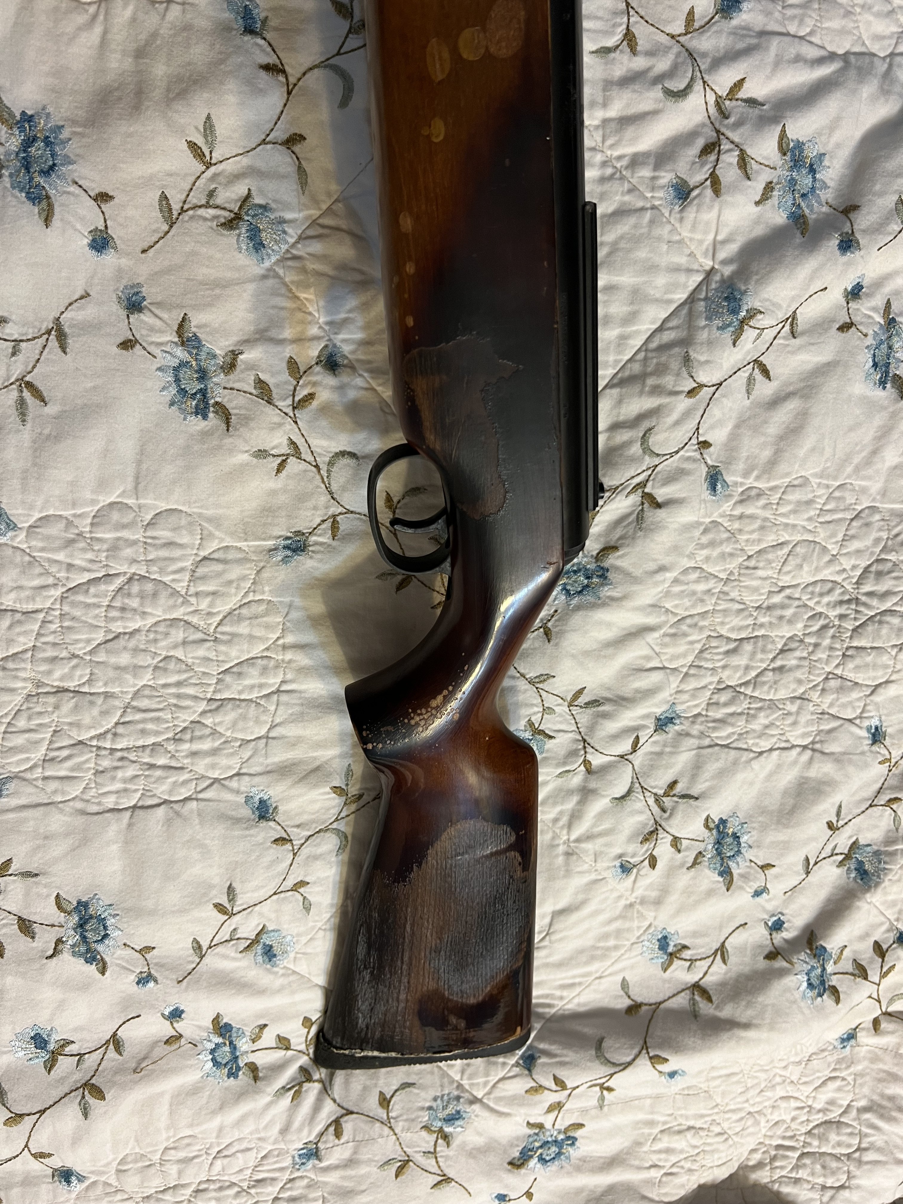

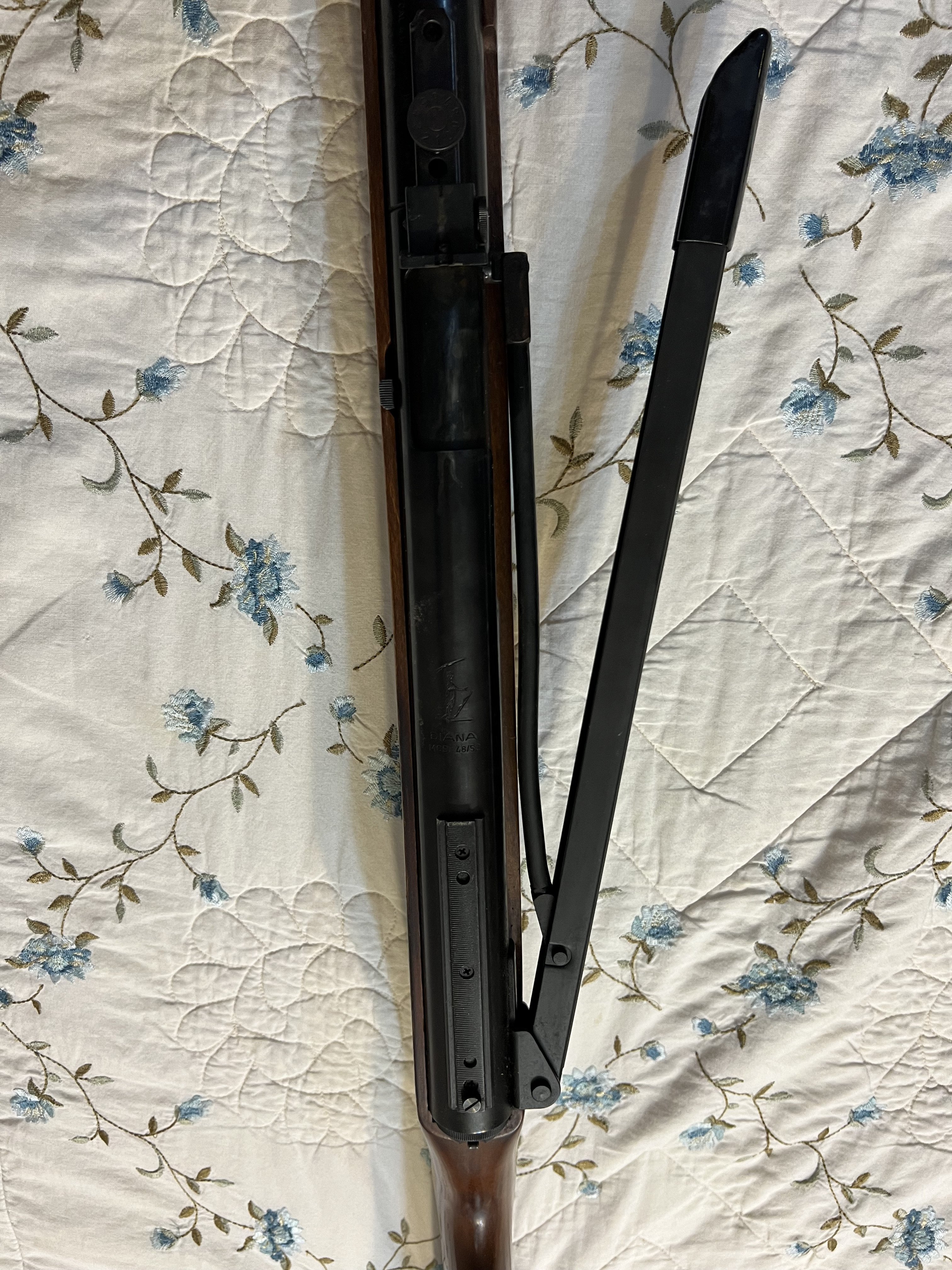

The air rifle was in a house fire. The stock is burnt and cracked from the heat. The charging handle appears bent. The air rifle sat untouched in a damp basement for the last 20+ years. It will chock and fire a pellet, but from 6 feet the pellet barely penetrates the surface of a board. I suspect that between the fire and the years in a damp basement, the chamber seals are damaged. I fish, not hunt, so I am uninterested its keeping the air rifle. Friends of mine who do hunt agree with mar flow 777. The cost to repair probably exceeds the value. They suggested selling it for parts. I will purse Hastful McNasty's want ad suggestion. Mike
well, that is a bit different then i thought,
so, the stock is damaged, but it would be a great stock to strip and repair and paint for someone
the cocking arm looks okay but the connecting rod looks damaged
