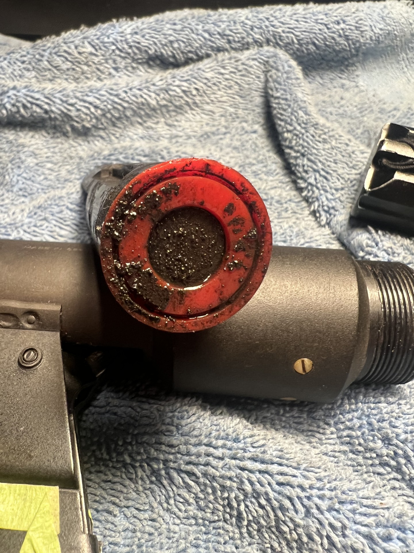

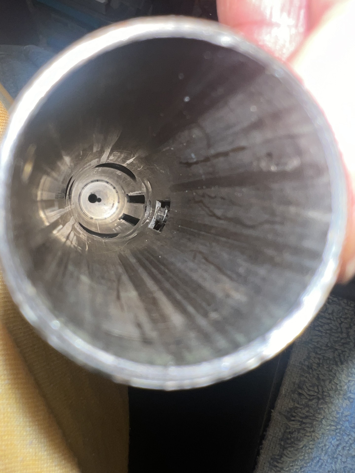

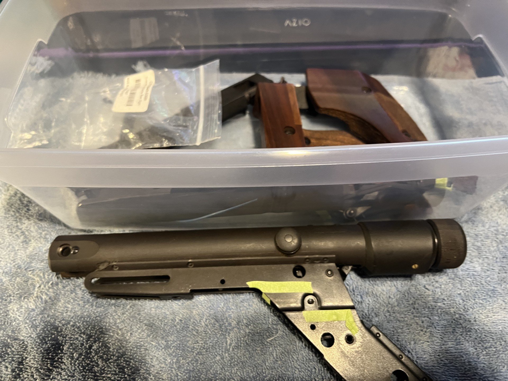

i just couldn't take it, so apart it came
you know i hate to say it but this job i paid money for was done very poorly
rear sight screws were 2 turns loose the barrel pivot area is as dry as a bone, the front piston has not one bit of oil or grease present i see no oil or grease anywhere and the rear cap which i have not got off, the screw was not in place
this coming from, at the time a well thought of rebuilder, i am not an expert but at the same time i am a damn good mechanic and that means there is one way to do it, THE RIGHT WAY
they come apart besides the rear cap in 15 minutes if you are slow
i have to take a spring out that will clear the sear and the guts
tomorrow i will see what the problem is, oh wait THERE IS NO DAMN LUBE IN THE PISTOL HOW BLOOD STUPID
you can tell i am pissed oh well i have another 10 to do this will be practice
rear cap is off and yes it is 1:30AM in the Seattle area, it was SOB to get off and yes it would have kept me awake all night
the rear cap has the factory original spacer behind the step washer and the rear piston seal was never changed
now i sent all the parts needed back to him
rear cap is soaking in acetone
side gear caps are loose already so i can take the guts out as planned
to say i am disappointed would be a huge understatement
i guess if you want it done right do it yourself
and the rear cap was taken off with a 6 inch vise and an old Bianchi leather belt
more to come
