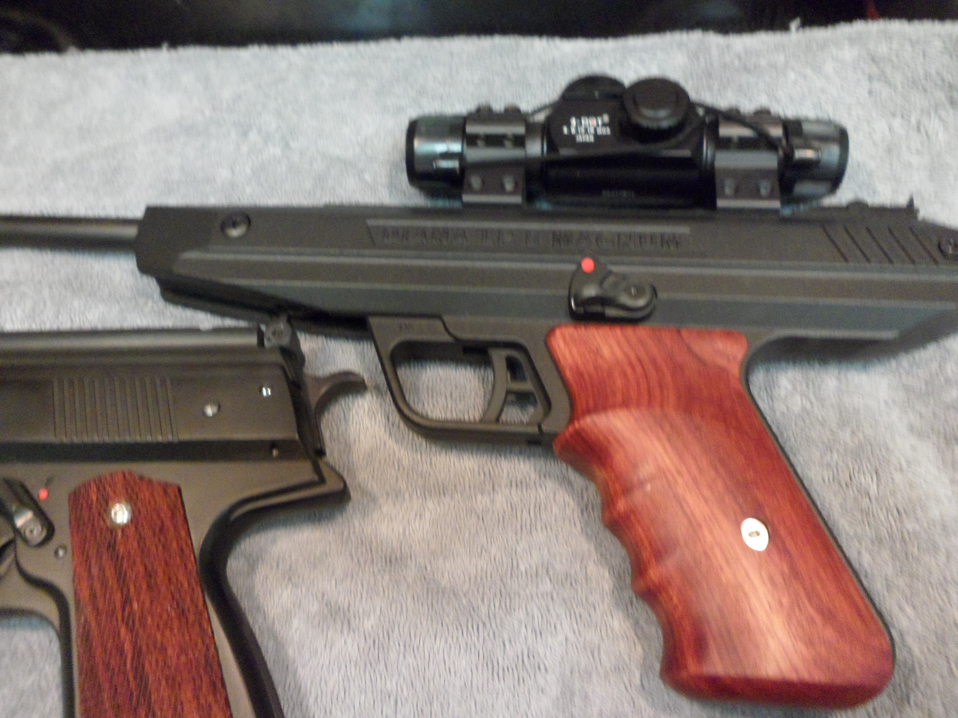

the LP8 biggest problems is the trigger, it has so much take up and no trigger stop
a trigger stop is very important in my eyes, it is better known as trigger over travel

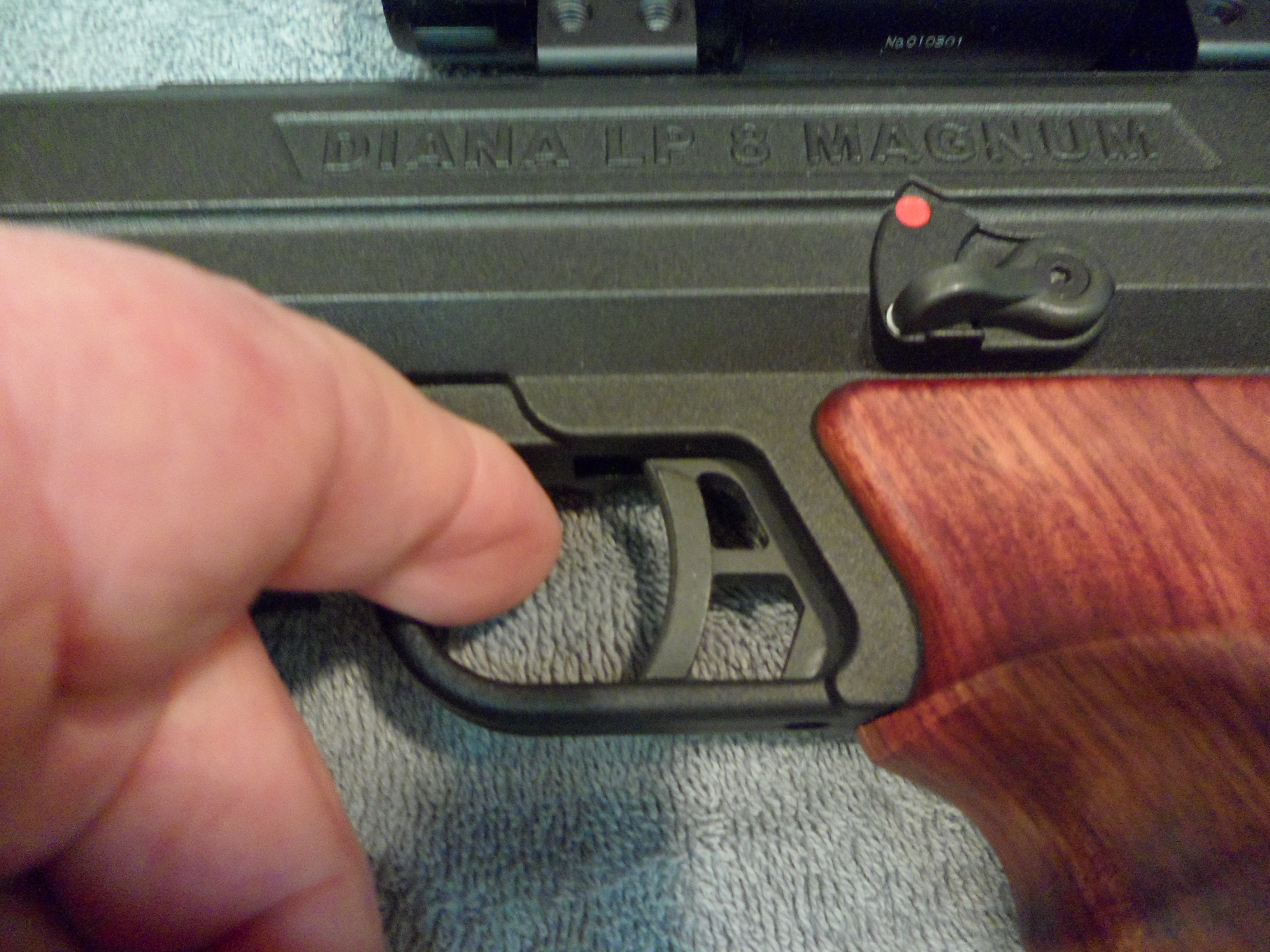

i completely reworked the trigger with longer adjustment screw, i overlaid the sear so the screw didn't to be so long in the trigger,
the grips are Galbraith Brothers no longer made
hope this helps you and yes i own a lot of pistols

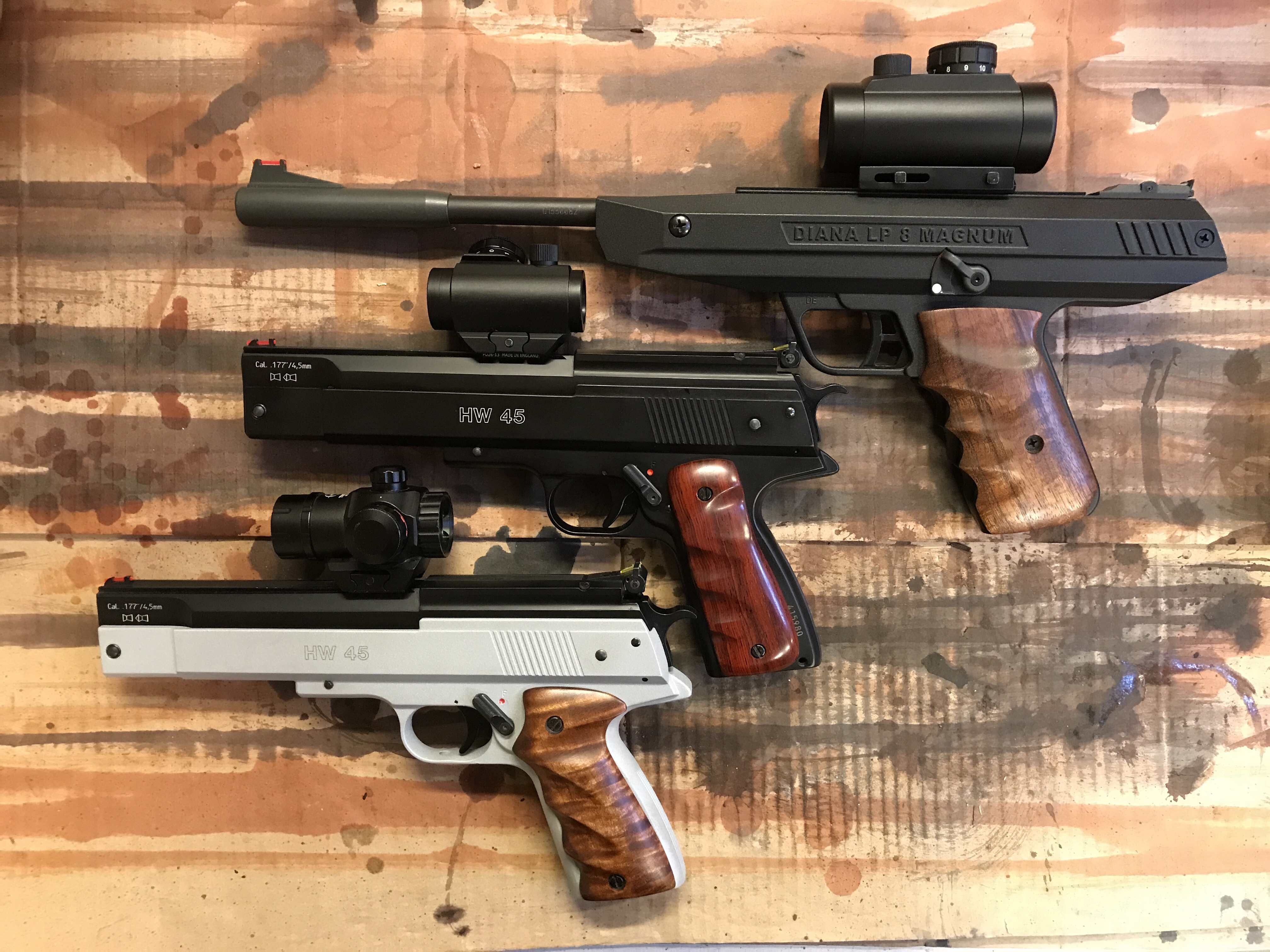

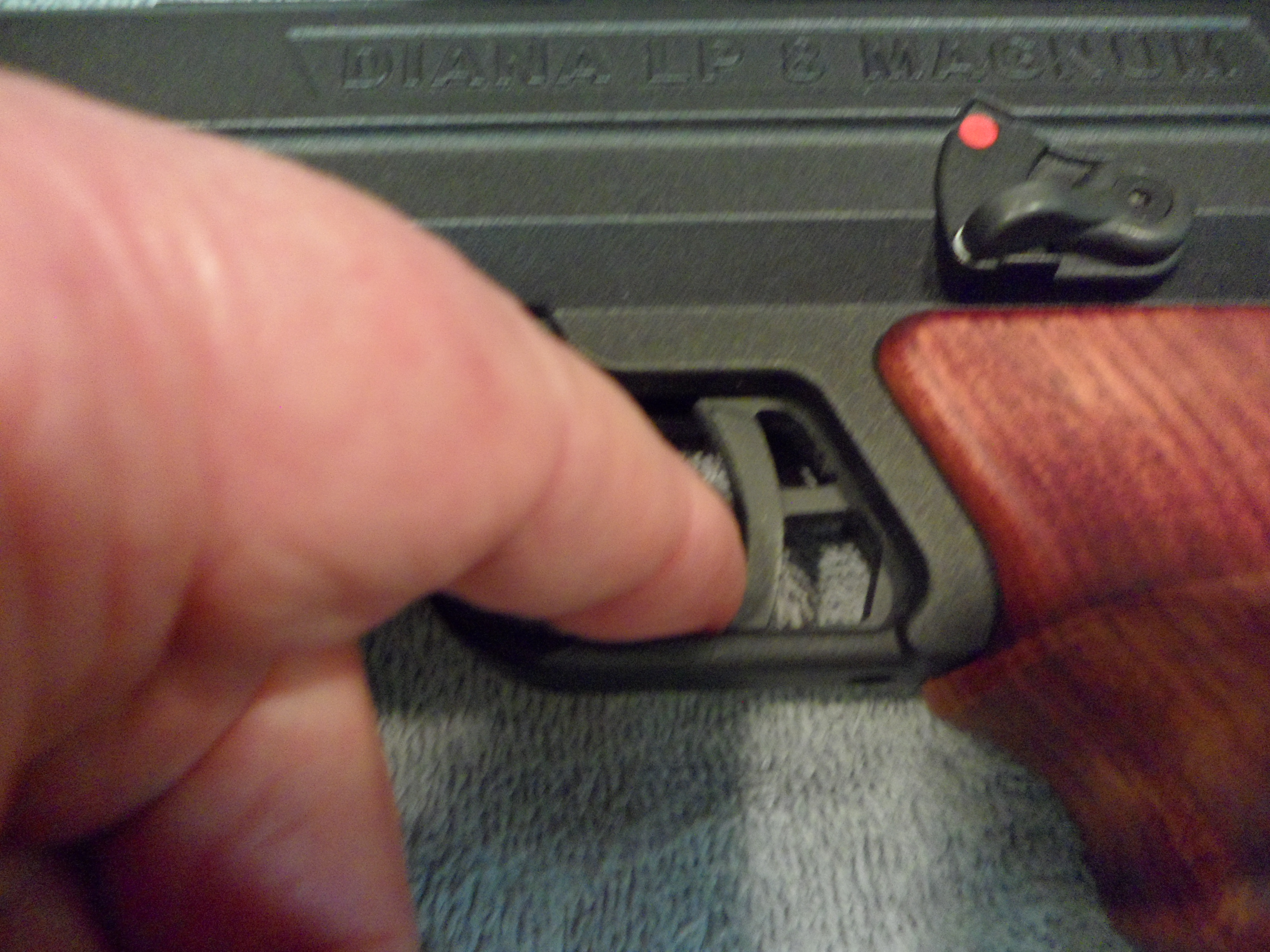

made a trigger stop, change both springs and in the picture i am showing you how much movement the trigger now has about 3.5mm
with the LP8 is a HW 45 and a Diana model 6 for size comparison
