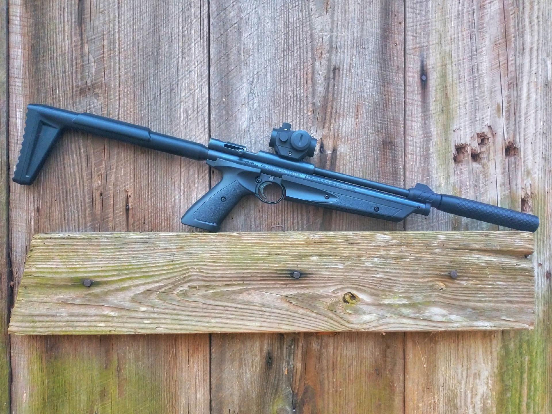

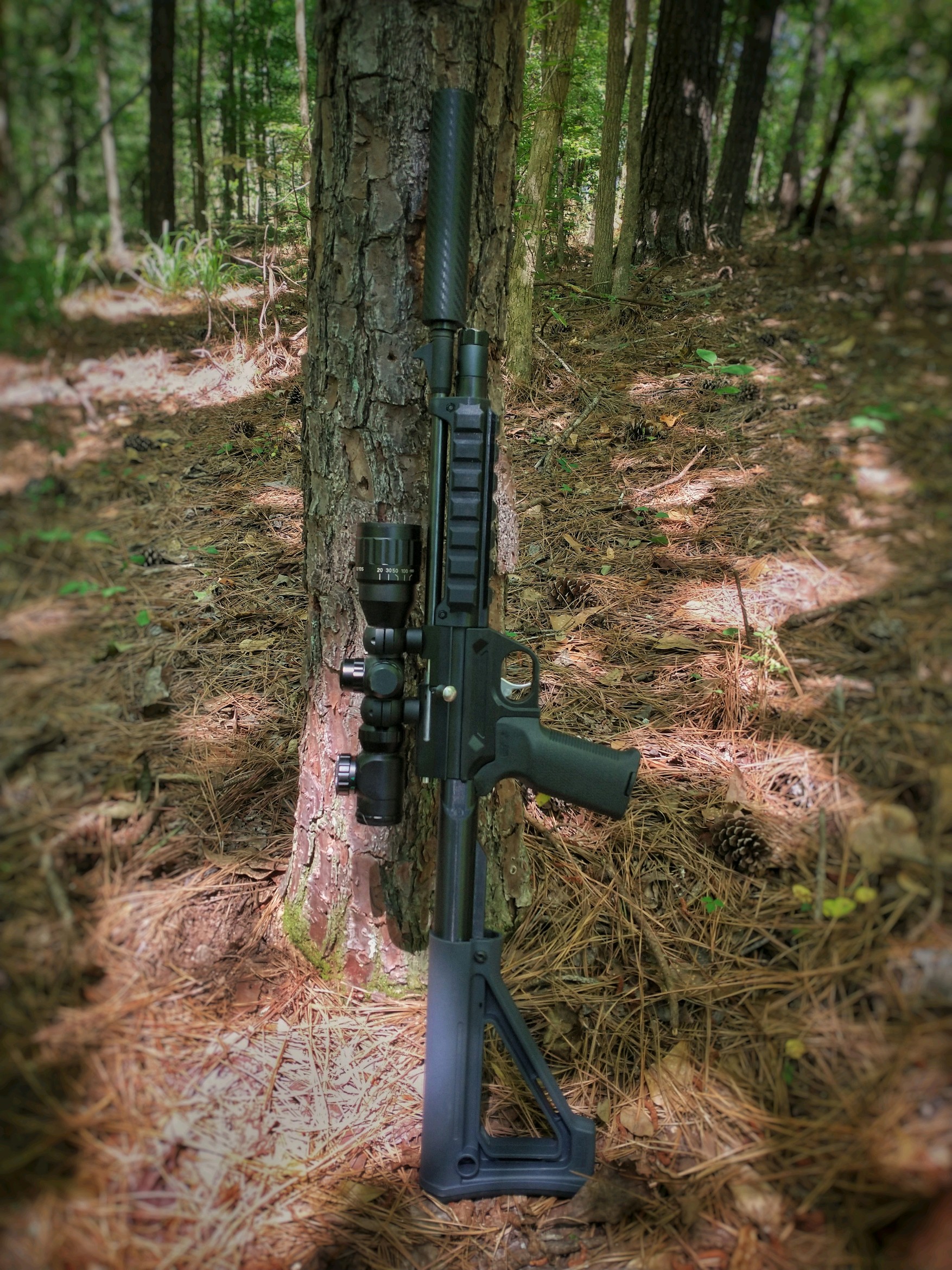

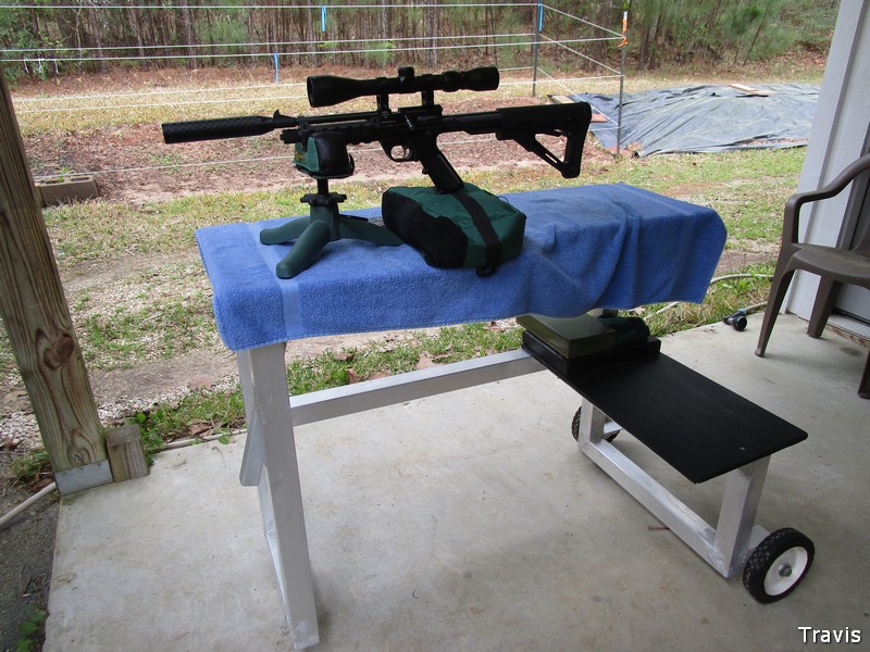

Hello everyone,
I just converted my Diana Chaser into a Full Buck-Rail AR conversion. I don’t think you should use the word “cute” in the same sentence when describing a gun, but fellows this little Carbine is cute! Not only is it cute but it is accurate as all get-out, ( see attached photos ). I have to say right now that I am so overly impressed with the quality of the Buck-Rail components, every little detail is so well done, this conversion went together so nicely. I ordered the AR Grip, Adjustable Stock, Tri-Rail and the Suppressor. The suppressor is so quite that I can here the trigger now when I fire the gun. First time to shoot it after the conversion with a pellet, I opened the door to my shop and fired it toward my 25-yard target and it was so quite that I thought I had installed something wrong. I loaded in another pellet and aimed it at six thicknesses of heavy cardboard and fired, well the pellet went through all six pieces of cardboard and into my plywood wall to where the skirt of the pellet was flush. Oooops!
Last night I ordered from Buck-Rail the Laser and the Red Dot Scope and if I do not like the Red Dot then I will order a Compact Scope.

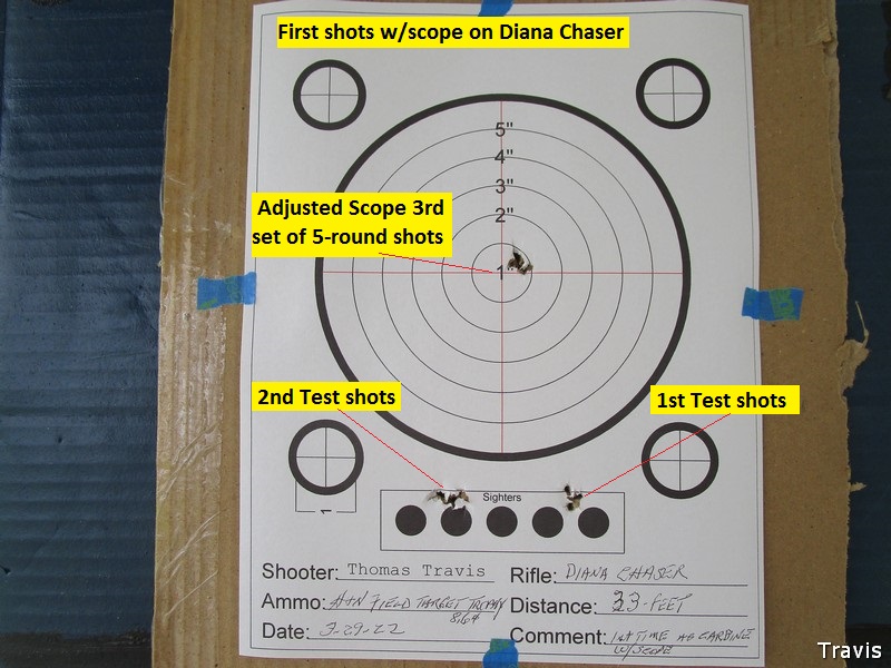

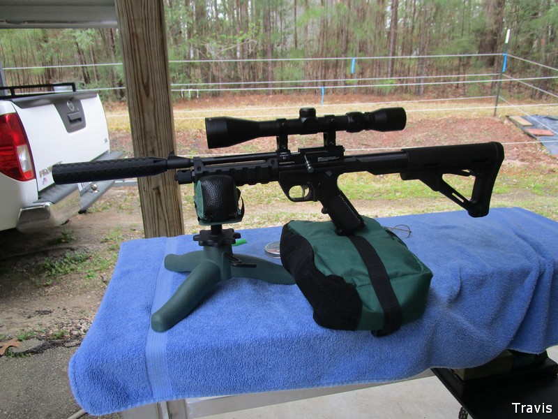

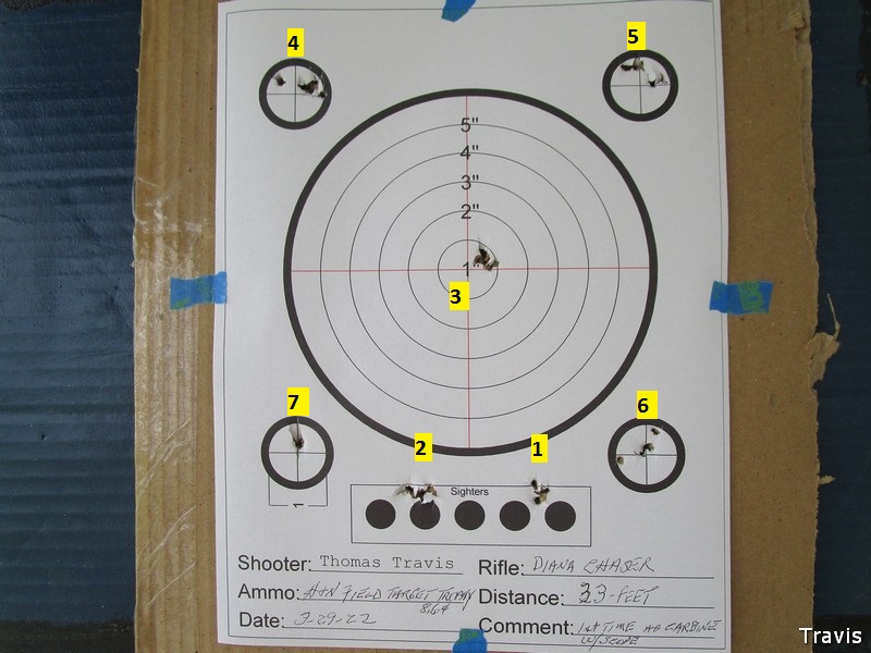

I had this 3-9x40 scope and only one set of rings that would fit the 11mm rail so I decided to mount them temporally and do a bit of target shooting today. The center ring on the Big target and the four outer rings are all 1-inch in diameter. The “Sighter Dots” at the bottom are 1/2-inch in diameter. To sight the scope in I shot 5-times on the right second in Dot, made some adjustments and shot 5-times at the left second in Dot. Then I shot 5-times at the center and made a few slight adjustments to the scope and mover up to the top left Circle. Tweaked the scope and moved over to the top right with 5-shots. No more adjustments and down to the bottom right circle with 3 in the dead center. And the last circle on the bottom left with
ALL 5 shots in one hole. This goes without saying, but I am one pleased shooter today. That is a total of 35-shots on this target set out at 10-meters (33-feet) using H&N Field Target Trophy 8.64gr pellets. This is about 37 to 39 shots total now fired on the 12g CO2 cartridge and that also pleases me.
