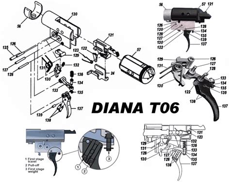

Looking for an assist. I have a Diana gas-piston rifle AMO3. Recently after cocking the rifle and closing the breach the rifle will discharge without a trigger press. Any guidance would be appreciated. I'm mechanically inclined and do maintenance on firearms, but never disassembled an air rifle. I think I paid $350 through Pyramid a few years back and do't know if it's worth sending off to get fixed.
Ya, trigger adjustment too fine and no shear engagement a good start ..
Also this spring could be broken
Part # 131

Gasram Dianas don't have T06 triggers, since the pistons are completely different between the rammers and the coilspringers (side-latching vs. latch rods), and so are the sears. Not much good have been said about the gasram triggers.
I thought it was the shear due to the piston . They do say there to6
https://www.airgunsofarizona.com/gas-ram-rifles/diana-am03-stealth-n-tec-combo/
high performance Diana N-TEC gas piston
The T06 all metal trigger unit is adjustable for crisp release and length of first stage travel.
Then I guess it's lies ? Ijdk..
Also there's a pa blog thing on that spring ,ram difference with the to6 used ..
