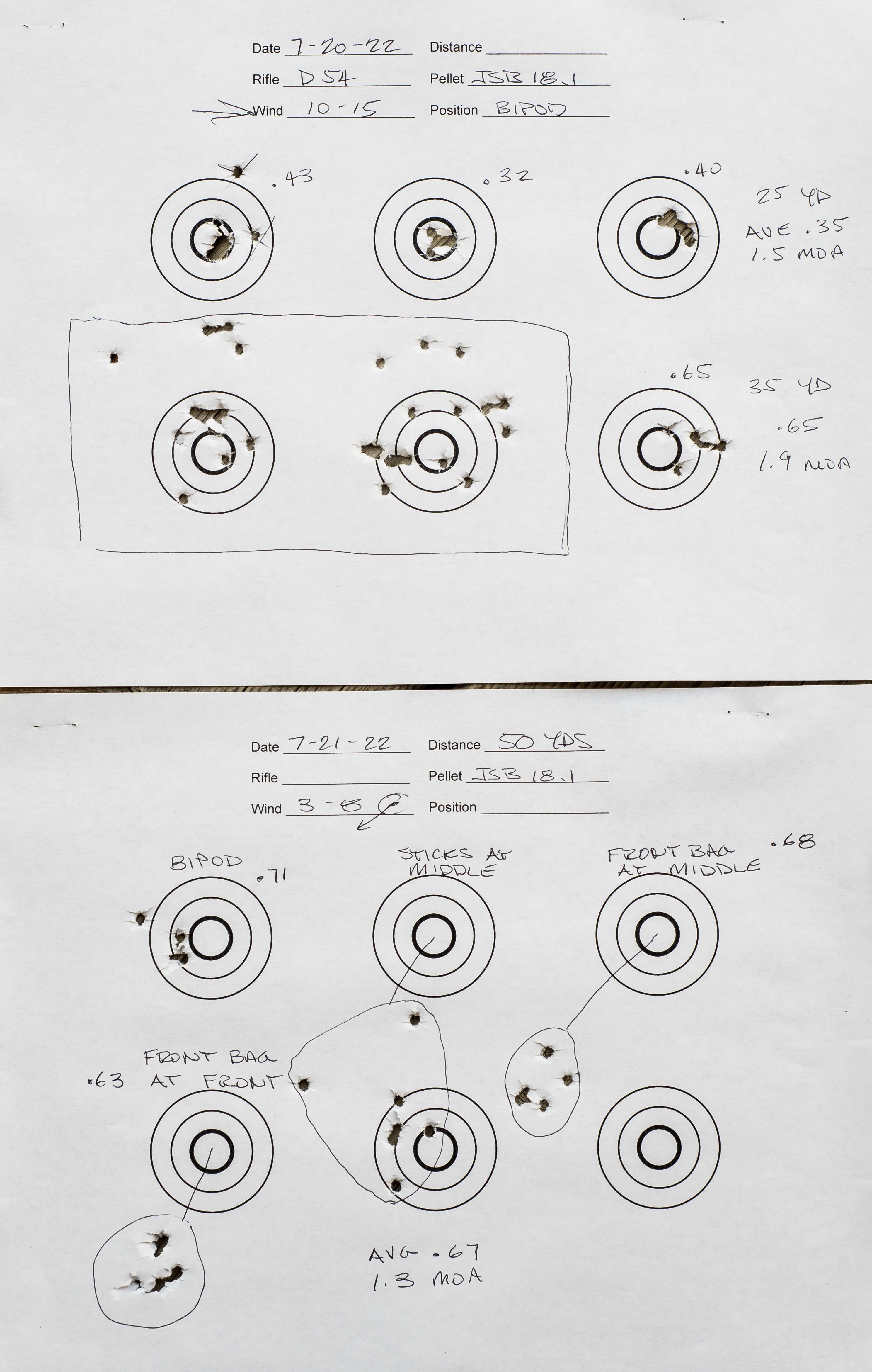

Here are a couple targets shot yesterday when wind was moderately high, and today under better wind conditions. The goal was to see how the AirKing would perform off a front mounted bipod. The top target was shot at 25 yards and 35 yards. The top left bull included a couple sighters. Groups at 25 yards were very tight with an average size of 1.5 MOA. When I switched to 35 yards, I noticed that POI was significantly higher off the bipod than I had been getting from either sticks or front bag. After rezeroing I was able to get one 35 yard group that measured 1.9 MOA including some horizontal spread from the wind.
With the wind lower this morning I moved to 50 yards, both to confirm accuracy off the bipod, and also to evaluate POI shifts from various supports. The scope was adjusted up 4 MOA to correct for the expected drop using yesterday's 35 yard zero. The first group was off the bipod and hit just a little left. Next I tried shooting off sticks with disastrous results. Not only was the POI much lower, but there were some major fliers. With practice I could probably eliminate those fliers, but shooting off sticks definitely presents a challenge. The upper right target was off a front bag, with the bag positioned in the middle of the stock, about the same location as the sticks. POI was lower and left of POI from the bipod, but another good group. Last, I moved the bag to the front of the stock, about where the bipod had been mounted. POI was still a little low, but less so than when the bag was positioned in the middle of the stock. Average from the 3 groups was only 1.3 MOA.
Conclusion? It is going to be either bipod or bench for this gun, and some rezeroing will be necessary when switching between the two,

Thanks for the link. Since 3/4" at 40 yards works out to 1.9 MOA, and I am getting average group sizes of 1.5 MOA or less, my rifle must be performing to expectations, right? As far as performance off a bipod is concerned, my rifle does very well, almost as well as from bags, and a better choice than sticks for a field posistion. So far my AirKing has proven to be very difficult to shoot off sticks, no less sensitive than a standard springer really. That kind of surprises me.

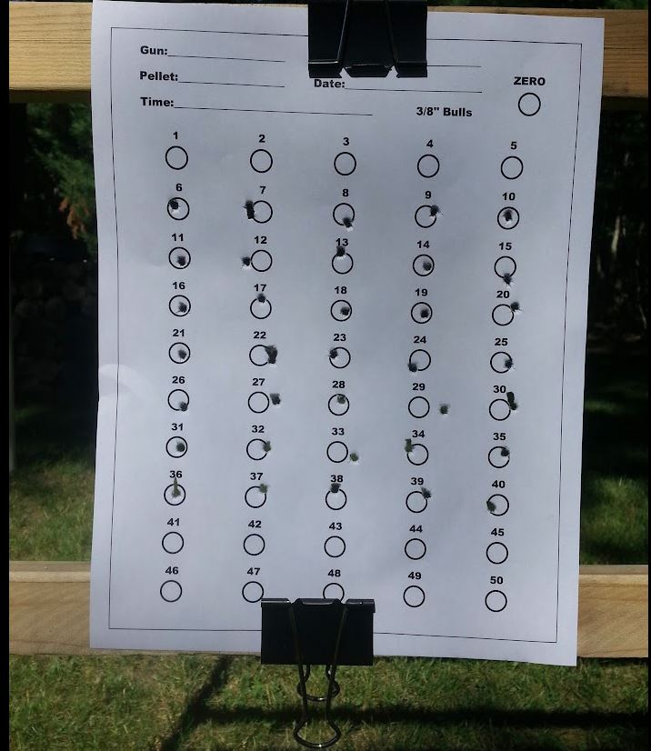

Str8shooter, looking good! Here is mine from today. A bit breezy and got harder to shoot around the wind as the morning progressed. Off a front bag today, good groups at first then started opening up. Not sure if it was the wind, the rifle or me. Need a calm day to find out. Average of five consecutive groups 1.6 MOA. BTW, I did try the JSB 15.9 pellets, but found mine in its current state of tune to do better with the 18.1 grainers.

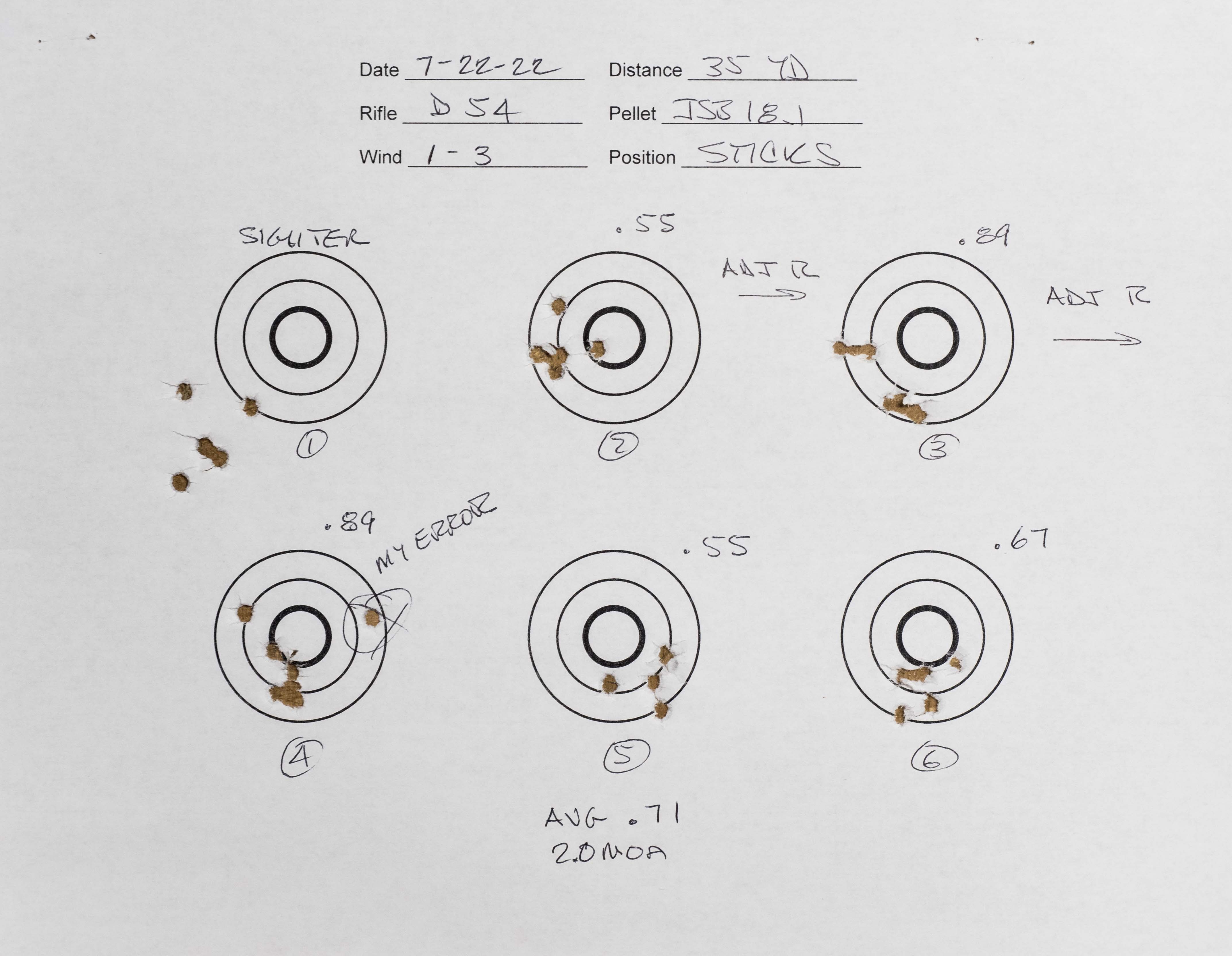

Here is some shooting off of sticks in calm conditions. I modified my position to be more like my position with a bipod, and it seems to be working. I know a lot of people like to see the tiny groups, but what I am looking for is every group under 2 MOA off of sticks. This is hard to do with a standard springer, and I am hoping I can get there with the AirKing.
