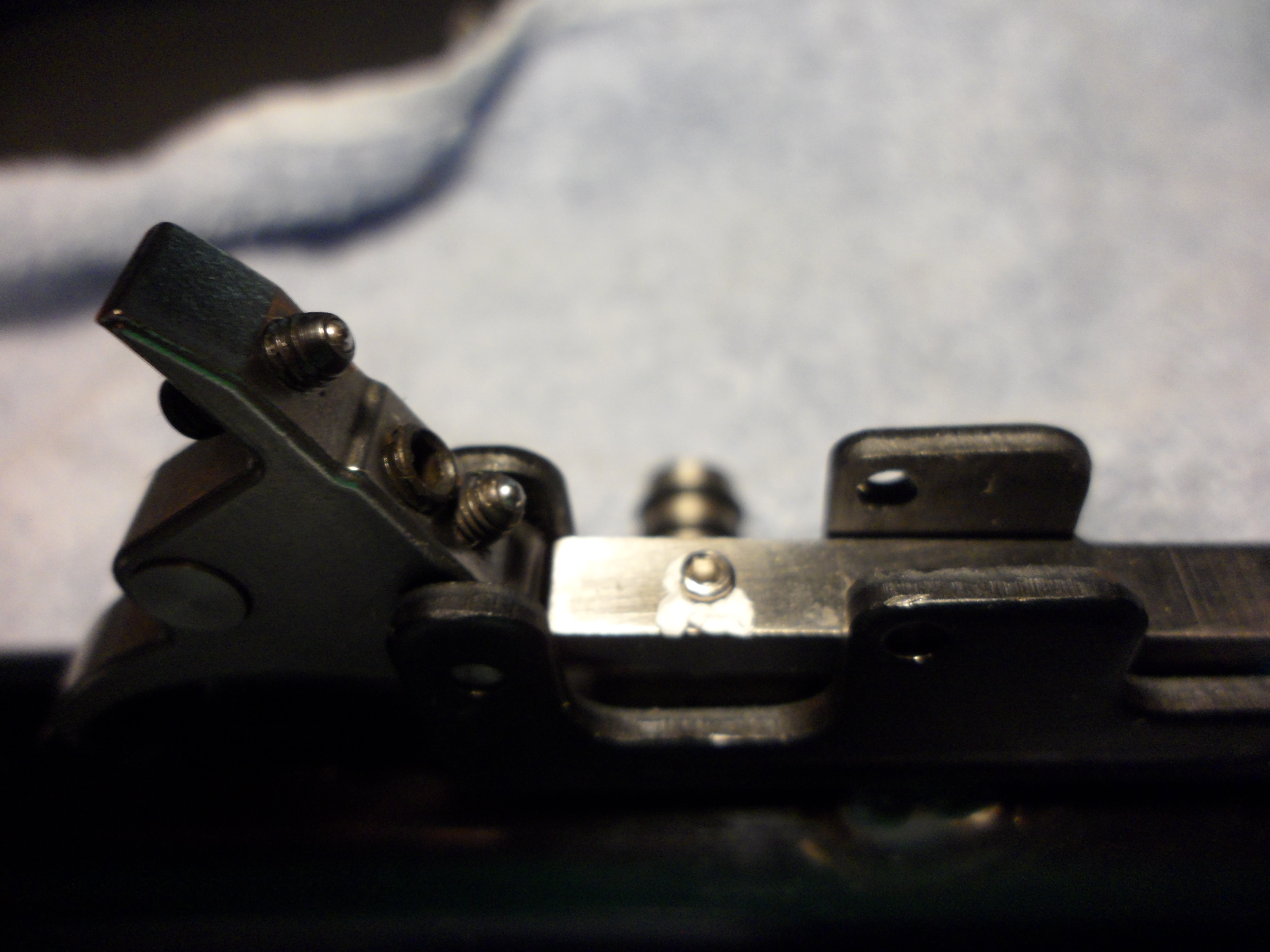

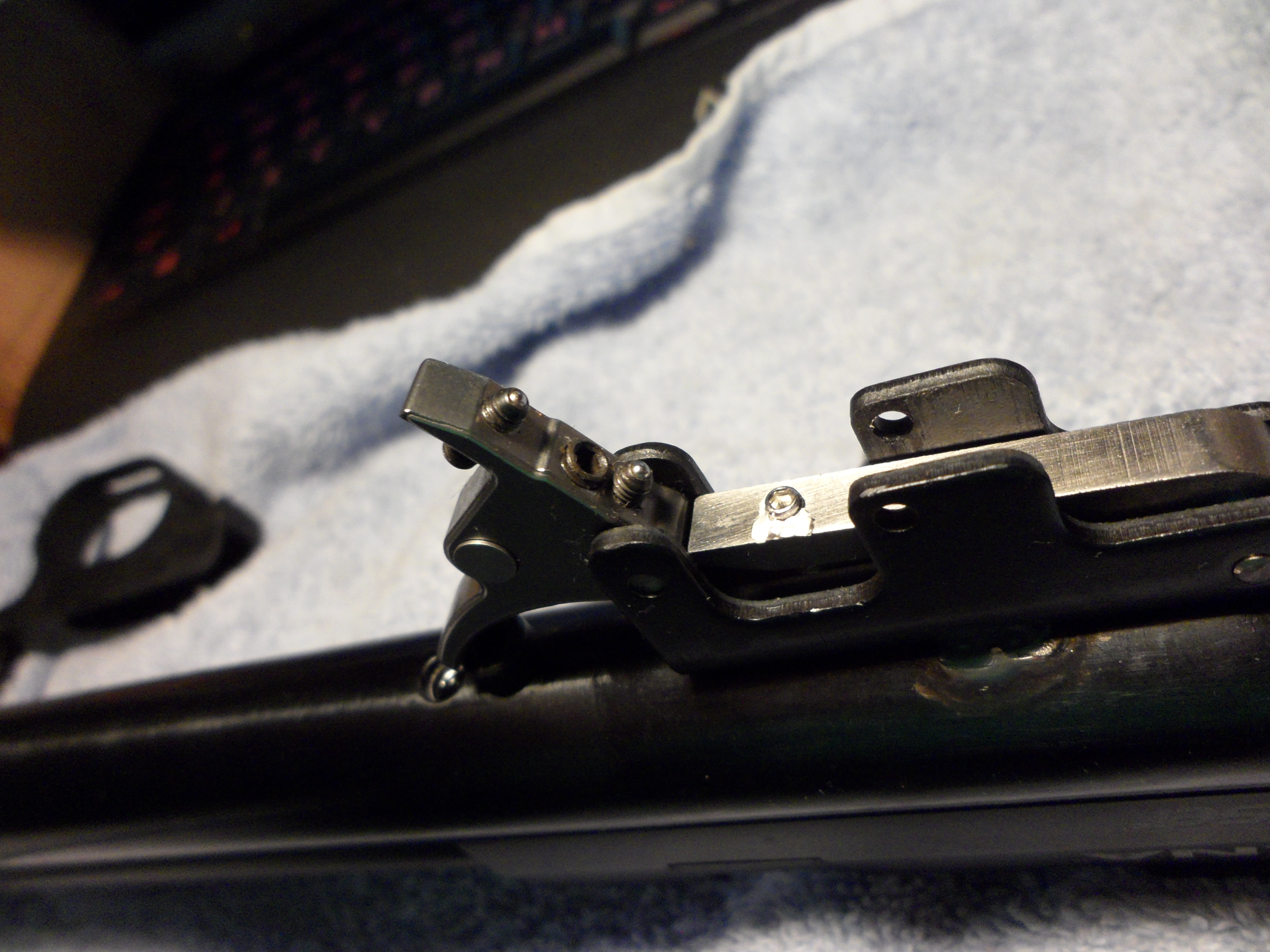

spend the time to take the grip frame off to see how the trigger works
you have one trigger adjustment screw that you can see in the trigger and that adjustment screw is too short but there is a second trigger adjustment screw that you cannot see and that adjustment screw does nothing unless you replace it
all trigger adjustments can be made with the grip frame off
the Airbug is a Chaser with a few changes
i have completely rebuilt my Chasers trigger assembles
Looking at your later post with pictures, a couple of those screws appear to have rounded bearing ends. What size and type screws are these?
I understand the screw that is accessable through the trigger guard is for sear engagement, what does that hidden screw do?

i used to epoxy bearing balls on the ends of the grub screws but bought these instead
i got some in 8mm and 10mm

the Diana model 5 and 6 pistols use a bearing ball and adjustable spring arrangement as part of the trigger adjustment
i saw these and said why not, a little pricey but who cares at this point
Reactions: maxtrouble
I was shooting it quite a bit this afternoon and the grub screw in the trigger was backing out, so I removed the stock and started playing with it. I put some blue loctite on it. I think I discovered that the hidden screw adjusts the first stage takeup.
when you said you bought 2-.25 cal kits, I hope you mean 2.5mm grub screws. I orderd a few lengths. To give me an idea what length do you recommend for those two screws.
Well I went ahead and picked up some ball end grub screws, really need some longer ones as the ones I got for the trigger are working but too short, so some more should be here in a day or two. I applied a home brew mix of synthetic gun grease with a touch of moly paste mixed in and applied to the sear and have gotten the trigger down to a nice 12 oz consistant pull. I pulled my Crosman 2300S out for comparison and really like the Airbug better, with the bolt handle on the left, and the loading port/tray completely open it loads much easier, plus no screw down there for the pellet to hang up on, just a better design. I think the trigger on the Airbug is better than those on the Crosman guns, even the 1701p trigger which I have in most of my guns. It's got me to thinking I may sometime in the not too distant future have to consider a Bandit and a hand pump,

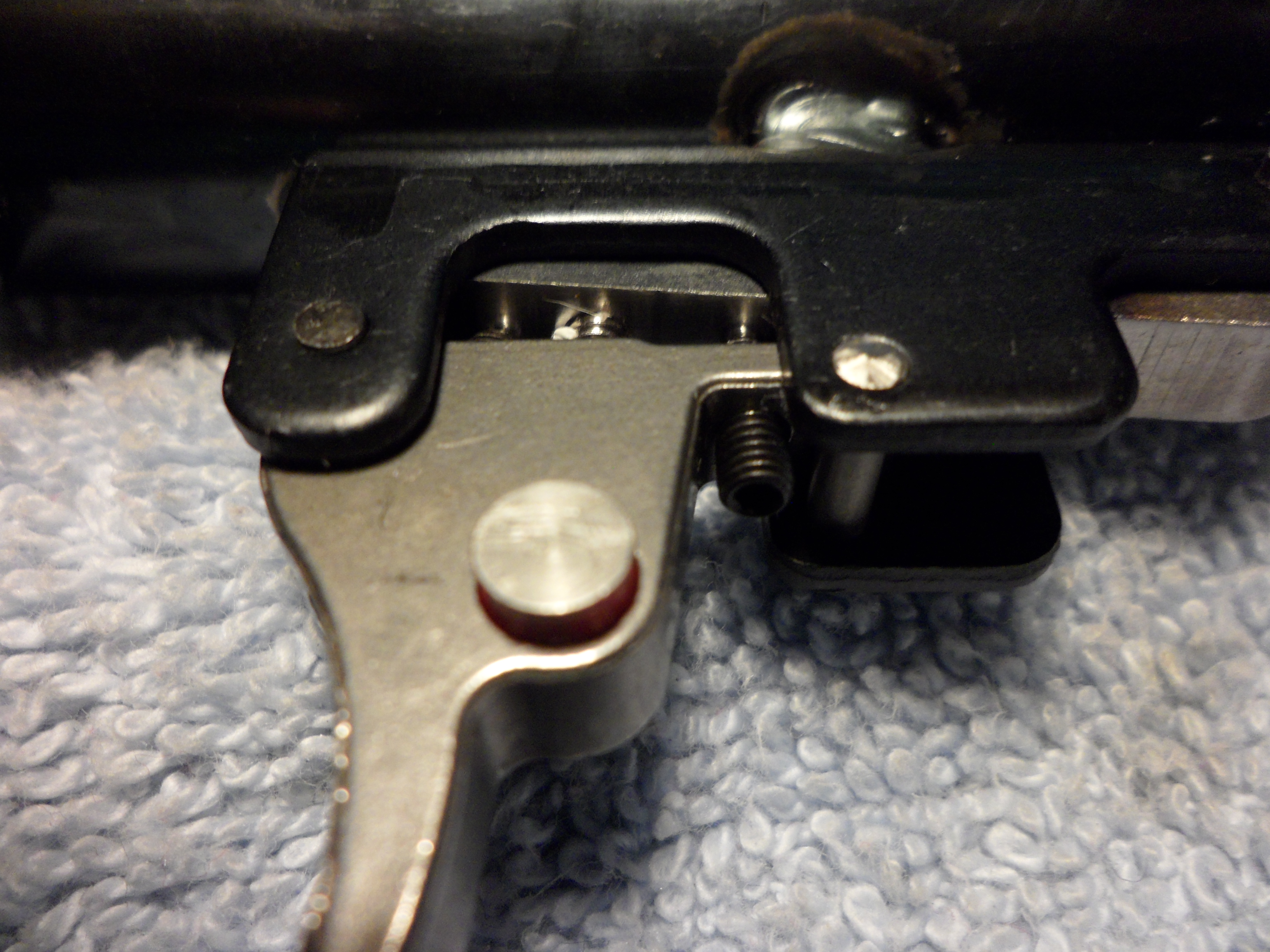

now the trigger i know it so well
i will tell you putting in the trigger stop in the sear will make you go way and why your finger is the thing that upsets the accuracy but when it stops moving it stops everything for that micro second
the sear is hard as hell and can't be drilled with softening it up
a 3mm grub screw installed between the 2 adjustment screws
you need a torch to turn that area red hot, you need an automatic center punch to mark the position and i hit it 6 to 10 times
i use a drill press with a 2mm carbide bit and then drill it out to 2.5mm and tap it with a 3mm x .50 tap
and that is a lot of stuff to drill one hole and i understand that
and then if done you sit at table and adjust that new screw
i have been using Teflon plumbers tape on the screws, why, it is easy
so why work on the trigger
i have a FWB model 90 and it has a Eletronic trigger and they are a touch trigger and i like a lot
so, that was my goal to get to that point of feel and my trigger has 1.5mm of movement , now i own 6 Chasers and all have been done and each takes about 2 hours to cut new pins, fit the shims in the sides and fit everything

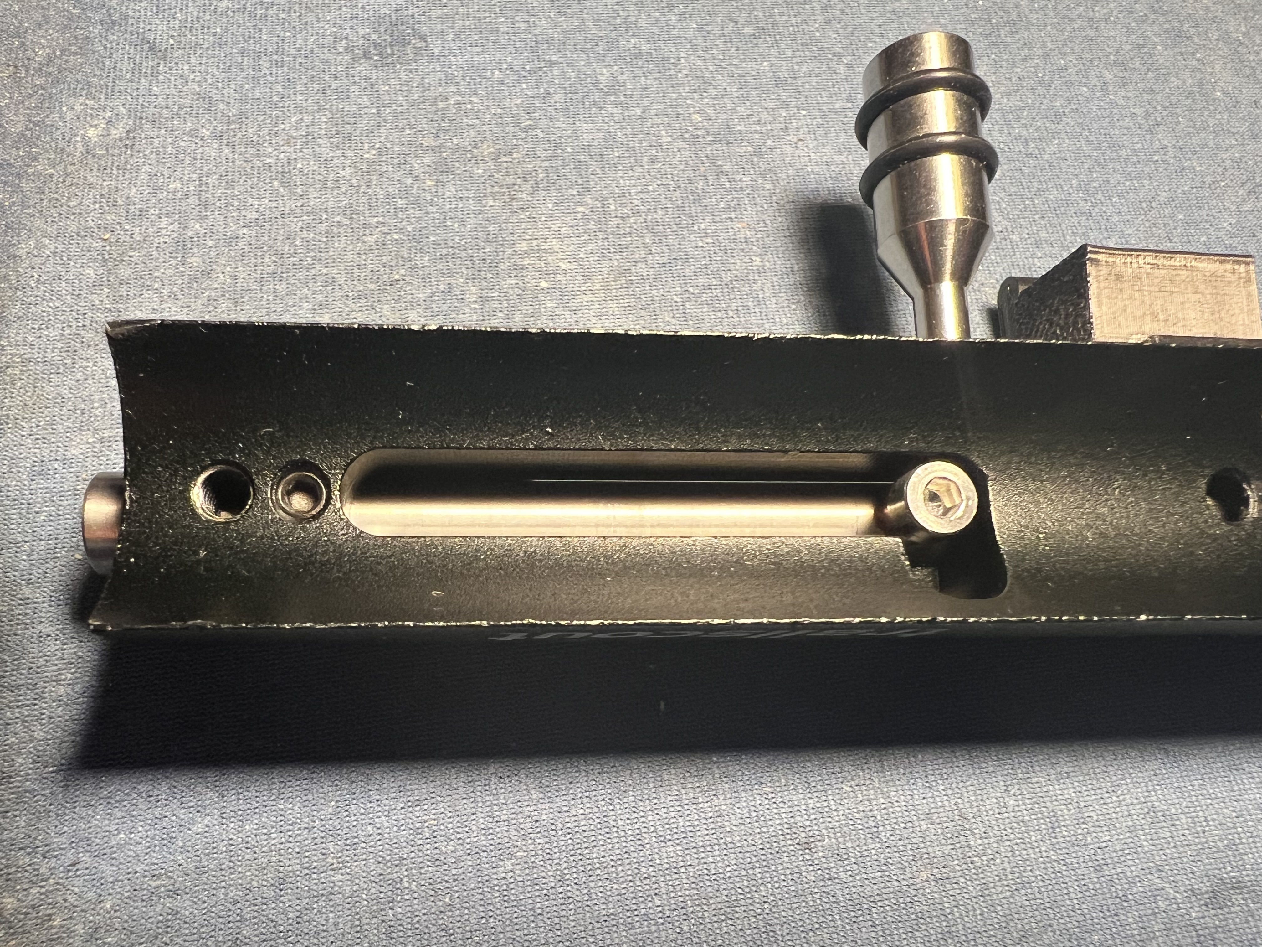

on the cocking
there is a 3mm grub screw that put pressure on the bolt in the rear of the breech
on some of mine i have put in white grease and a piece of felt and tighten the screw to get to right feel
i have also found that the bolts can be very loose and one would never know that they can be fixed

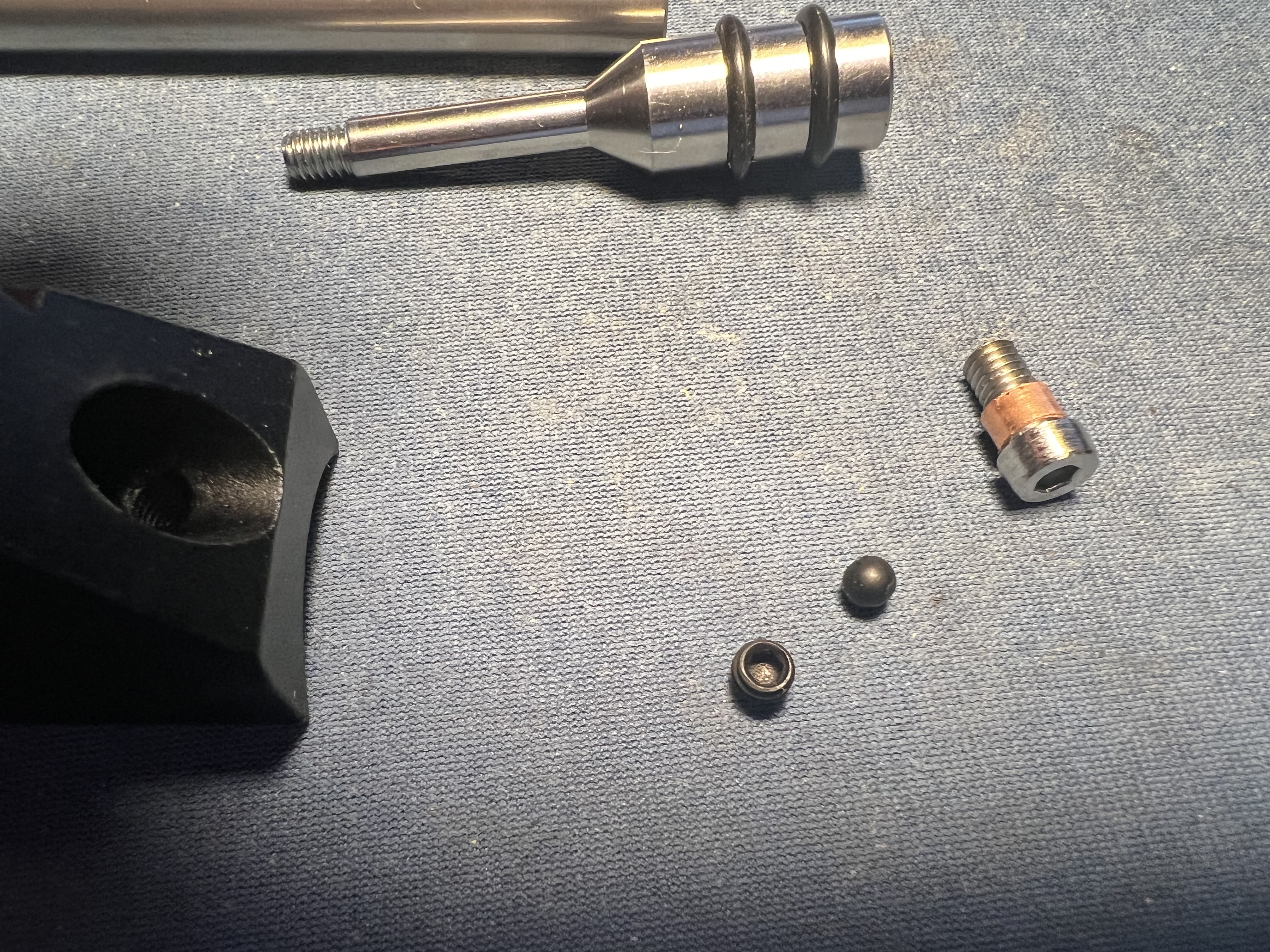

now this picture is of a Trailscout but the breeches are more or less the same
i did find one that had a screw but was blocked by what i thought was a ball but till tonight never really looked
so, here is the picture of the parts and there is a rubber ball the grub screw tightens against and not a drop of any lube present
that is all i have for you
take out the ball and add grease a piece of felt and add grub screw and adjust
on the cocking
take out the ball and add grease a piece of felt and add grub screw and adjust View attachment 462692
Thanks Mike for all that info. Re the Airbug vs Chaser cocking effort, it seems that the spring itself is much stronger in the Airbug. I don't think that the 3mm grub and ball has anything to do with it, as both bolts move smoothly back/forth otherwise. It's only the increased cocking effort that is noticeable in the Airbug. If one didn't HAVE both pistols, this is something you wouldn't notice. Just for kicks, when I have some time, I'll run them over the chrono just to check if the Bug does shoot harder. Like you said though, who really cares? It is just a curiosity for me is all...
