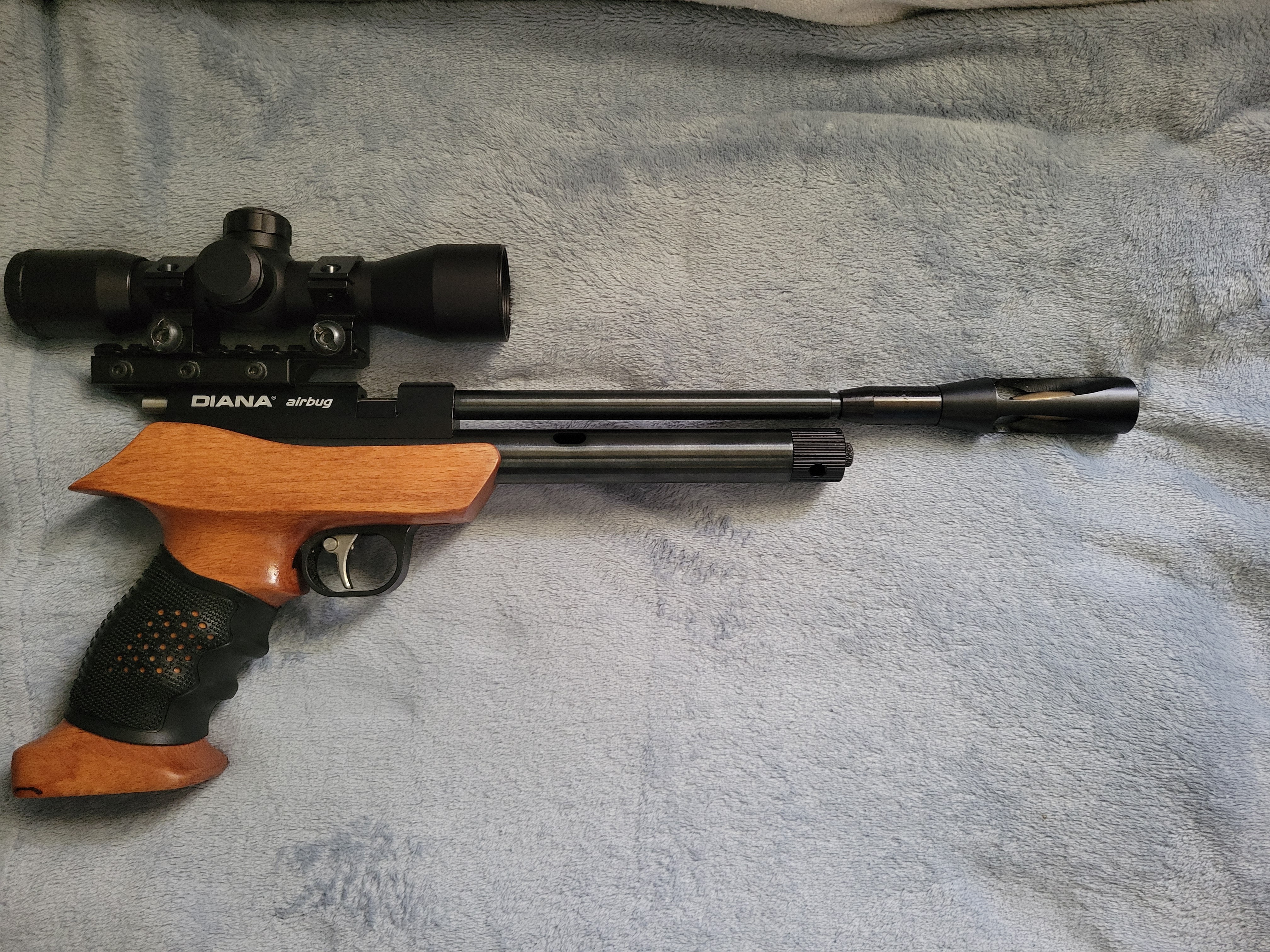

Diana Diana AirBug Muzzle Protector Removal
Does anyone know for certain how to remove the AirBug's muzzle device? Is the Airbug's barrel threaded like the Chaser? If threaded, is it RED loctited on there like the Chaser's moderator? If it is possible, I would like to use a Diana moderator (same unit the Chaser "factory" rifle barrel has) on the Airbug pistol.

Airbug and Chaser barrels are the same the Bandit barrel is also the same but 1.2 inches longer for the HPA tank
so you can use a silencer on the Airbug barrel with its 10mm-1 thread or get an adapter to use 1/2-20 threaded units
i use these very inexpensive adapters
