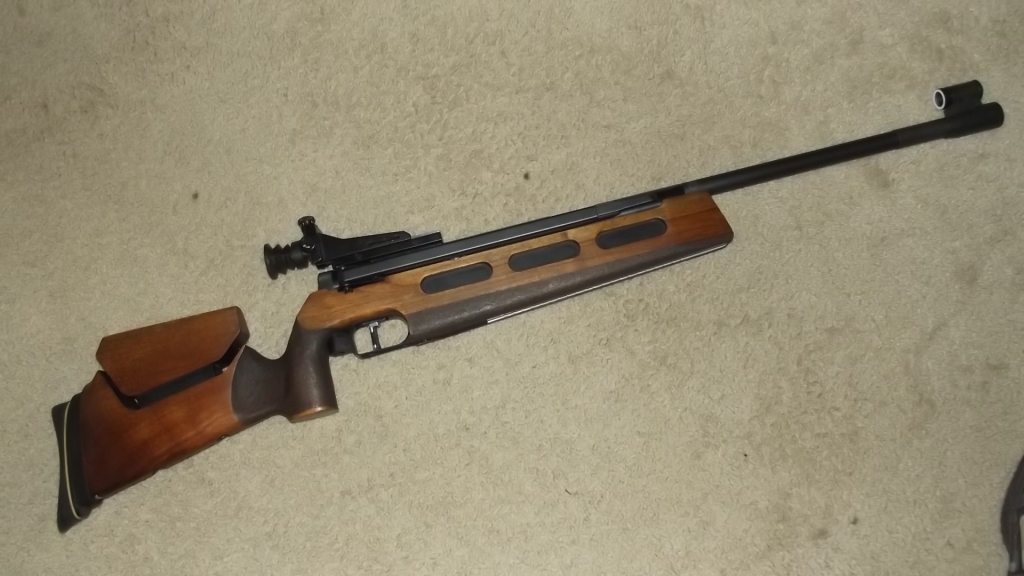

I just picked up a very nice Diana 75 [actually it is a Beeman 400]. The seller's kid used it for competition. It came with what seems to be the original sights, including some sort of alternative front sight inserts; I don't know how those work. I shot it today indoors at a 50' range. It shot well but I am an old duffer and just can't see that well. I could make out the black but it wasn't fun. So I will put a scope on it. Any suggestions what mounts to use? Is it best to use a drooper mount or mount the rings directly to the rifle?

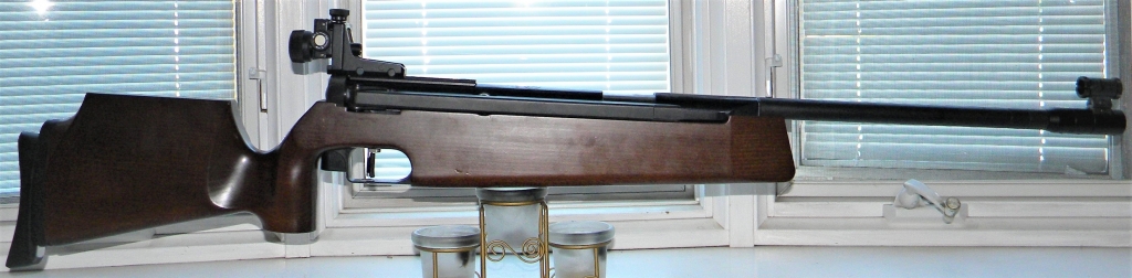

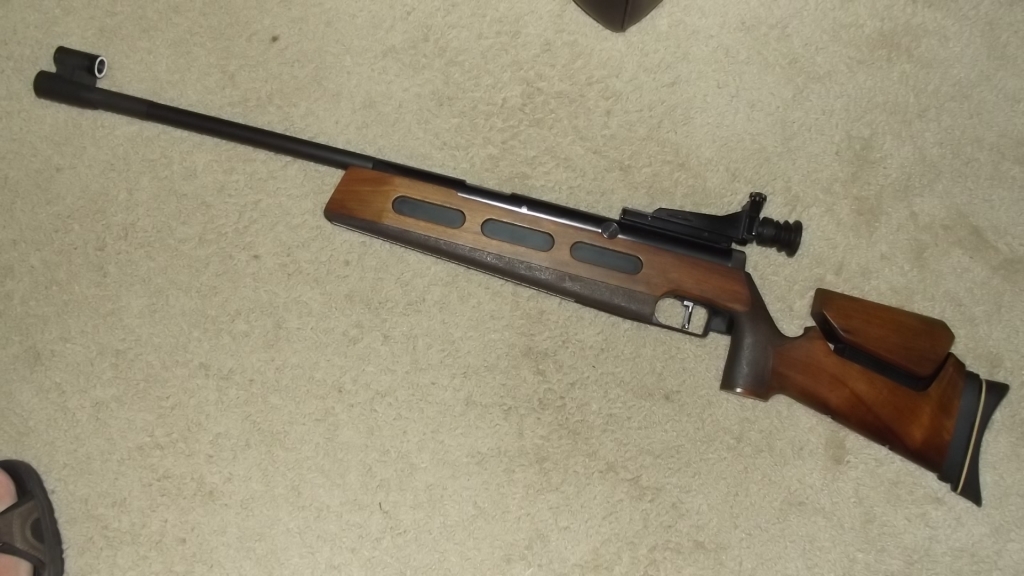

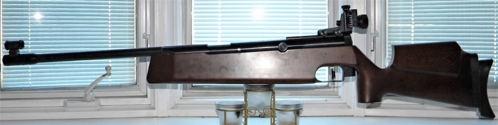

the Beeman 400 is an early Model 75, with the later being a model 75 TO1
the front sight was very different on the 400's and early 75's, they used clear inserts with holder, though I have never had one in hand

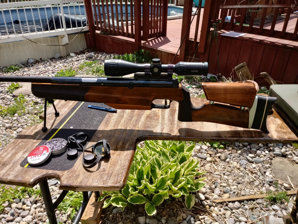

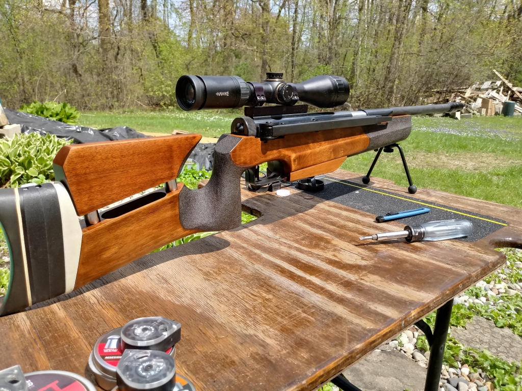

The picatinny adapter mount arrived today. I thought I would be clever and use one of the several Leupold VX2 3-9 scopes I have on hunting rifles. It didn't focus close enough for our 50' indoor range. I pulled a Hawke 4-12 x 50 Airmax off of a Huntsman Regal XL. That did the trick and works well. Preliminary results show a marked preference for JSB over Crossman pellets, but further testing with different brands and weights need to be done.
it is a sweet rifle and sweeter still now that I can see clearly. Thanks for all the tips. Now I have to buy another scope for the Regal. Jeesh, doesn't even end?
