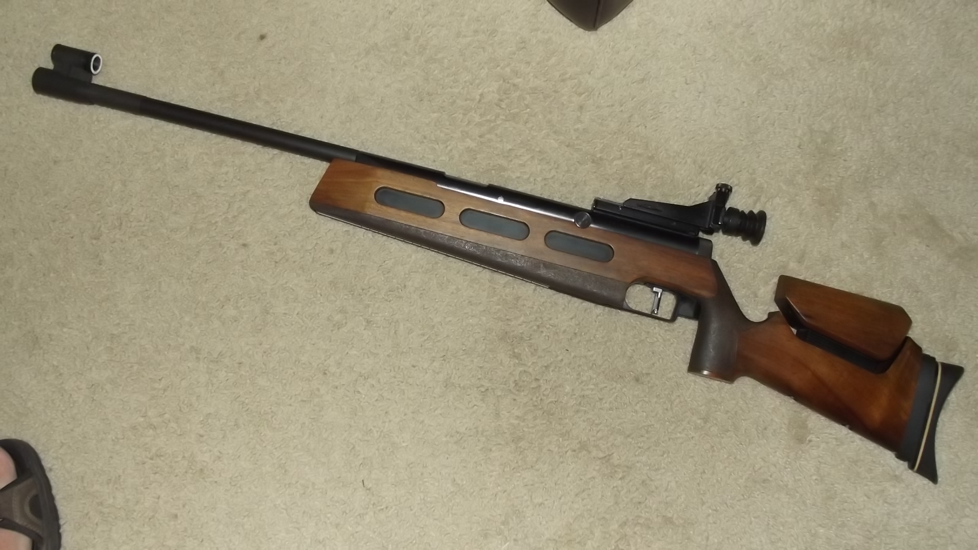

N/A Diana 75 front sight

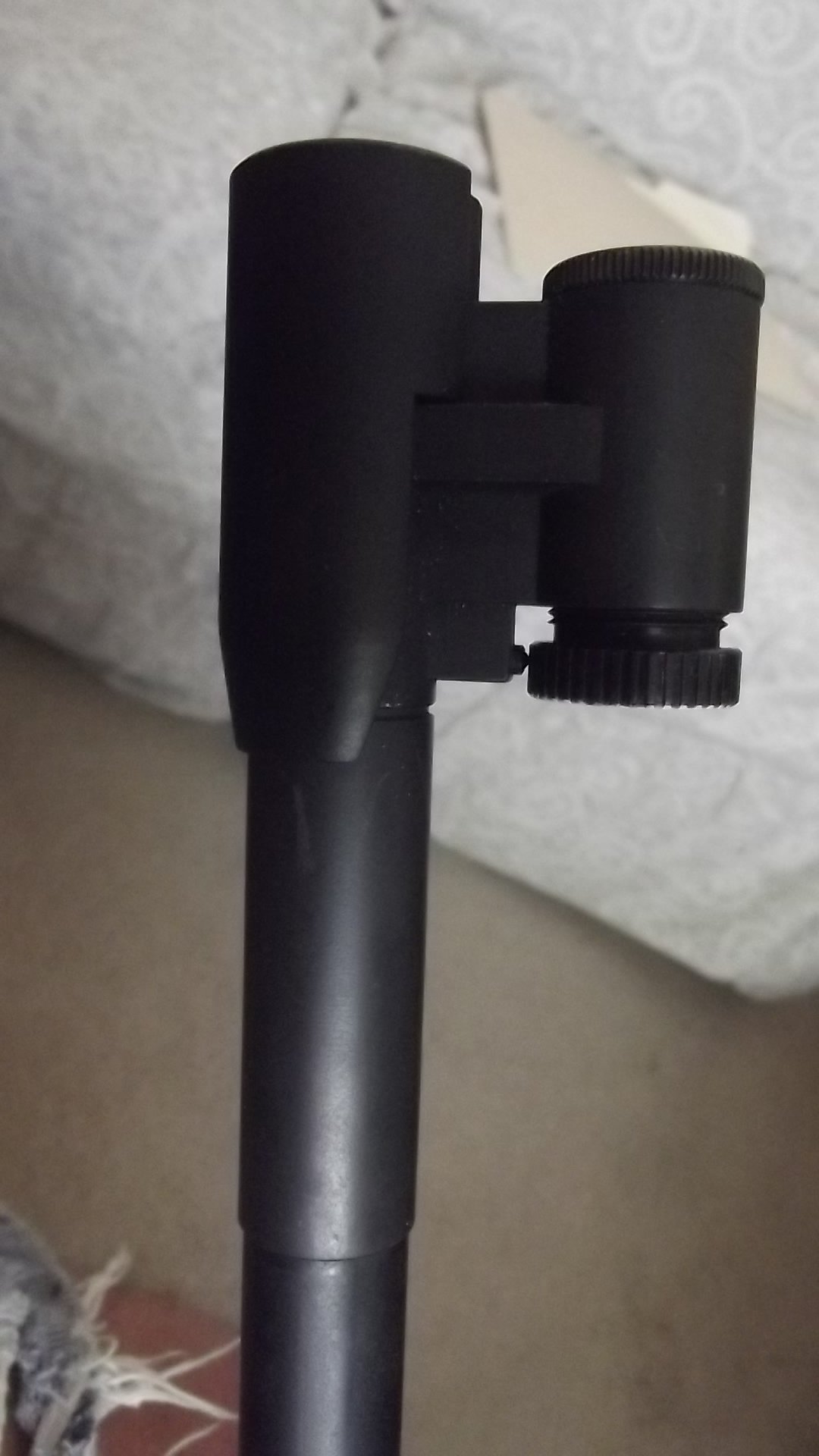

They made 2 heights ... most had the LOW, where as the "HV" version came with both Low and High "FRONT" having the rear sight using a RISER rail when used with a high front.
If mismatched Low / High indeed your sighting plane would not be correct.
This shown is a "HIGH" front ( My 75HV )
The HV with the riser rail on rear to be used with a high front.
