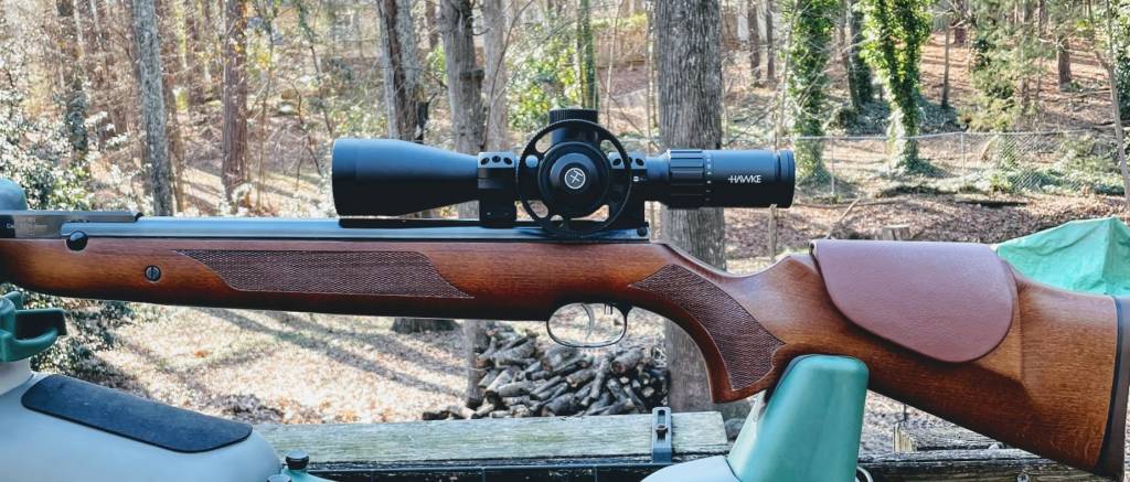

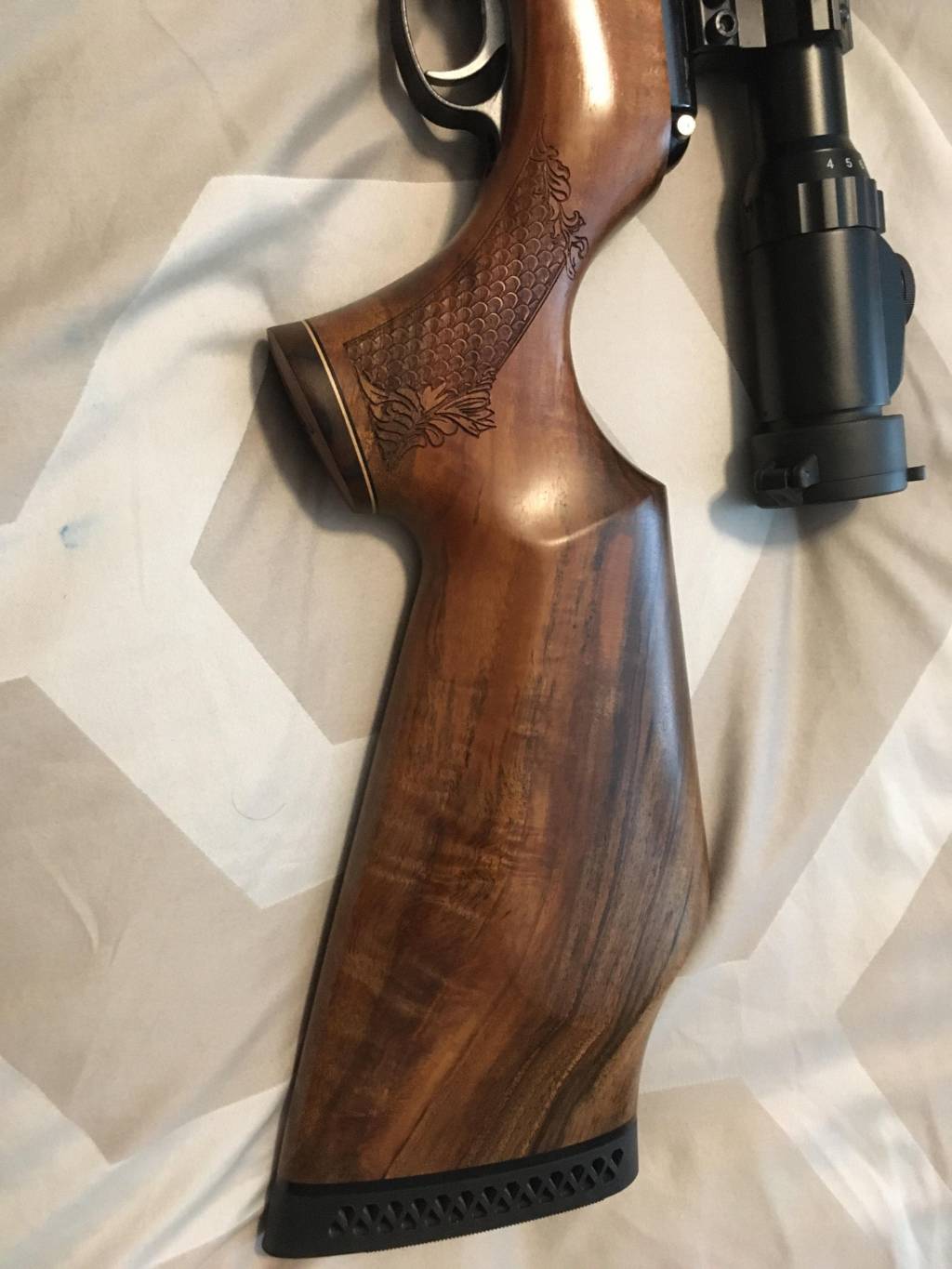

To answer your question there is not much point putting anything on a spray lacquer finish. About half have a stain mixed into the lacquer to give the gunstocks uniformity. They don't want people squabbling over light/dark etc. I believe all the Diana guns like the 52 are spray lacquered beech. It is a pleasant very durable wood and finish but not a showpiece like the ground up completely refinished walnut ones shown many of which are decades old. Those don’t have anything to do with your question and you wouldn't waste your time refinishing a beech stock.
Wipe it down with a T shirt every once in awhile. Put a tiny bit of oil of your choice on the shirt if you want. Nothing is going to penetrate that lacquer finish so forget the expensive magic oils. Anything you put on it is just going to sit on top. Don't put any wax on. It makes matching a touch up a great deal more dificult. Just shoot the gun.
Having done woodworking most of my life and have refinished more gun stocks than I can remember I assure you that this is the best answer on this thread
Nice. I should have posed the question that you just answered concerning lacquer. I waxed it with TreWax and it looks nice. Too late to NOT wax it.
Thank You
The wax can probably be removed with some sort of non solvent soap based cleaner.
Pledge will keep things looking nice and not significantly build up on the surface. It can be easily removed with a mild vinegar solution if you want to do some touch up. Lacquer is not a touch up friendly finish though.
