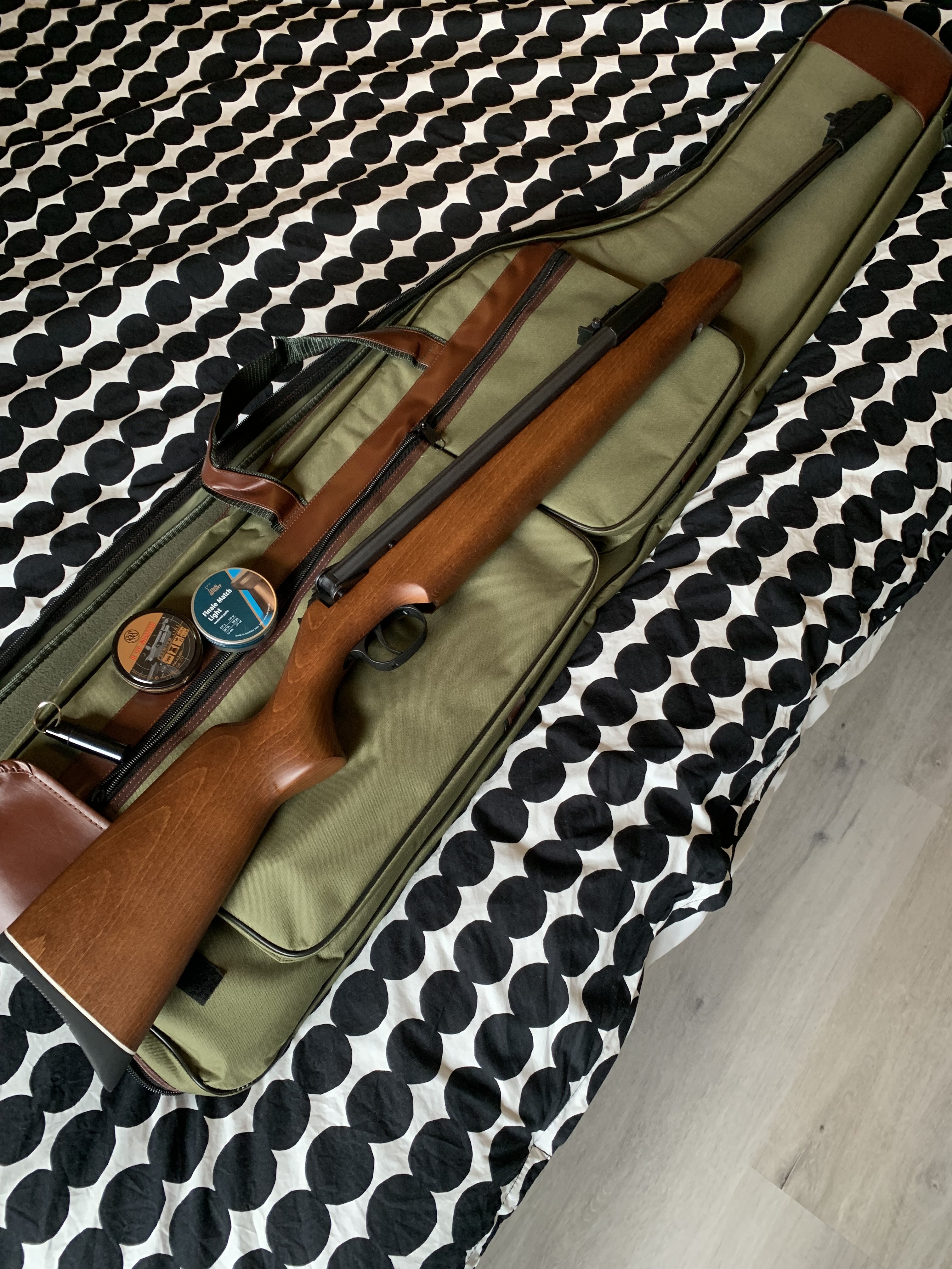

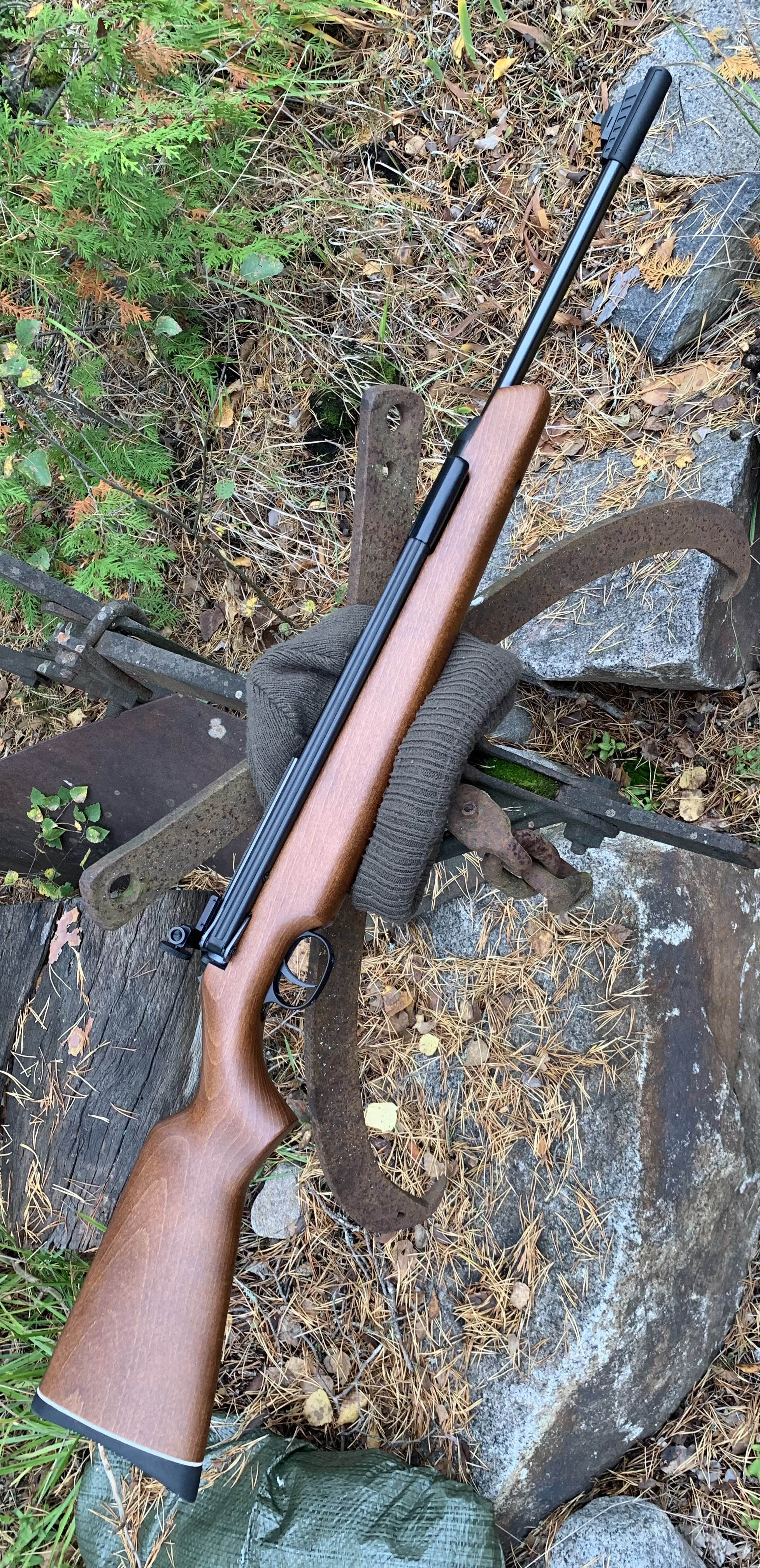

This is my Diana 48 that I bought last fall. I’ve shot a few thousand pellets through it at this point. It’s certainly a quality piece, even if I’m not as accurate as others in this forum.

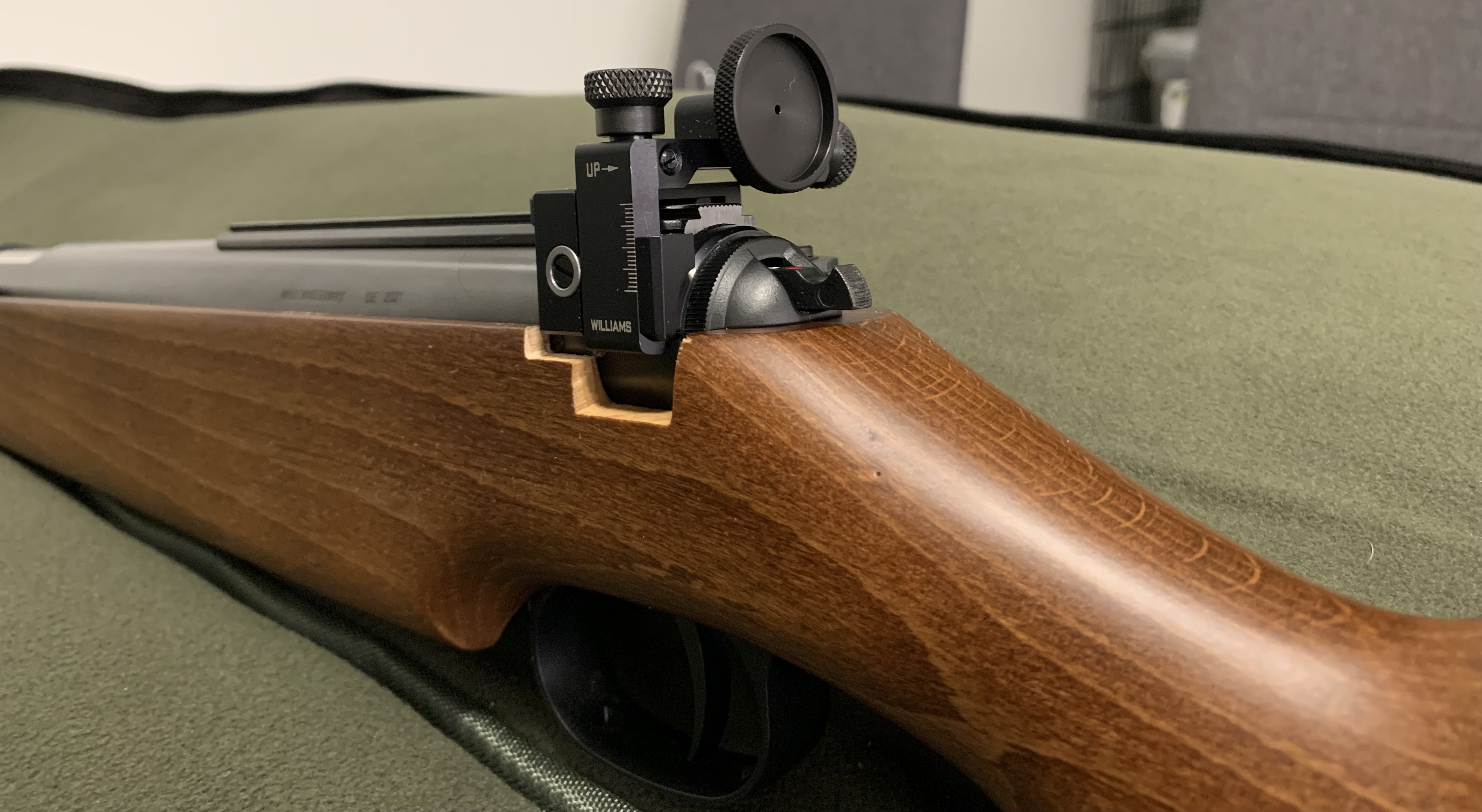

That said, I like to tinker… First thing I did was fit a Williams target peep sight. Had to make a small cut in the stock, but the sight picture was so worth it! Still needs some stain though.
Next, I noticed some pellets had fallen from the breech and damaged the breech seal. The gun was blowing gas and pellets all over the place. So I sat on my hands for a few months while a set of vortex seals and a Tinbum maxi kit came in.
Once I got those put in it, the shot cycled turned from sprrrrrrroiiiiiinnnngggggg to a nice sharp crack. That combined with some JSB Exact Heavies and Monsters, I’m feeling hopeful for the future with this fräuline.

Nice rifle. I have a few suggestions and these are my personal preferences, so please disregard if
it's not applicable. You modify your rifle to suit your taste.
First, on the cut out I would break those sharp corners, either chamfer or radius before staining.
Second, I think blued steel or blacked aluminum would look better than brass for the replacement of the plastic pieces.
I've never liked brass on air rifles for anything. I know some people do and that's fine. To my eyes it doesn't look right, but that's my opinion, and you know what they say about that.lol.
Either way it's a nice german rifle and a hammer shooting those heavies, so have fun and enjoy.✌🏻

I like the idea of rounding those edges. When I get home I’ll give it the good old college try. Worst case scenario, I end up buying a figured walnut stock to replace this factory beech log.

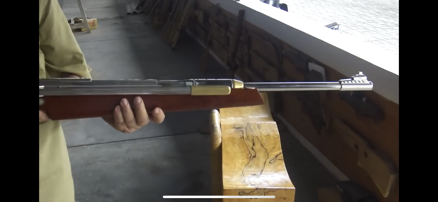

Now about the brass bits, I can’t claim to be original. I saw this and fell in love. Of course on this example, the steel is white and so is the front sight base.

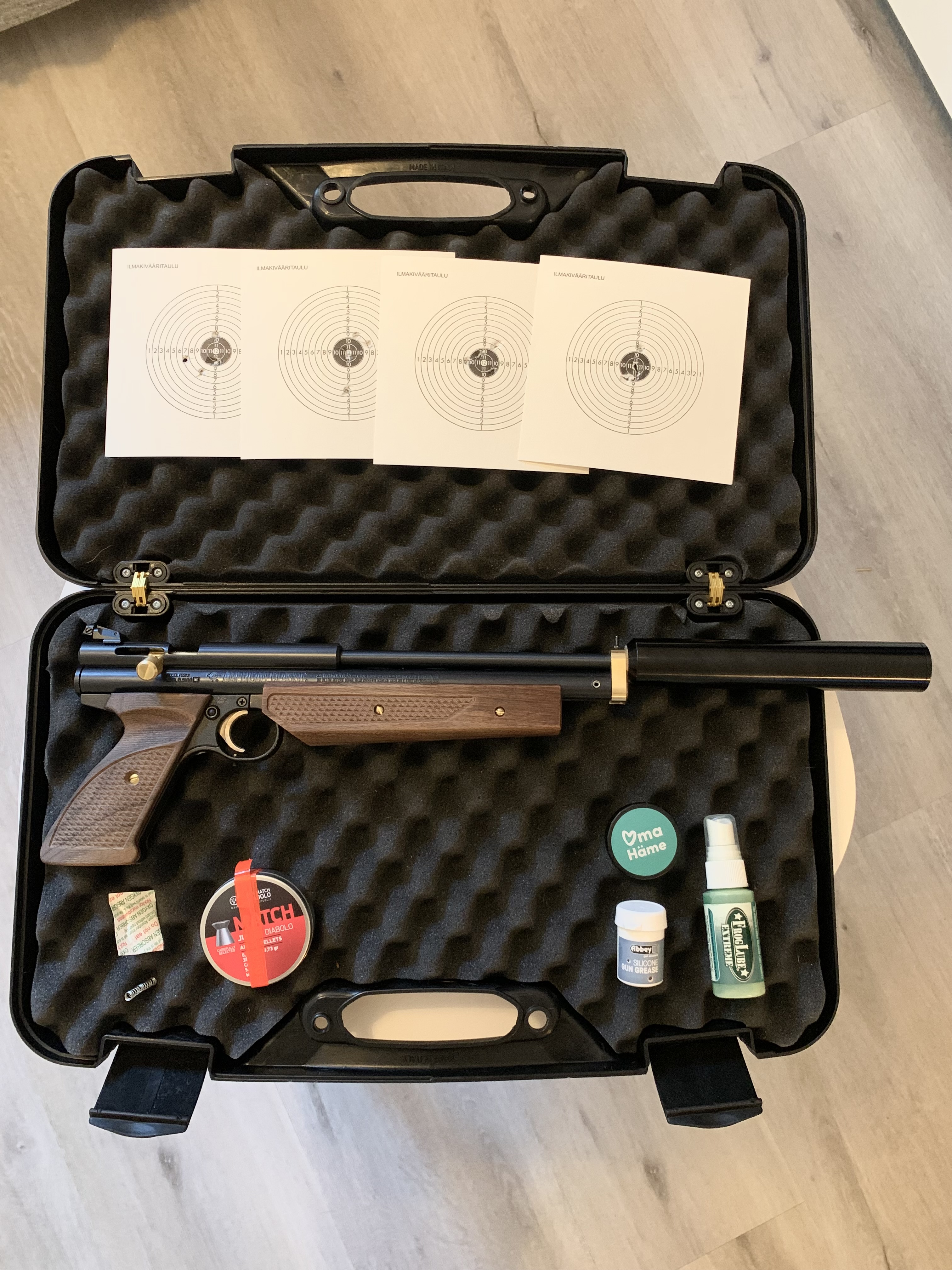

But I do have this Crosman… and making them into a set sounds very appealing.
