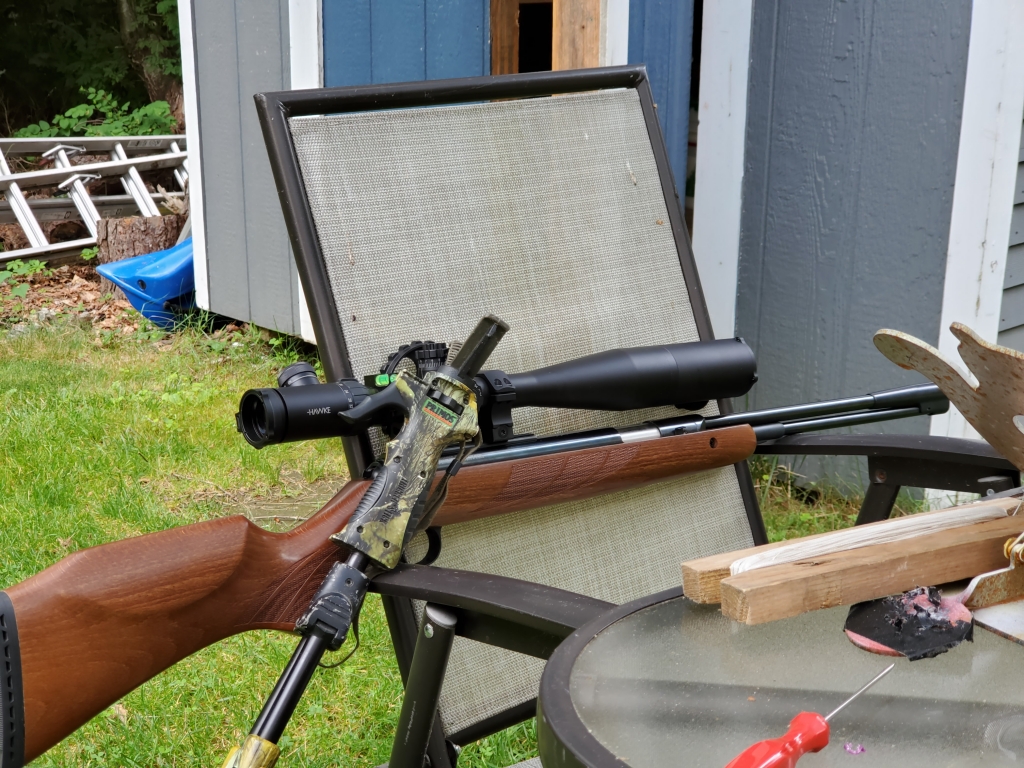

Your review motivated me to play with my 430L. I do enjoy shooting it.
Same here-but I didn't shoot today. I like the 430L a lot and I'm glad I got one when available. I didn't need a rifle in that performance range but it seemed too good to pass up at the time. Is it a little hard to cock for the power level as others have noted? Probably. Is it enough to matter? Not to me but I'm a pretty stout guy. And the trigger is good in stock form and has been excellent after a bit of work, in my view. To me, it is a very nice rifle and a pleasure to shoot.
