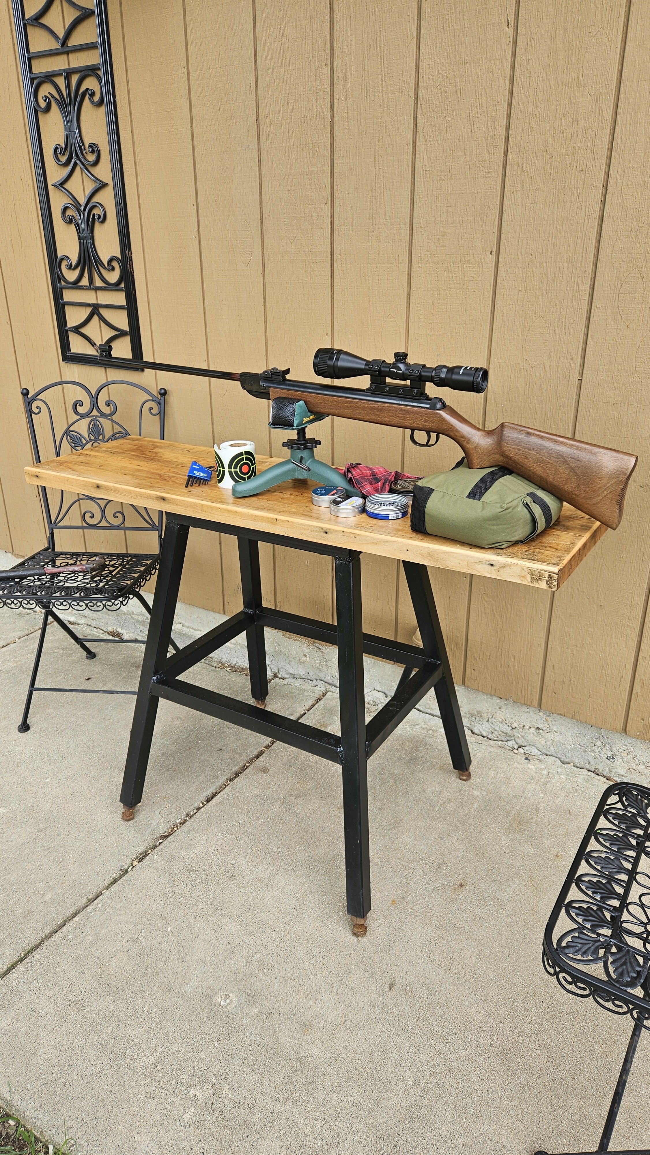

One thing I did notice my elevation on the scope is almost maxed out, i dont really like that. I ordered the rws mount with droop compensation. Apparently from reading these seem to benefit from that mount. Some have suggested bending the barrel...I have all sorts of presses in my shop so sure I could bend the barrel but that sorta scares me.
Nope, don't be scared. Plenty of threads on this subject and is the way to go if the droop compensated mount isn't enough. Maxing scope elevation on that gun is a scope killer.

Drooper mounts usually fix the problem, if you can already get it on the target at 20 yards. I had a beautiful Beeman R9, that I could not get on paper even with a drooper mount and maxed out Leupold. It went back, and the new one was almost perfect without a drooper mount.
I wouldn’t risk this, unless the barrel is truly bent as a result of physical damage. I worked for a major firearms manufacturer that actually corrected bent barrels, but the technicians doing it were highly skilled and experienced. If your barrel is truly bent, find a good gunsmith to do it.
I still don’t get this old myth about barrel droop in Airguns. Do manufacturers of high quality Airguns intentionally make guns where the barrels are bent or their bore axis is not parallel with the rest of the action? I think it’s the droopy pellet trajectory that we are dealing with. Get a dropper mount or adjustable scope mount/rings.
the scope mount you had on looked to be RWS C mount if it is you can adjust that mount to center your scope.
It does look similar but I don't believe it is. I got a bunch of those at a flea market awhile ago, not sure what they actually are as far as mfg. I put this on a surface plate and checked with an indicator and it was basically parallel so I don't think it would help with droop...if that makes sense?
The RWS mount is much nicer from my observation.
