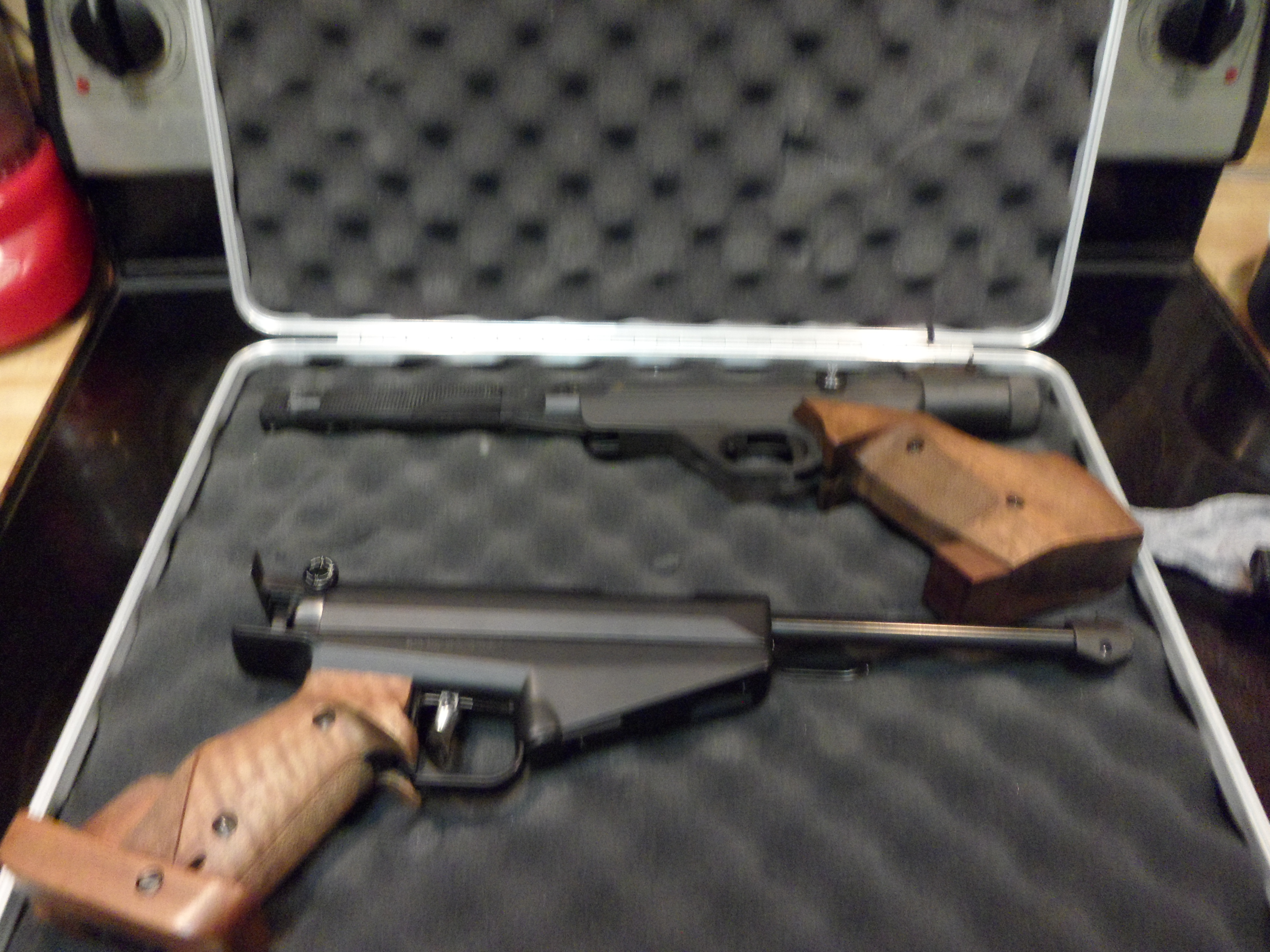

so here is a model 10 and 6m side by side

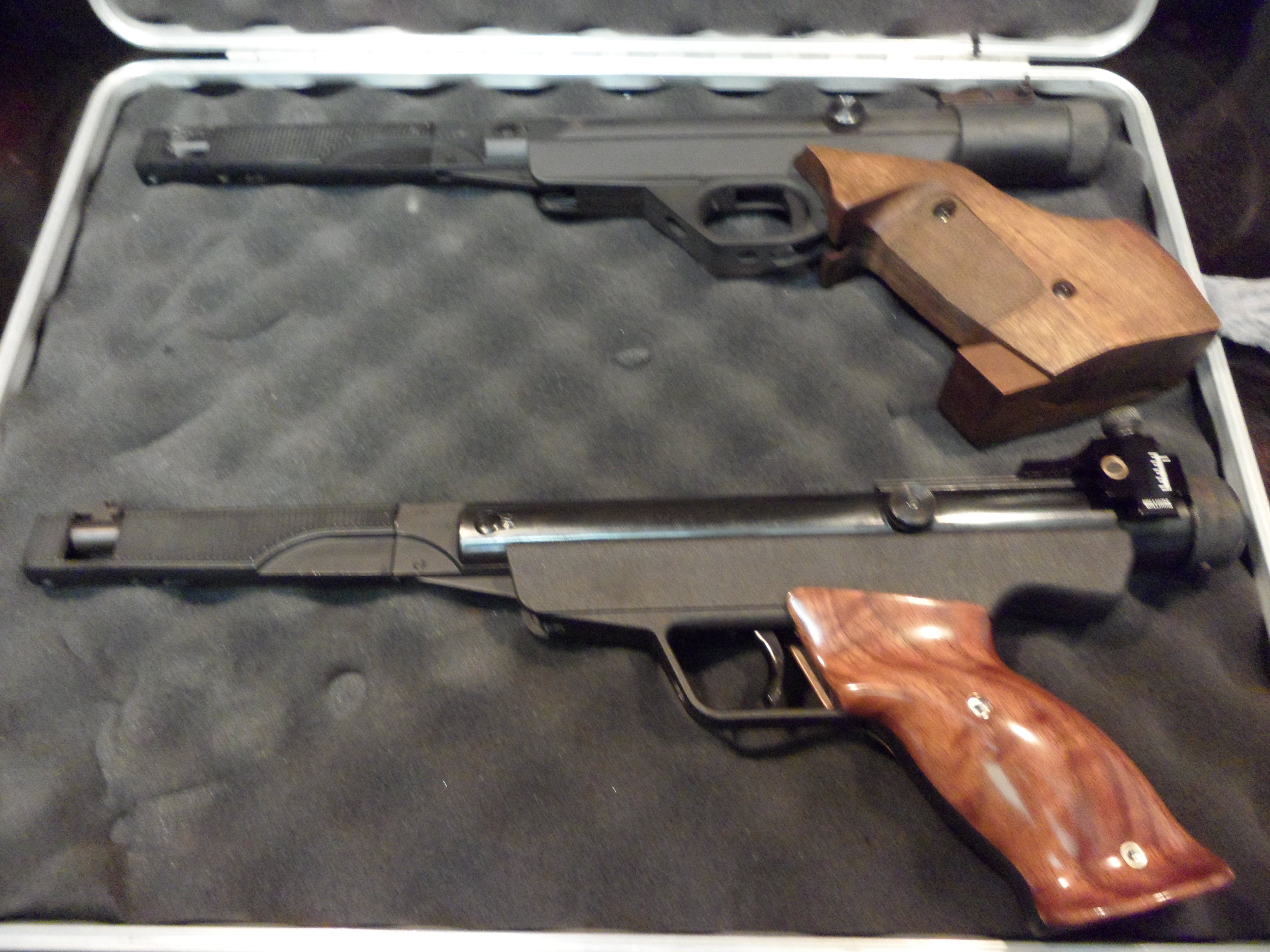

and then the 10 and a FWB 90
they are all the same size really
and for those wondering i have a model 10i have 3 one being a Beeman 900 and 9 or 10 model 6's i have lost count i know the pistols very well

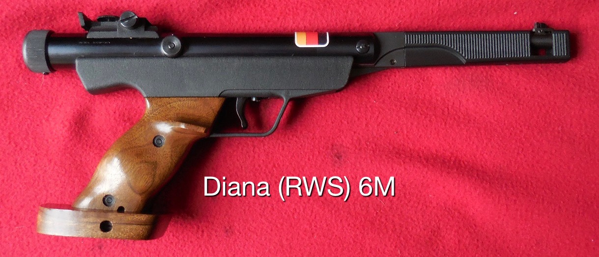

The 6M is very nice, giving you much of the model 10's advantages in a mechanically simpler package. But it has one very weird design feature: combining the very low front sight of the 10, with the high rear sight of the models 5G and 6G. So guess what...at 10 meters, it hits extremely high. I've shot several examples and they all did this.
after working on these pistols and after reading that the model 6 shoots high or low there is one common thing that i believe is-was at work and it is the breech seal
i have worked on enough of them to find from zero to 4 shims under the breech Oring but each pistol would have to be tested and not all of the breech seals even at the same size will be the same size in CS

Your notes on shimming the breech seal of the 6M are MOST interesting. Diana loved their shims in those days, and I'd wondered if enough of 'em would bring it closer to shooting point-of-aim; and if anyone could work that out, it's you. So now I want one of those again too!

so, with a pistol like the Model 6 the hinge is the controlling factor and at the hinge is the breech seal
make it thicker push the barrel down and of course the opposite with less

If you put a shim behind the breech seal, you make the gap between the receiver and breech wider and the barrel droops.
Remember that term?
If the barrel points down you have to raise the muzzle (as you would if you lowered the front sight) to get on target and the pistol shoots high.
There are simple solutions…
1. Remove the rear sight elevation knob altogether (you don’t need it for 10M shooting), file down the rear sight blade (both the top and the groove) until you are on target.
2. Use very heavy pellets.
3. Shoot further away.
4. Remove the sights altogether and have your gunsmith drill and tap for scope mounts.(Beeman used to offer this service)..
