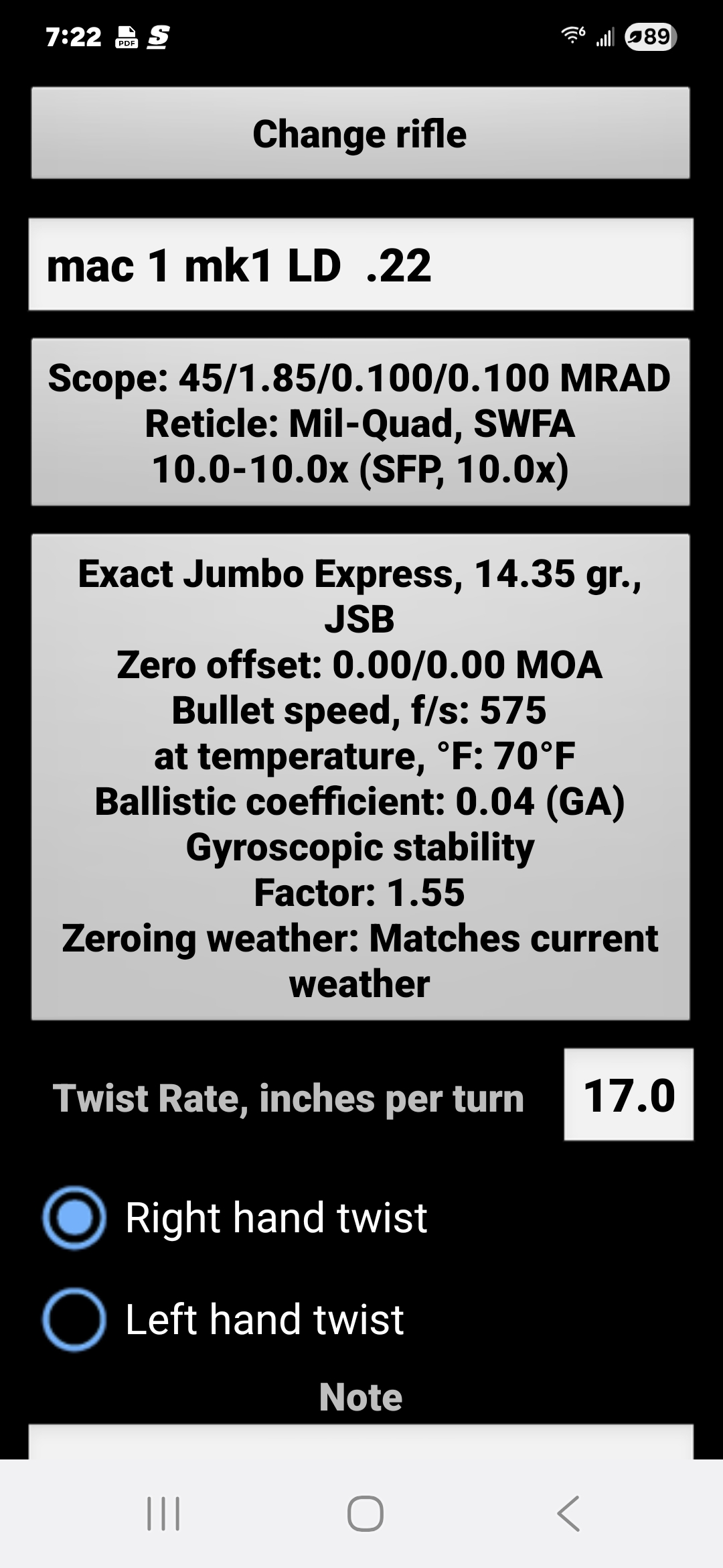

That is an excellent question. The best answer is to know the area you are shooting in, like distances to trees or any other objects from your position and the range ballistics of your gun and load. both are necessary. In other words, you need to create a range cheat sheet and memorize it, then review your hunting area before you attempt to shoot there. As you get more experience, doing this will become second nature and your instantaneous WAG will be relatively accurate. It's called practice. Even if you have an accurate range finder, without a ballistic cheat sheet is does you no good.
