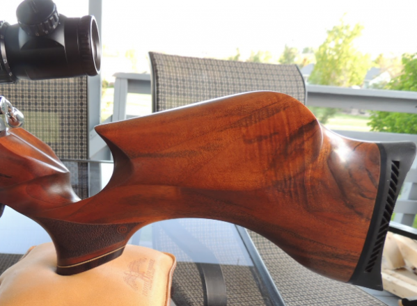

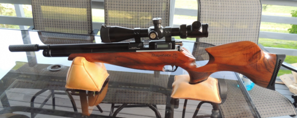

Aesthetics: 9/10Stock: The shape of the stock is eye-catching. I like the unique shape of the stock. It looks like a hybrid of a traditional stock and a thumbhole stock.

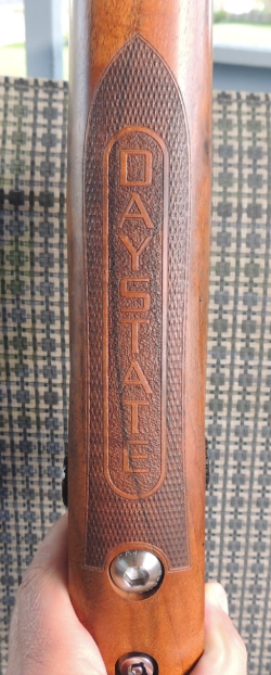

The rifle has excellent balance and is easy to steady when shooting offhand. There is nice checkering with the Daystate name proudly written down the bottom of the rifle.
The checkering is a welcome touch to add security when holding the rifle off-hand. The area is also grooved to allow your fingers purchase when gripping the gun. At first, I didn’t like this groove because I thought it added unnecessary bulk to the rifle. I prefered the more streamlined look of the Regal XL. However, I have come to appreciate the grooves as a way to improve accuracy. While shooting from a bench, pulling down on the rifle with the left hand via the grooves noticeably improves the rifles precision.
The elevated comb creates a great cheek rest. Finding the correct eye relief through the scope is automatic and comfortable as it should be on any rifle. The cheek piece looks deceptively high in large part because of the sharp curve of the butt down and away from the cheek piece. The butt looks a little strange at first glance, but is shaped to fit perfectly into the pocket of my shoulder.
The butt pad is not adjustable, and that is fine with me. I don’t like adjustable butt pads. In my opinion, they look silly when adjusted. I want the butt of the rifle to fit comfortably in the pocket of my shoulder without adjustment. This one does. The butt has a recoil pad which seems odd since the rifle has no recoil. I guess it is there to make the gun look like a high caliber big game rifle, but the presence of the air cylinder below the barrel and the moderator on the end definitely give it away as an air rifle.. The pad is textured and does a good job of sticking to clothes and making the rifle feel secure when held to the shoulder. I’d rather the butt pad be more slender and shave a half-inch off the length of the gun. The stock is attached to the rest of the gun using one beefy 8mm allen head screw. Removing it couldn’t be more simple.

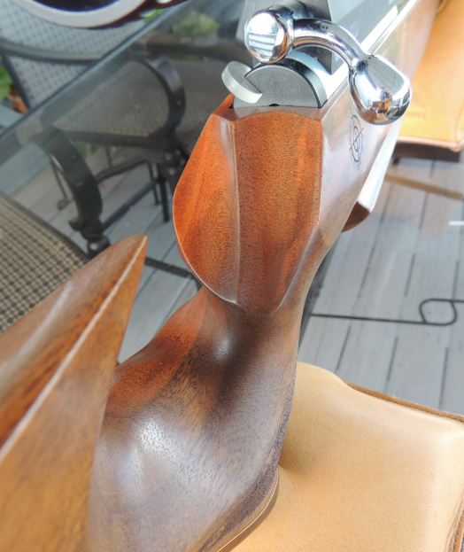

Grip: The stippling on the grip is very well done. It provides great purchase while looking good. Your thumb has three places it can rest while shooting; two up high behind the bolt and one around the side toward the trigger. The two high ones are very useful while bench shooting. I am able to press down on the rifle with my thumb while squeezing the trigger to make the rifle more stable. I was surprised to learn that this trick helped improve my shooting accuracy.

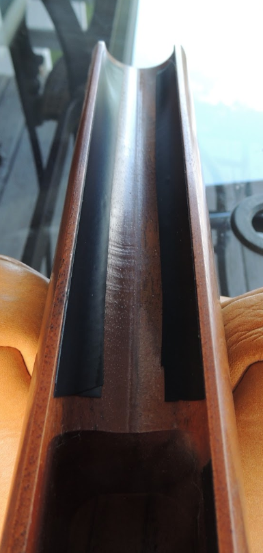

When I first got the rifle there was a significant amount of play between the stock and the air cylinder. This caused the barrel to have a very noticeable wobble. Fortunately, the stock was extremely easy to remove and a few pieces of electrical tape placed along the inside of the stock solved the problem easily.
Once this was fixed, there was also the matter of the barrel shroud clanking against the inside of the barrel band. Slight bumps of the shroud caused it to make a noticeable and cheap sounding “clunk” against the band. I couldn’t stand the way the sound cheapened the feel of the rifle. The fix was easy enough as I simply removed the barrel band and lined the inside of it with more black electrical tape. The low fit score is justified by the need to modify both the inside of the stock and barrel band with electrical tape to make everything nice and snug.

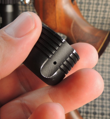

Finally, there is the fill cap. It seems handy at first that the cap sits snugly over the fill valve. However, I have found that wiggling the cap loose can cause it to rub on the bottom of the barrel and ruin the gun’s excellent finish. I suspect a screw cap would be better.

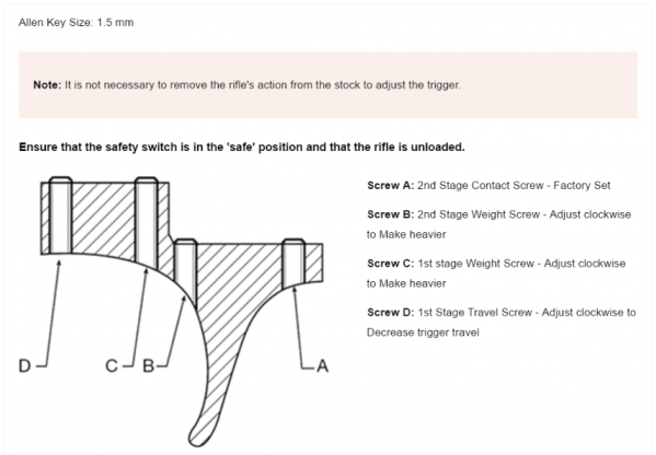

Rowan Engineering target trigger: The target trigger’s main benefit is allowing the position of the trigger to be modified. The blade can be canted to the side so that it is ergonomically easier to squeeze without moving the rifle. The blade can be moved forward or backward as per shooter’s preference. Both the stock trigger and the target trigger allow first and second stage adjustments. I prefer the target triggers adjustability for target shooting. If using the rifle as a hunting rig, I’d tighten the second stage and give the advantage to the stock trigger.

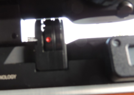

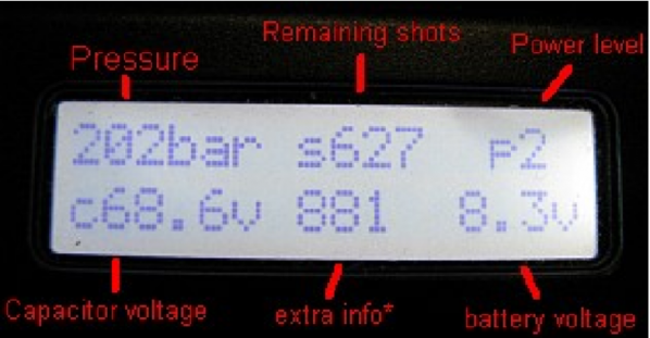

The rifle comes with a digital readout that displays 6 pieces of information.
Pressure: The top three numbers are the most frequently used. I love the digital reading for the remaining air pressure in the cylinder. I have found the gauges on other air guns to be imprecise at best and inaccurate at worst. The digital display leaves no guess work and makes filling to the exact desired air pressure simple. It also makes estimating the efficiency of the rifle easy because I can see how exactly how many BAR of pressure is used for each shot.
Shots Remaining: This adjustable setting tells the shooter how many shots are left on the current fill before pressure drops too low for desired velocity. This value can be adjusted to reflect any changes you make to individual power settings.
Power Level: Simply tells which Power setting the rifle is currently set to.

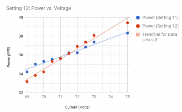

Capacitor Voltage: This value can be adjusted in the rifle menu to adjust the power of all power levels simultaneously. In order to get the most power out of the rifle, capacitor voltage would need to be raised. It can be adjusted up to 76 volts. The maker of the board says that shooting the rifle at higher voltages will shorten the life of the capacitor. Each 0.5 rise in voltage equates to about 10fps of increased velocity across all Power settings. I chose to set the rifle to 72.0 volts and remap each power setting curve to match my new voltage.
In addition to adjusting the voltage to increase or decrease the power of all settings to the gun, each setting can be adjusted up or down individually as well. For example, if I wanted to drop setting 4 from 12.2 FPE down to just under 12, I could change the power ratio for setting 4 from 1.00 down to .97 and thus reduce the power by about 3%. Each setting can be adjusted independent of the other settings this way.
The solenoid is very good at adjusting the power immediately after adjustment. For example, I can take a dozen shots at over 800 fps and 27 FPE on the 8 Power setting and then switch down to Power 3. The solenoid will immediately give consistent shots that are around 540 FPS and 12 FPE. The adjustability is all I dreamed it would be. It is very easy to change between power settings. Once each power setting is setup to your liking, it is the quickest way to adjust the power. I enjoyed customizing the settings to my individual needs.
Extra Info: This number tells how long the “pulse width” was for the last shot. The rifle reads the pressure in the air cylinder and sends a short burst of current to a solenoid. The longer the electrical burst, the longer the “pulse width” and the harder the hammer hits the air cylinder valve. The actual number for the pulse width usually decreases with each shot. This is because as the pressure inside the reservoir decreases, the hammer needs less force to open it. This pulse width number is how the rifles power adjustment is customized for each power setting.
Battery Voltage: Reading of how much charge there is in the battery. The rifle needs charged monthly. This is a pain-in-the-butt as I can see myself forgetting to charge the rifle for a few months of inuse over winter and having the battery go bad. I’ve also experienced a “Low Battery” message after a couple days of heavy shooting in a row. On the plus side, if the battery ever needs to be replaced, it is easy to access.

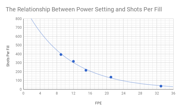

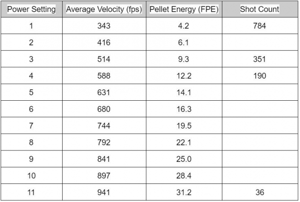

Efficiency and Shot Count: 10/10
Data collected using unsorted 15.89 grain JSB Exact Jumbo Pellets

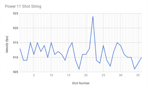

The manual for the Helliboard states that the settings may need to be tweaked since each rifle, pellet weight and need of shooter is different. I found this to be 100% true. Better values can be determined while shooting shot strings and making note of the pressure and velocity of each shot. I recalibrated with these new and improved values to flatten out and customize each shot string. I calibrated each power setting to my own power specification and pellet weights. Each shot curve is now flat and consistent for each setting.
The 36 shot string (shown below) resulted in a standard deviation of 3.36 fps with an extreme spread of 18 fps. The electronic regulation has a habit of letting an occasional shot shoot hotter or slower than the rest of the string (thus keeping the consistency score from being perfect). In this sample, shot 22 was a little hotter than the rest and ruined an otherwise stellar shot string. The biggest issue I have found with the electronic regulation of the Daystate and Helliboard are these occasional blips in velocity. I am not certain what causes 1% to 2% of the shots to be “fliers”. I suspect the answer is that the Helliboard is checking and adjusting the pressure inside the reservoir about twice per second. After each shot, the remaining volume of air in the reservoir is agitated and can fluctuate up to a BAR of pressure before it settles back down. The solenoid relies on an accurate reservoir pressure to determine how hard to strike the hammer. I think the fluctuations of pressure immediately after a shot lead to the occasional hot or cold shot. The rate of these “fliers” does seem to be correlated with rapid firing of the gun. Without these fliers, the consistency would be outstanding. These fliers are the sole reason I docked 2 points for consistency. They don’t result in a different POI at high velocities or short distances. However, they are definitely noticeable out to 100+ yards and slower velocities.
