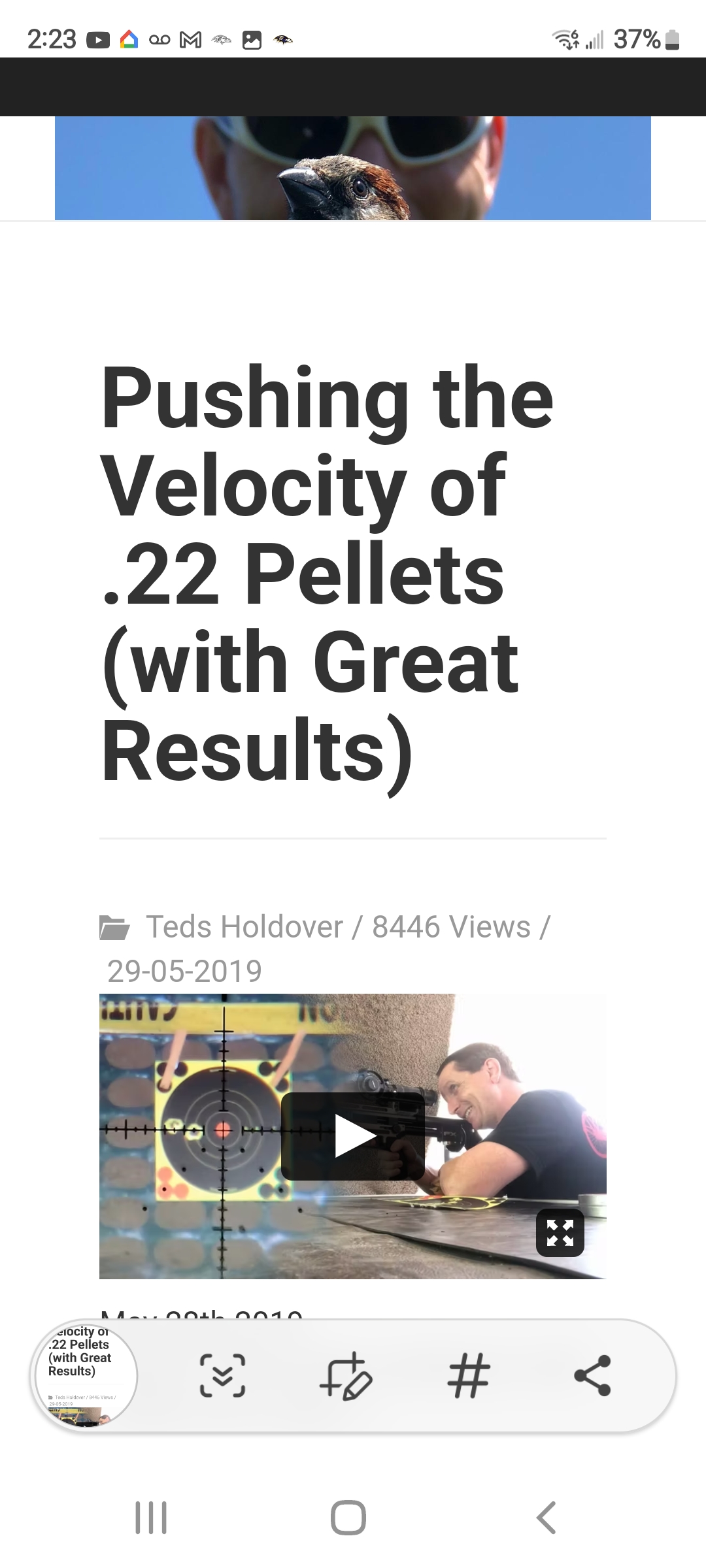

A nice video on YouTube of Ted's holdover pushing jsb .22 18.1 @ 935 fps with great accuracy from impact with 700 mm bbl. The .20 cal jsb 15.9 heavy get funky @ 920 from my Rapid mk ll. I think each gun/barrel handle them differently.
oddly teds holdover link from you tube gets deleted when i try to post it here (oh well) anyway, i am aware of the link you are referring to irt pellet speed stability for .177
Try Airgun101.
