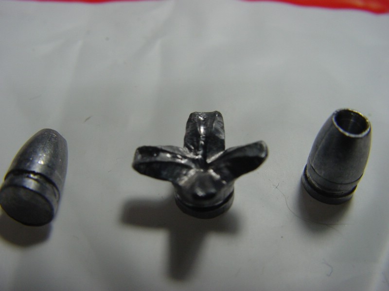

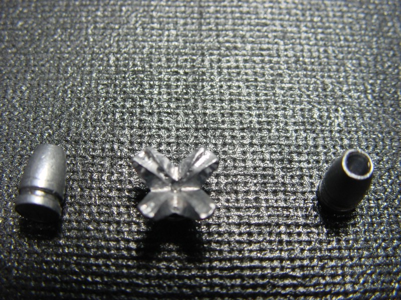

There was a thread on the GTA recently with people having no luck with Hollow Points in their pistols due to low velocity. Some even reported no to poor expansion in lower powered (600) or slightly more fps), pcp rifles. This led me to experiment further. As many of you know, I design and test slugs for myself and a few others.
Using a PP-700 .22 at 475 to 500 fps with the 27 grain slug, I am having these results with my hand cast HP slugs. I will be making a fixture for my mill for repeatability for accuracy.
This pic is from the PP at stated @ 20 yards into a simple water jug filled with simple tap water. Not a decent test, but all I had at the moment.
Expansion from the .216 slug was over .454" and I am looking for a deadly vermin slug when walking the pup here at night out in the country.
