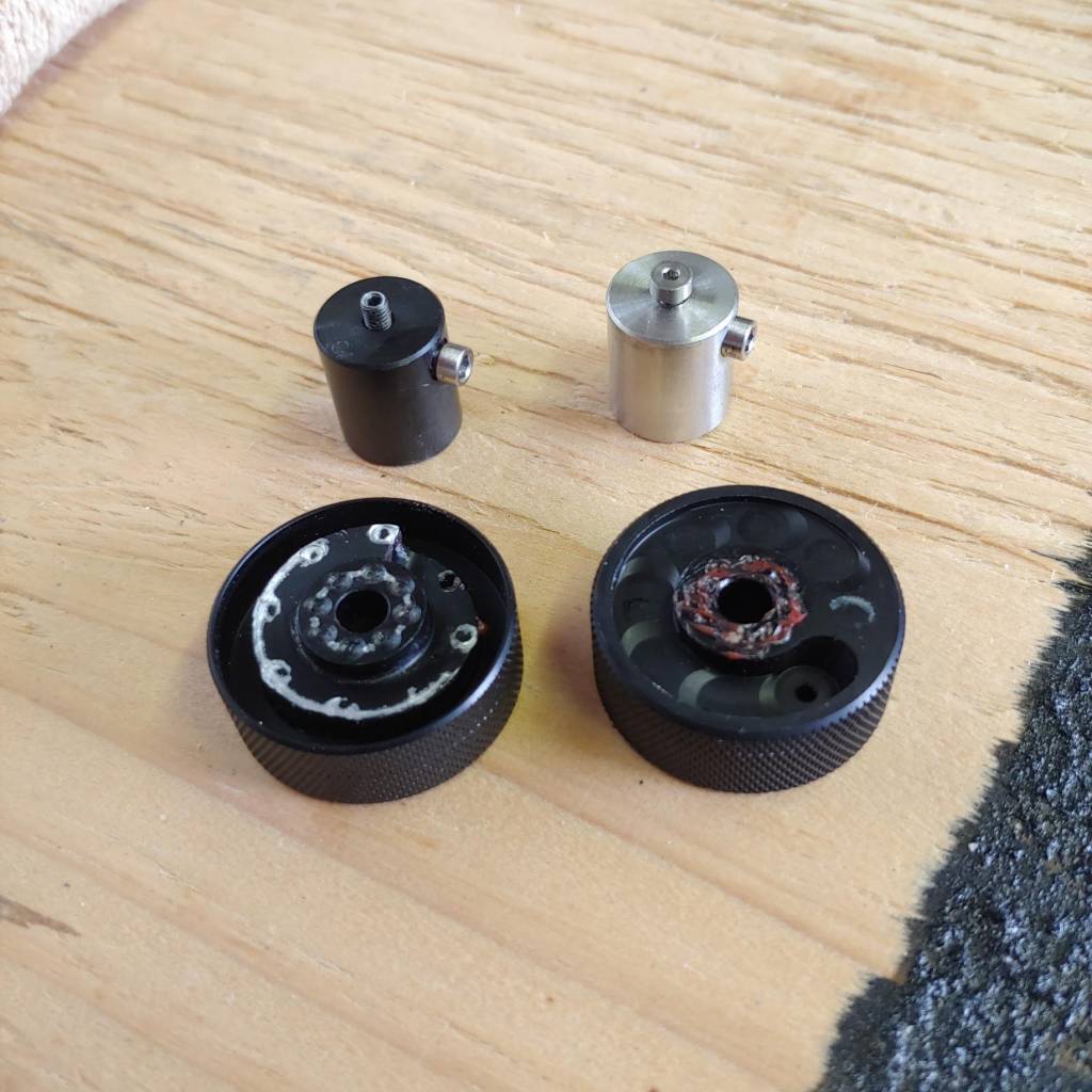

There is a difference and I assume an improvement. My 1st Wildcat MKIII was equipped with the parts on the left. My 2nd WC is equipped with those on the right. The wheels and adjusters have obvious differences.![]()

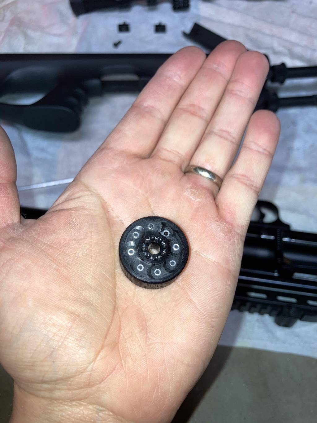

This is the solution. Widen the contact area so the force is distributed over a wider area. I’ll contact FX and see if I can get the updated parts. This should be covered under warranty.
I emailed FX and they got back to me almost immediately. The updated parts will be sent to me.

You mean to tell me that FX sent out guns with an aluminum part designed to slide across the top of a socket head set screw? Seriously? On a $2000 gun? Am I seeing it wrong as to how that works?
