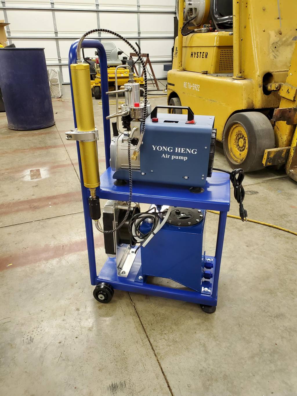

I have filled my 75cu ft tank several times now and the water never even gets warm. I am planning on doing a build in a much more compact version when I get time.
Thanks for sharing your build. I've been brainstorming about an almost identical build and you saved me a ton of time on researching the radiator/tank parts list. Can you please elaborate on how you have the plumbing done between the tank, radiator and pump? I'm guessing the rad is on the return side, is gravity enough to get the water through it and back into the tank? Also, does it matter if the flow gauge is on the pump or return line?

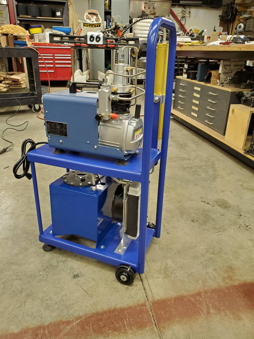

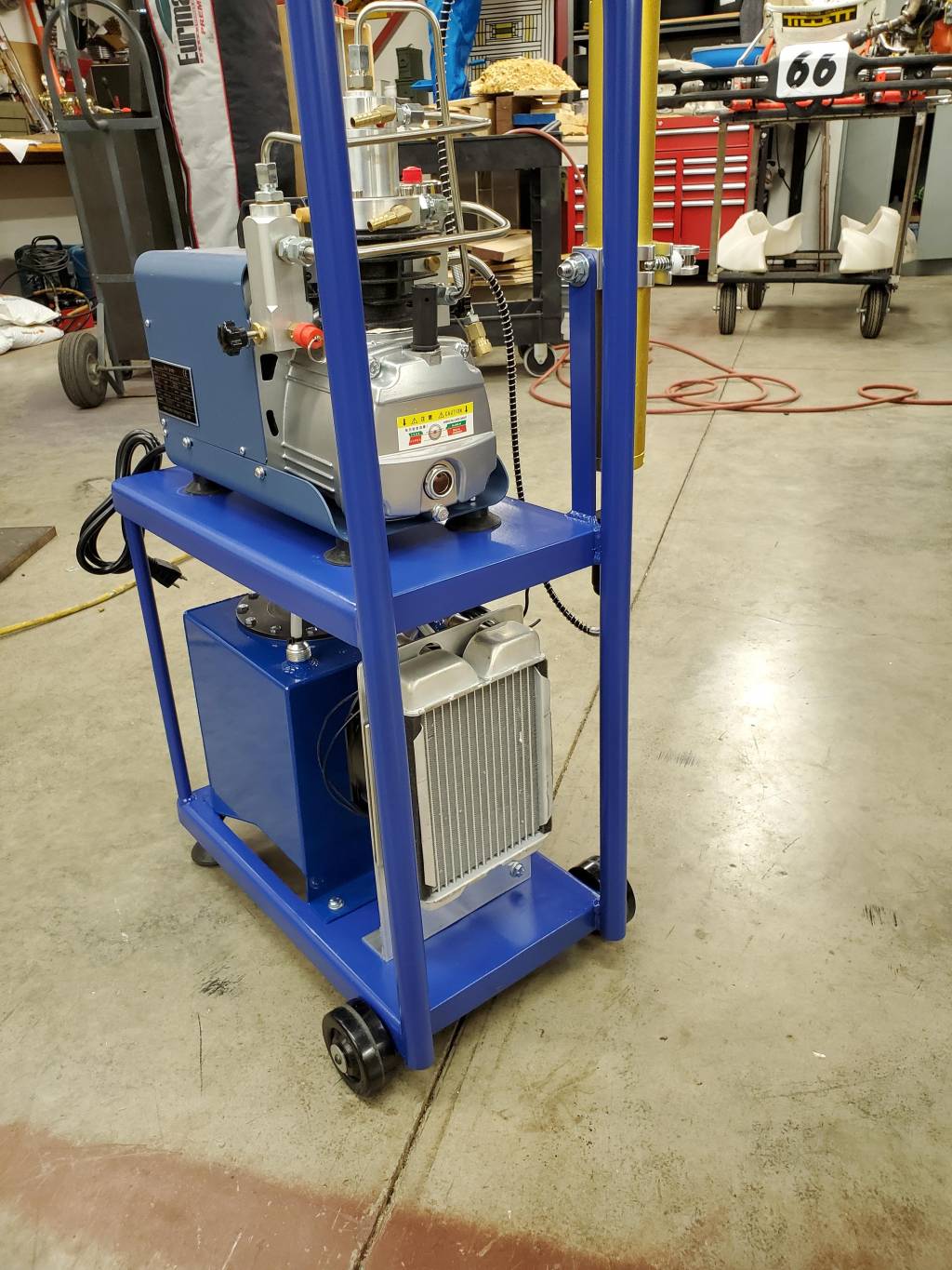

I like Greg's build too - looks great. It doesn't seem to have tubing yet, however. I added a computer radiator that uses about the same size tubing as the Yong Heng simplifying hooking things up. I put two small 120V fans on the radiator and the radiator is on top of the bucket. In the winter my temperature rise was not to more than 60 degrees C. But in the summer the temperature started rising to 70 C quickly. I checked the pump (a bigger one than came with the YH and it seemed to be working fine. Then I noticed the vinyl hose I hooked it up with was kinked in a couple places. So I replaced it with 5/16 brake line hose. Seems to be much more resistant to kinking. Temperature on the last fill did not go over 63 degrees C. I use my YH to fill my 45 minute SCBA tank.
So my point is to worry about the hose too. Little pumps don't push full flow past kinks.
My other suggestion is you might want to make it possible to raise the gold filter when you are using the YH. I have but do not use a moisture filter that size partially because it would be difficult to get water that condenses in the line to flow back to the YH. I want it to go there so I can vent it and not trap it in the filter. I open the vent about every 5 minutes of run time and moisture comes out every time. I use color changing dessicant beads in a smaller black filter (in addition to the stock cotton filter that came with the YH) and I rarely have to replace them. So I see no need for a bigger filter. But I think having water flow back to the YH and venting it is part of the reason I don't need a bigger filter. I replace the cotton filter after each tank fill. I bought a bag of 100 from Allibabba.
