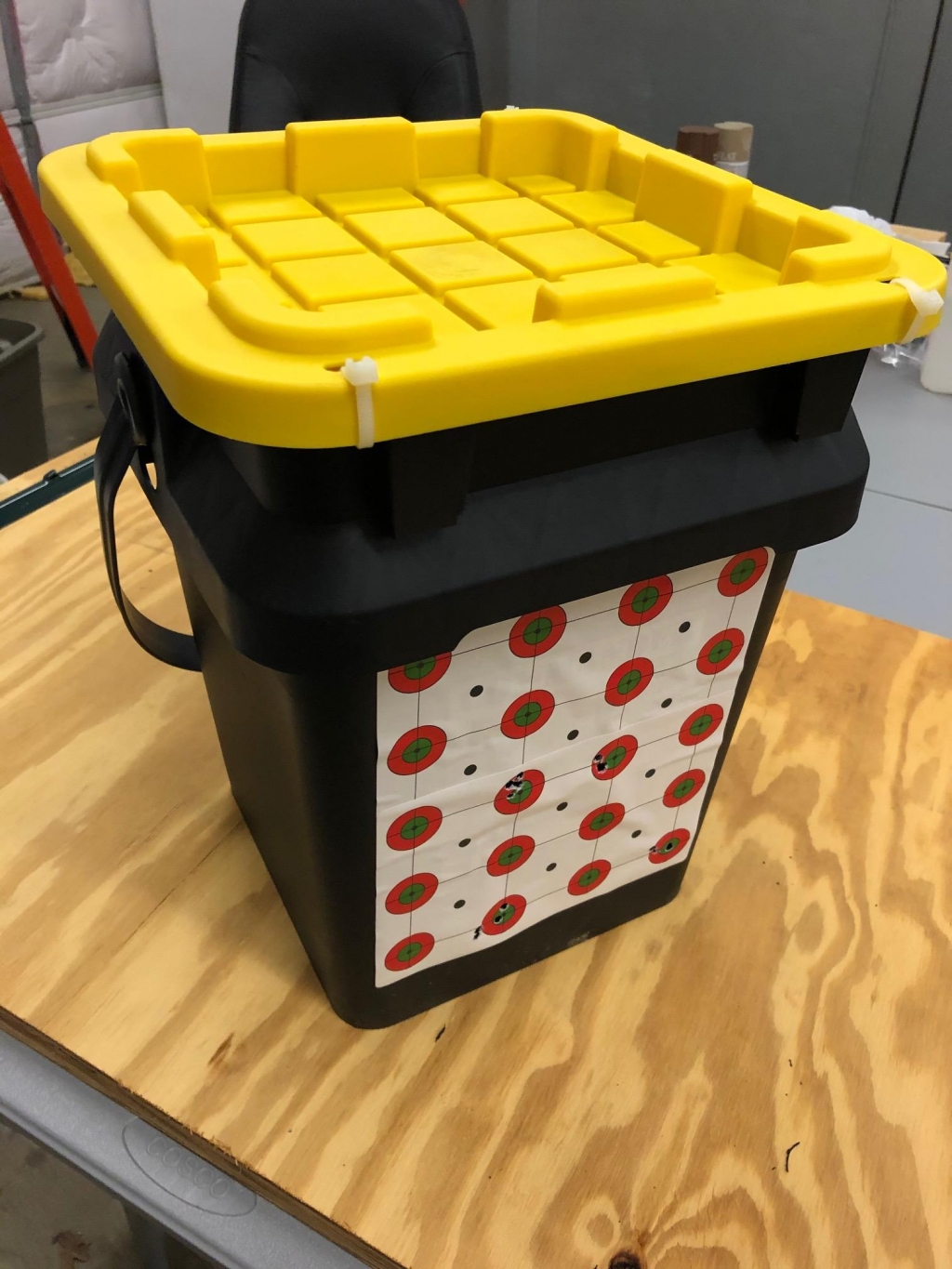

These 12" x 12" x 15" tall square buckets from Lowes work very well. Only $5 and weather proof. Holds one bag of rubber mulch perfectly. Gives you four sides to attach targets and increase the life span.
To figure out thickness get boxes that are an inch thick, fill each with mulch. Tape them together to form a stack, shoot with you favorite pellet gun. then take apart the boxes and see how many 1" boxes you shoot thru. I started with 9" thick and changed to 6". It will stop anything I care to shoot at it. I have never shot the steel. Very quiet and heavy.

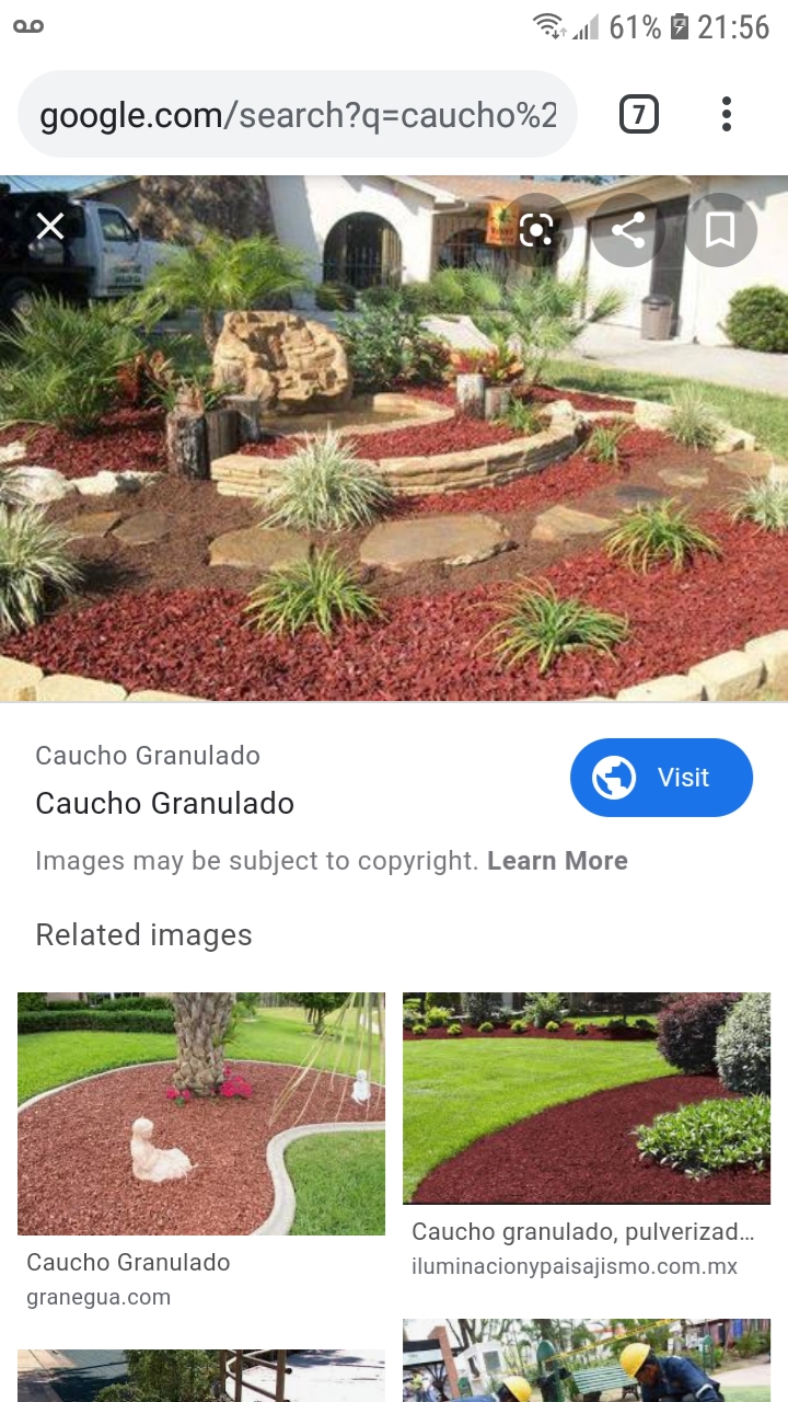

Then I went googling "rubber mulch" in Spanish = "caucho granulado" — well, maybe that's what this is — and maybe not....?
As I need to buy this stuff in Peru and I have no idea what it looks like — would one of you be so kind and send a pic, maybe the mulch together with some common object so I get an idea of how "fine this mulch is....?

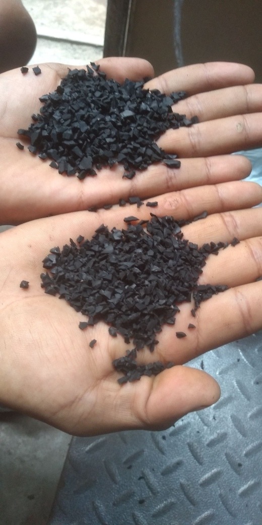

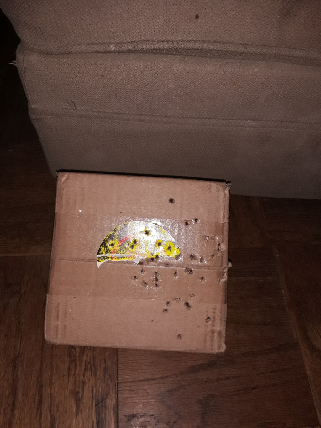

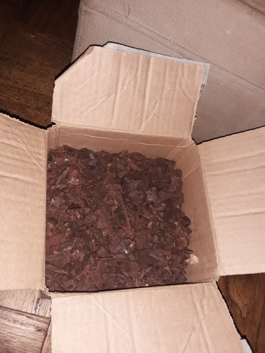

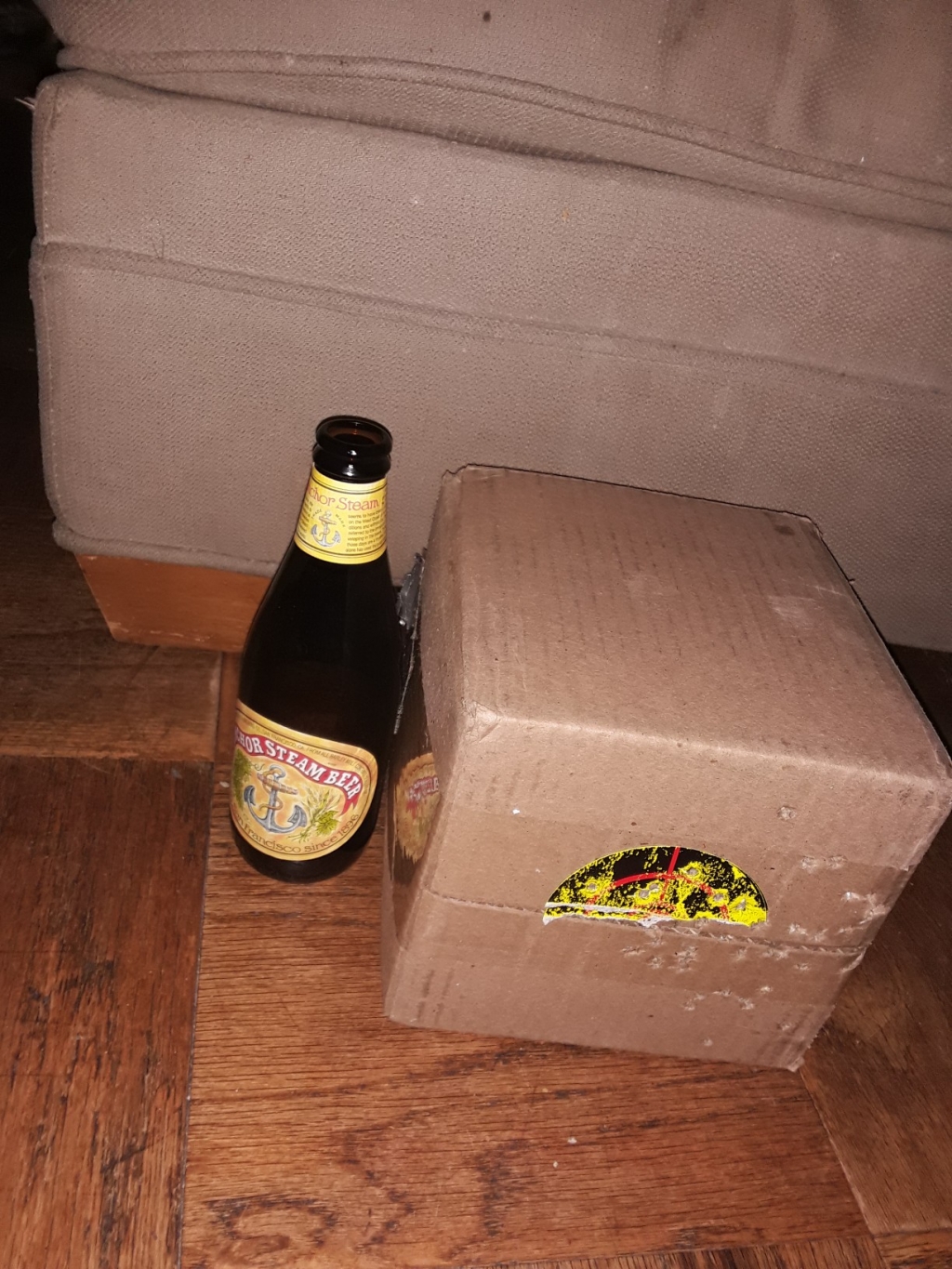

Looks like the same stuff to me..

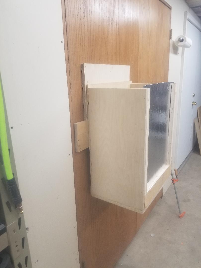

Unfortunately I never got to this project on my boys day off from school but I did finally get around to it.
I've had this scrap baltic birch banging around in my truck or in my shop for ages and finally decided to build something from it before throwing it away. It was in horrible shape and not really worth doing any sort of premium project with.
The depth of the mulch is 11". Total trap is around 20" x 24" x 12". I can mount one of those 12" x 18" paper game targets with room to spare.
It is hung on a shop door with a French cleat so I can slide the trap left and right depending on where I'm shooting from.
The front is a 18" x 24" corrugated plastic voting sign. I covered it with aluminum foil tape (perpendicular to the corrugations) to start off with an easier to repair surface. The mulch has enough play when fresh to replace the corrugated plastic without taking the trap down or emptying out the mulch. You just have to start a fresh sign from the front while pressing back on the current sign. How this will work once the plastic is shot up and the mulch is settled remains to be seen. If it doesn't work then the trap can be lifted off the cleat and laid on its back and a new sign slid in.
The entire carcass is glued and pocket holed together but the top is just held on with a few face screws per side. Easy to remove to add or fluff up the current mulch. Second picture shows the top removed and resting behind the trap on on the French cleat.
I had planned to mount this trap inside of the closet behind the door it's pictured on but I decided I needed more room to move it left and right depending on the distance I shoot from. As it is I can shoot from 75' 6" all indoors if I have my bench tucked all the way back in a hallway.

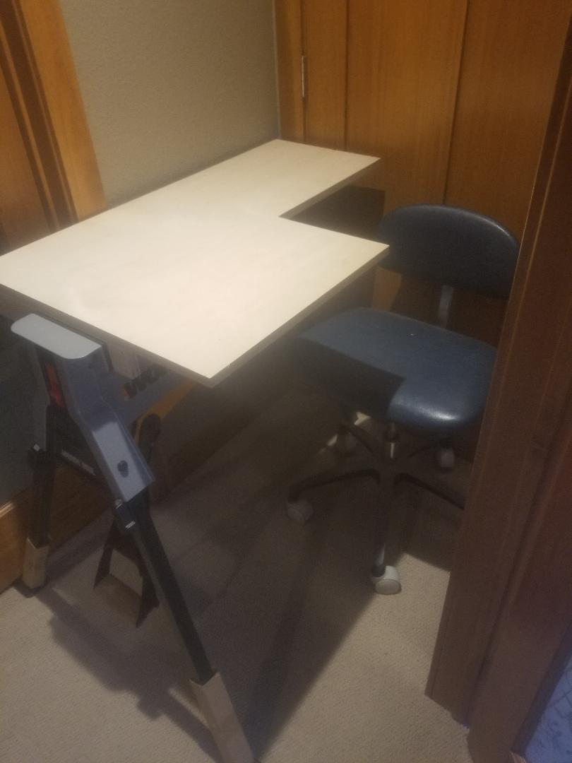

Shooting bench is another piece of scrap Baltic Birch with 2" cleats pocket holed to the underside and clamped to a Worx Jawhorse.
