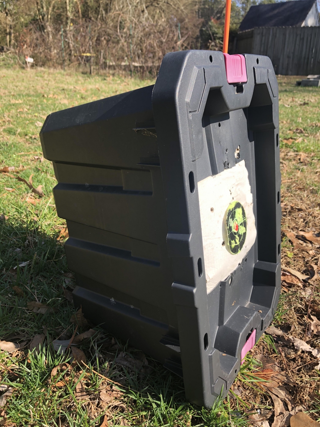

Not sure how it’s quieter? I can’t say the plastic is very loud at all. I use a cardboard front for mine. Also, I shoot regularly at 32fpe and sometimes at 62fpe into the same target, never a pass through. Reason I like the plastic is that I leave mine outside all the time, sun, rain, snow, and no problem. The mulch tends to settle, and I shoot in the middle, so the gap on top for me, is negligible.
You use a cardboard front. Is that because it is quieter than a thick piece of plastic? That is what I meant.
