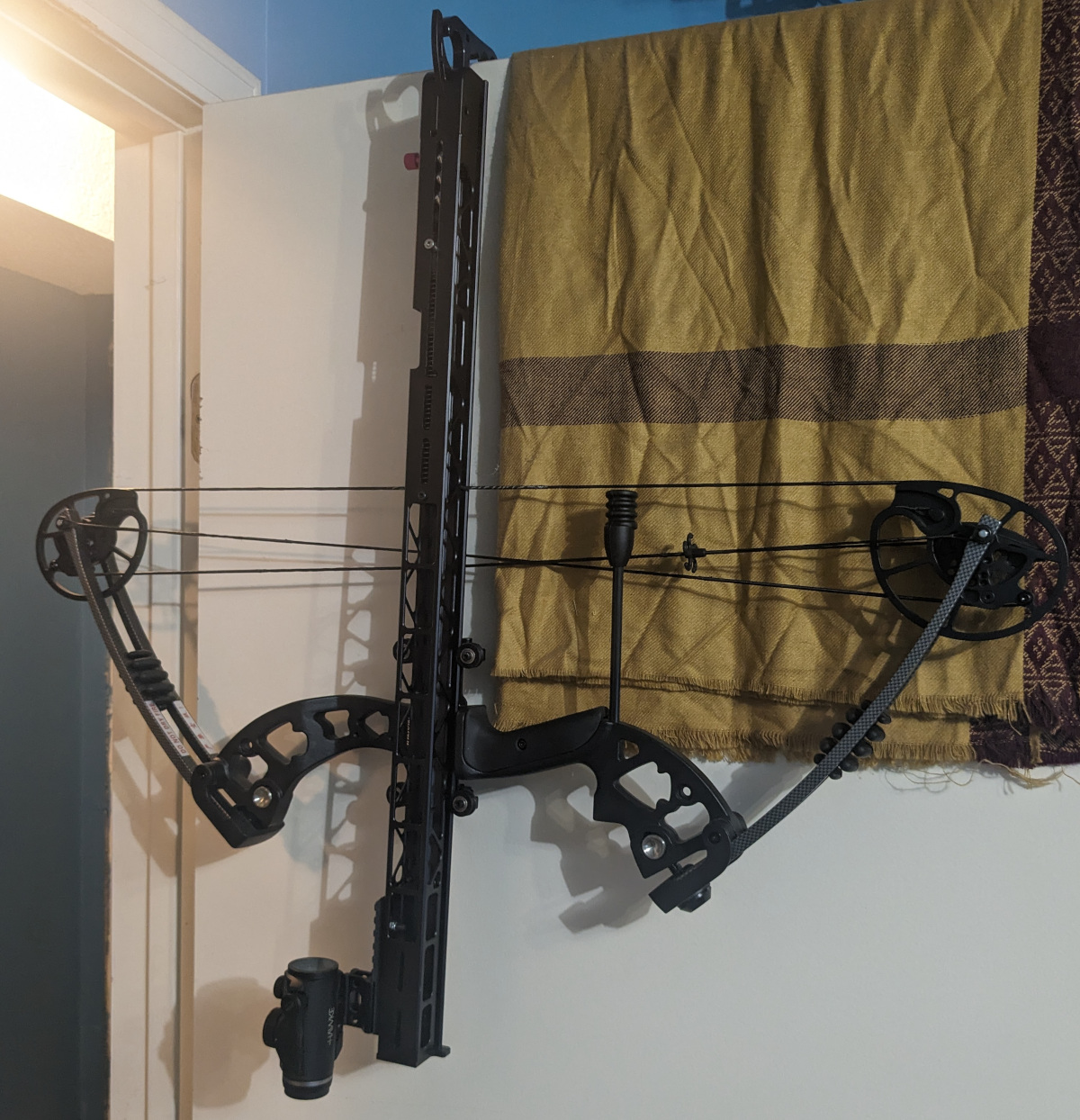

There are nice "conversion kits" that turn bows into "barrelled" slingshots with red dot sights. These are pretty heavy-hitting things, shooting 15mm carbon steel ballbearings. They appear to give good-enough control for 30yd pesting.
On the plus side 15mm carbon steel ballbearings are pretty environmentally friendly. Carrying a bow around the yard raises less eyebrows than a rifle. And it's quiet.
But it doesn't quite have as fine aim control as a scoped rifle. And steel ballbearings are more expensive than pellets -- typical prices I'm finding are in the $0.40 per BB. And there's probably far less thermal devices that would work on it.
When I get the chance I'll put the device over a chronometer and see what kinds of speeds I'm getting. 15mm carbon steel ballbearings are around 14 grams (216 grain) each.
Here is one of the kits I'm referring to:
It's basically a combination of magazine and barrel that you strap into a bow. Search ebay for things like "Launcher Magazine for Repeating Compound Bow Capacity 16 Balls Newest" and you will get a pile of variations, with different projectile sizes. These are variations of Jorg Sprave's Fenris bow magazine idea.

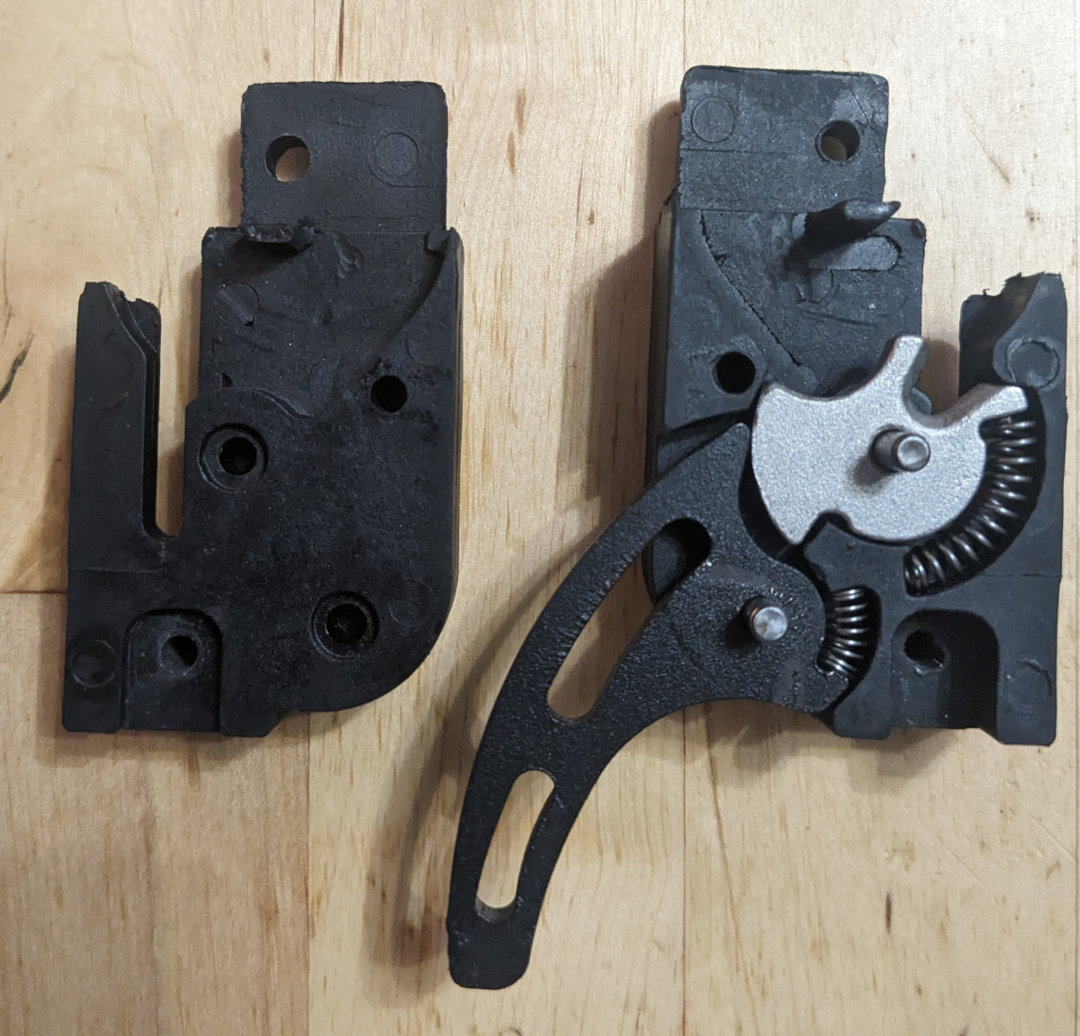

Well so far it's not all that encouraging. The unit is hunting-accurate for 30-yard (30-meter) hunting, and fires at about 280 fps. So it hits really hard. The problem is my unit came with a faulty trigger.
The problem with the trigger is it sometimes lets BBs between the string and the string-holder (trigger assembly) during a shot. So the BB interferes with the string being grabbed by the trigger mechanism. You have to disassemble the unit to fix the problem, which largely negates the purpose of the magazine.
I suppose I see two novel features of this magazine 1) it's easier to maintain a higher accuracy than with a traditional slingshot and 2) reloading in principle should be really fast. This trigger flaw negates (2).
Replacing the main spring in the trigger assembly went a good-way to fixing the trigger issue, but I still encounter problems occasionally. The spring the trigger came with was a little too weak. A stronger spring helps, but if you make the spring too strong, you can't get the trigger mechanism to close on the string. So I'm not finding a happy medium.
Here is the trigger unit, and its internals.
I'm beginning to think the solution might be a combination of a slightly weaker spring with more pre-compression, or maybe the primary metal item in the picture above, the little "arm" it has, that keeps BBs out of the "barrel" when the string is loaded, perhaps that needs to be a little longer, as right now it doesn't take much for the BBs in the magazine to push through that.
Needless to say, when I bought this item I didn't think I'd need to re-engineer the thing.
The original main spring appeared to be about a 20mm long, 0.4 or 0.5mm thick, 5mm diameter (cross-sectional) spring. As I went up to a 0.7mm thickness spring, things improved and I could get about 3 consecutive shots off. 20mm length seemed a bit short, so I tried 25mm in length, but that spring couldn't compress. So I tried cutting a 25mm spring down to 23mm and that worked about as well as the 20mm spring. Hmm. It seems like the reason the 0.7mm thick springs eventually fail is they start to deform, i.e. they don't spring back to their original length after a few shots. Will see if I can find some better springs.

The problem is it's letting BBs past the trigger at the wrong time. The magnet works well. Part of me wonders if it's maybe working too well, helping to pull BBs past the mechanism that should lock excess BBs in the magazine.
I'm going to try one other type of spring (on order) and then maybe start modifying the trigger mechanism more substantially. Also waiting to see if people who have functional triggers can show what's the difference between theirs and mine.

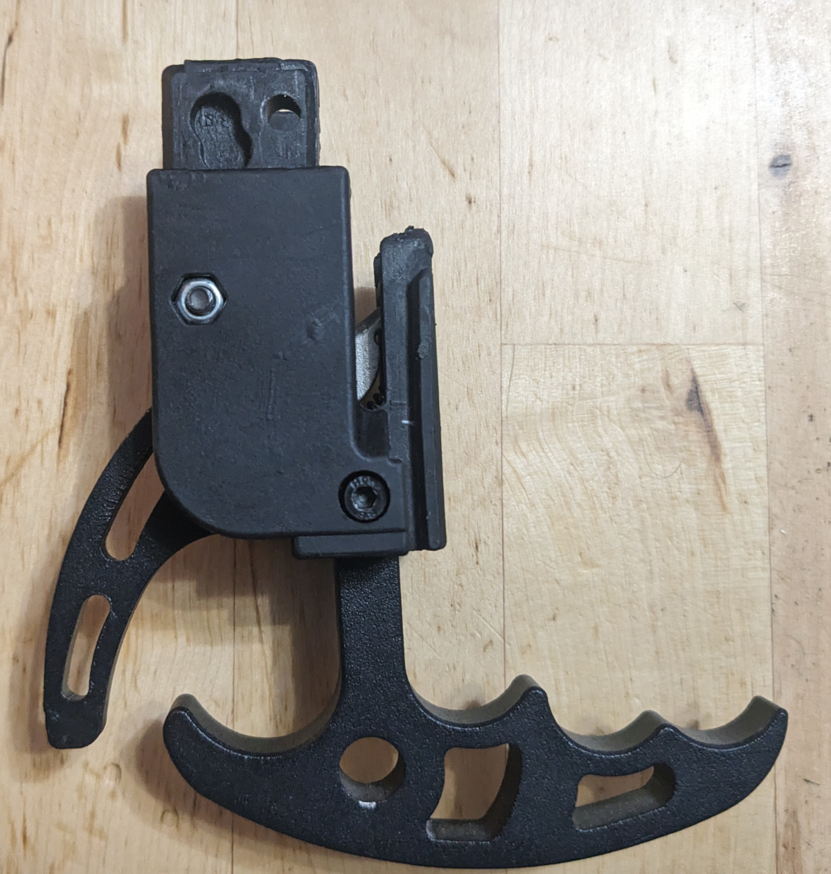

I replace the entire magazine unit. It looks like the manufacturer has been continuously changing his design. The top image (original post) is one of the earlier designs. This new one appears to be the most recent revision (pic below).
It also appears to be the one Joerg Sprave reviews in his video:
So far this unit has worked flawlessly. I'll try running it through the chronometer tonight. My arms got exhausted playing with it last night. Need to build up my bow-draw stamina.
Other than actually working (my first version did not), this unit does have a downside, that it doesn't have the little "finger hold" on the front. My first unit had one, and it helps keep you relaxed when the unit is drawn. Maybe later when my stamina for bows has been built up it won't matter, but right now when I'm a little weakling, I tire more quickly than I'd like. I'll see if I can retrofit the other finger hold unit to this one.

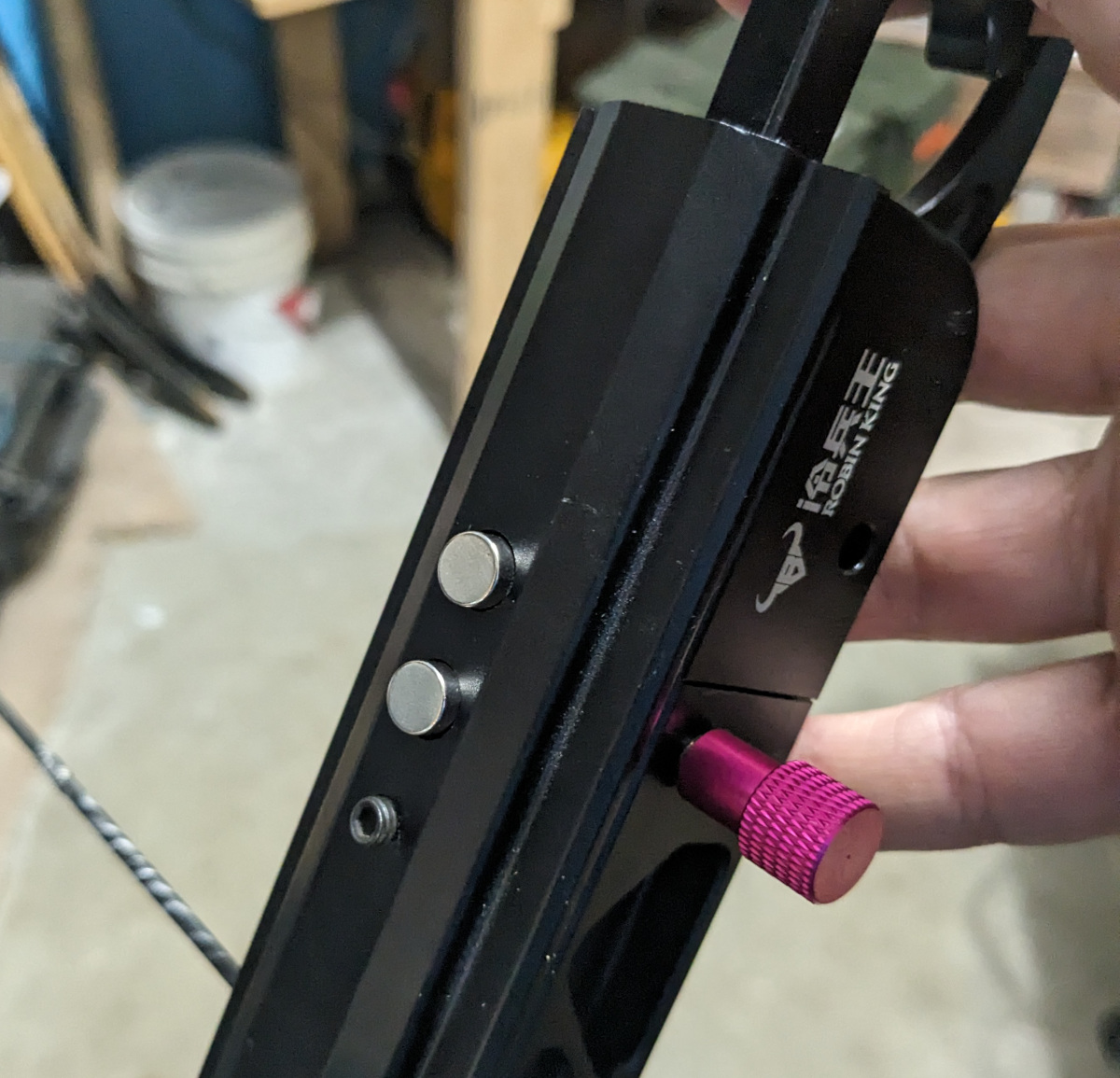

One other mild criticism is the magnets that hold the BB in place once you have it loaded in the barrel (with the string behind it), these are a tad too weak. They do their job most of the time, but if you load the unit with the barrel pointing straight down, sometimes the BBs slip out. This should be easy to fix. I've ordered some magnets that should fit perfectly to boost the strength of the current magnets.

With the new quiver I'm still getting around 280fps (85m/s) on shots.
Waxing the string on reloads seems to be keeping my bow string alive. Maybe it's too early to tell, but right now it looks like the string needs re-waxing about every 20 shots. Maybe that number will go up as the whole system gets a wax coating.
I haven't shot my bow in a long time. Will probably take me another week to get comfortable doing strings of 10 shots.
So it's consistently working well now. It does occasionally have loading problems when the magazine is near empty. And if you put a BB in the barrel with the barrel pointed down, sometimes the BB falls out. That should be fixed soon with a stronger magnet.
