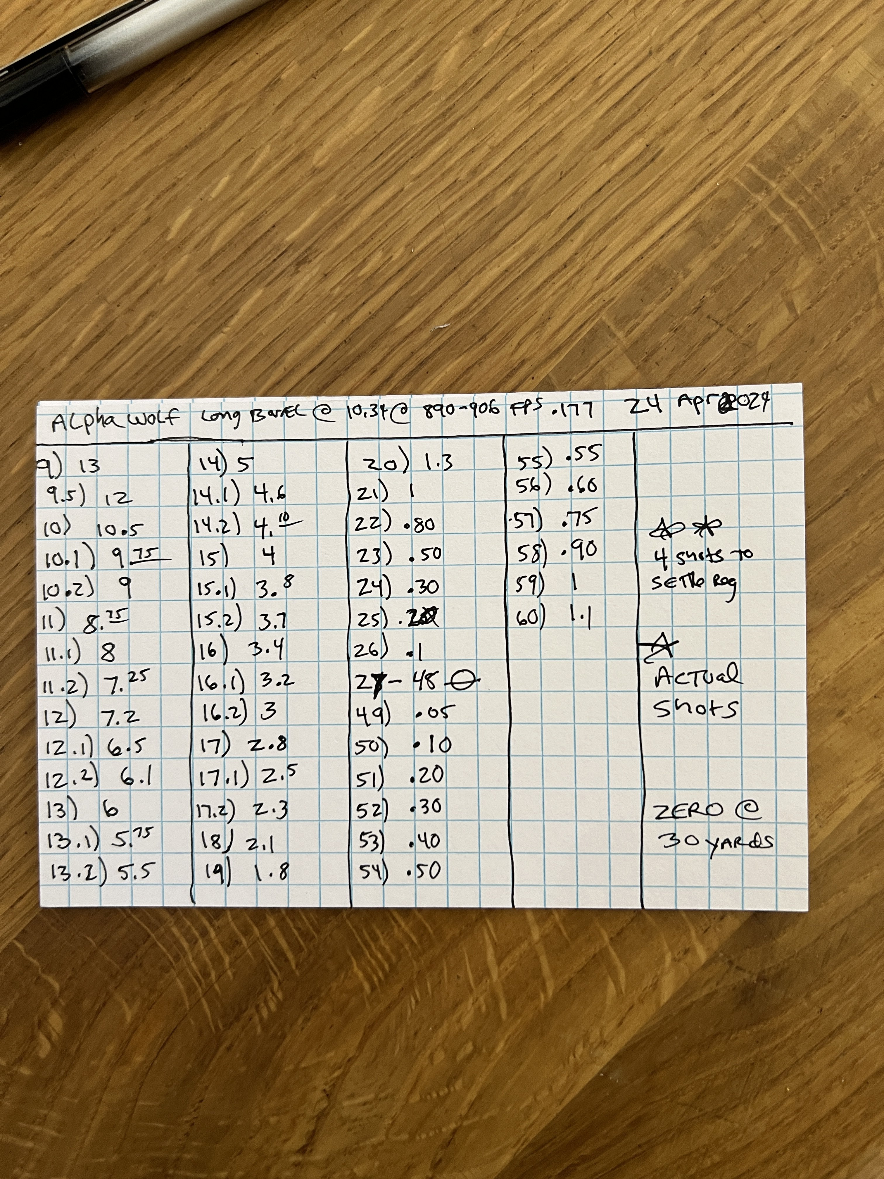

Thought I’d update this thread. I zeroed my 28” barrel at 30 yards and created my dope and verified my dope with actual shots from 9 yards out to 60. Be darned, look at this apex flat from 27 to 48 yards.dunno = i just got lucky on this, as in, i was trying to find a factory setting (bastardized in a way) that would quazi work for something in a way not normally intended. Why @Daystate hasn't created / published more tried and true tables for the advanced settings is beyond me?
