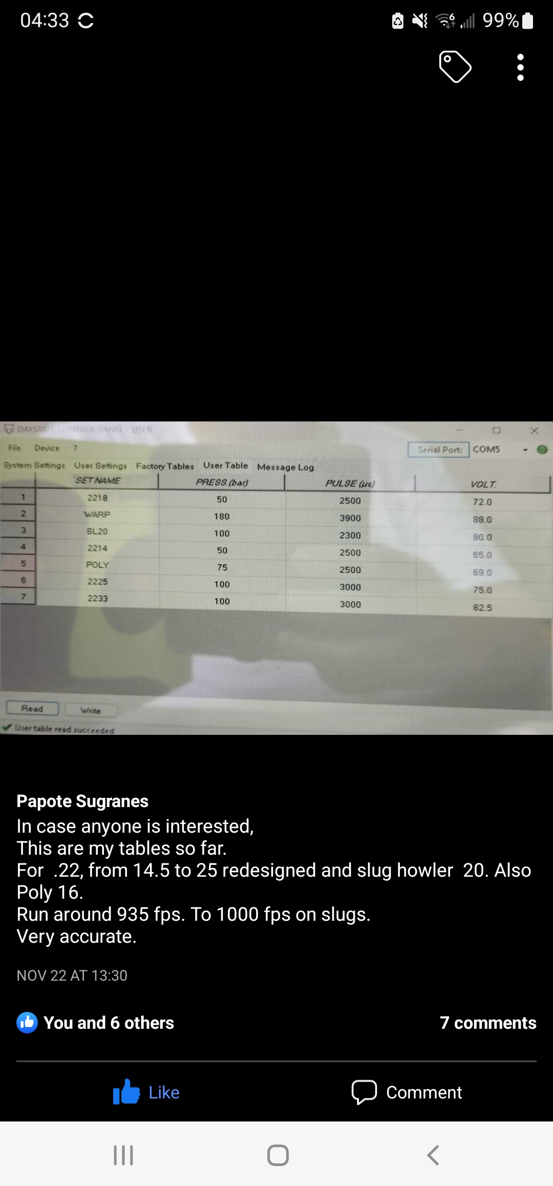

Deltawolf .25 settings
Copied from the Alpha& Delta Wolf group on Facebook:
In case anyone is interested,
This are my tables so far.
For .22, from 14.5 to 25 redesigned and slug howler 20. Also Poly 16.
Run around 935 fps. To 1000 fps on slugs.
Very accurate.
I know .22 and .25 are similar hopefully it will help.
