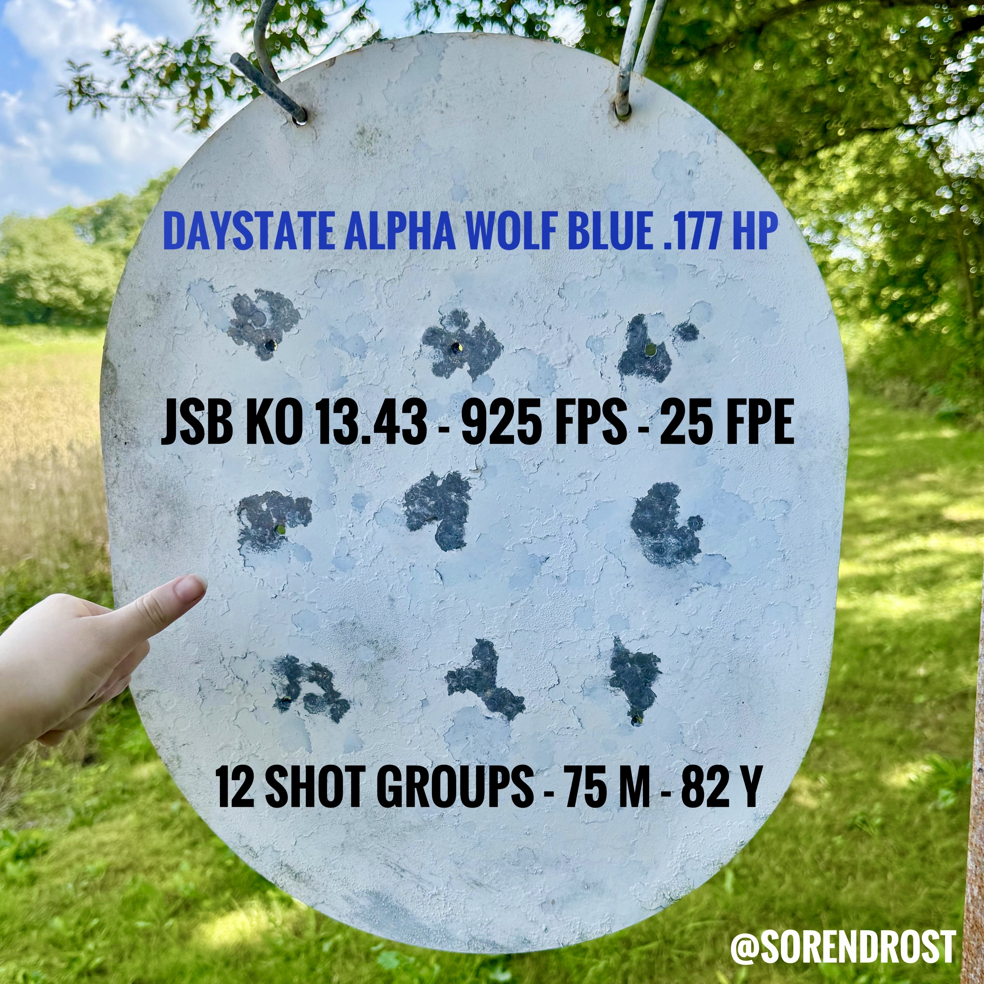

I have both a Daystate Delta Wolf .177 HP and also the Daystate Alpha Wolf Blue .177 HP 👍🙃🙂
Love both rifles and the ease of tuning 👍🙂🎯

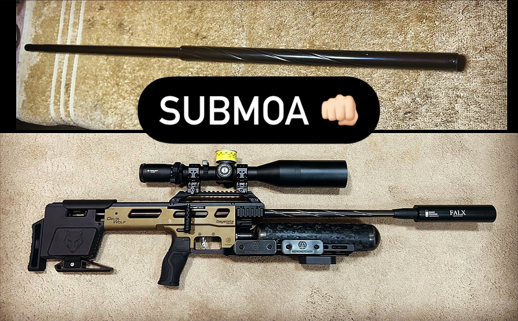

Montster Mags (Monte Shosted) is making great mags now. For those that want to know how to tune these guns, there are resources. Hopefully the barrels get better and more consistent. I believe SubMOA barrels to be really good.

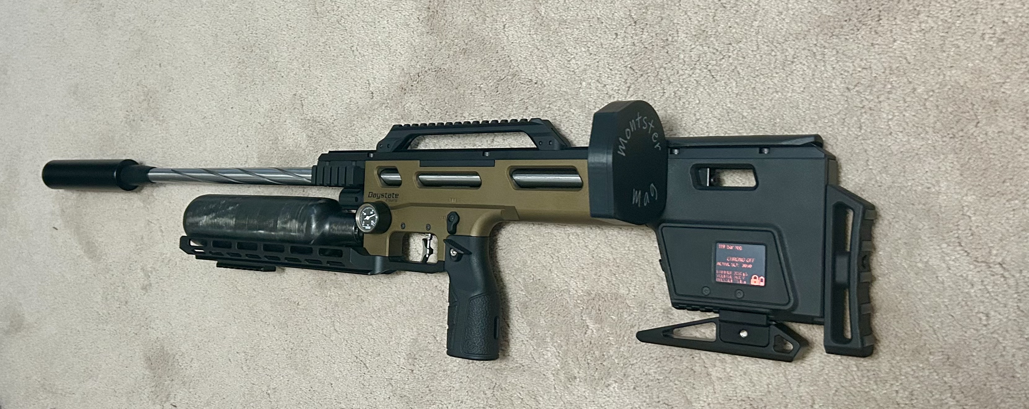

I’m really liking my Delta. Before and after bluing:
I see you deleted the chrono also, definitely the way to go.
