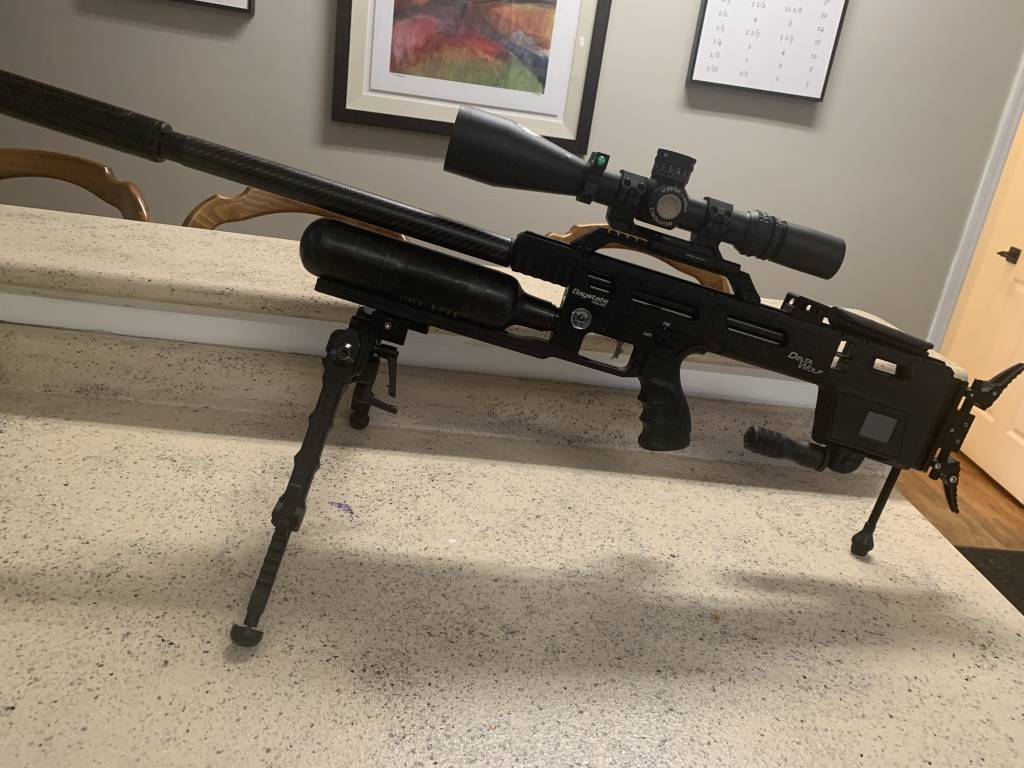

I received this Daystate Delta Wolf .22 cal. one week ago Saturday. I'm loving this gun -- much easier to tune than my FX Impact M3. I'll attempt to post some photos:

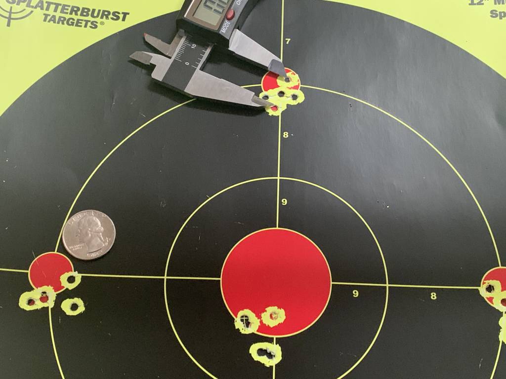

50 yard groups.

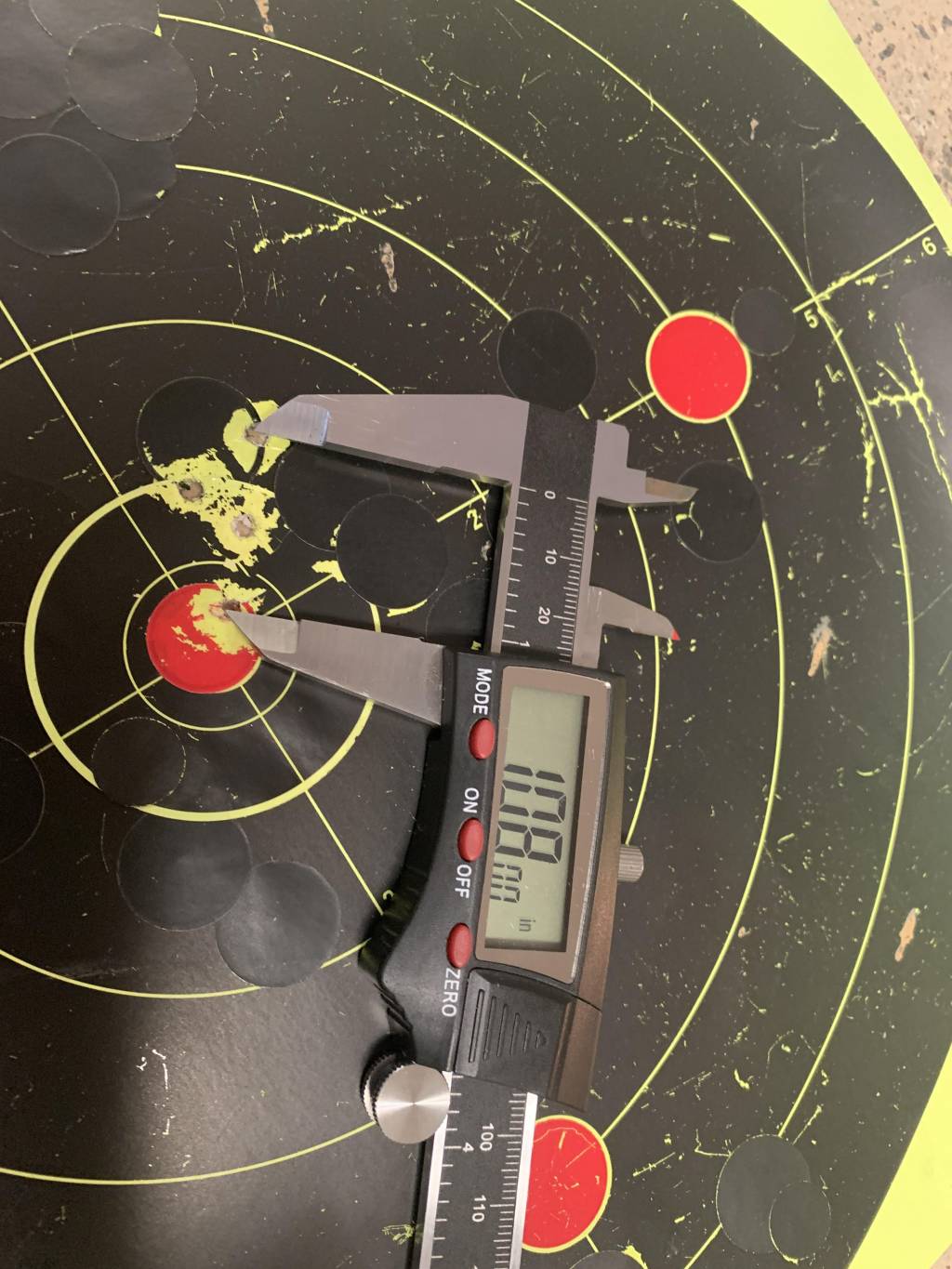

100 yards

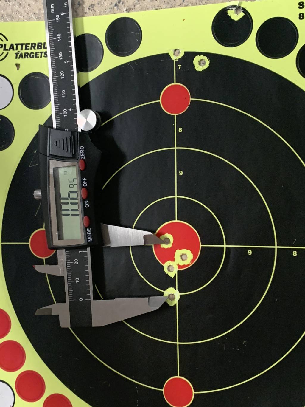

Looks like you still have a little bit of harmonic or muzzle blast issues. Pretty sure you can get all the holes touching at 50 yards which will shrink your 100 yard groups significantly. Don’t really have doubt the DW can or capable of 1 hole group at 50 and easy sub MOA at 100 if condition permits. Might take some tuning but try lower the speed just a little and/or reduce the dwell time.
Thanks for the tips. I'm still learning the rifle and using the "Factory" settings. Next time at the range, I may advance to the "Pro" set and adjust dwell time. Tis the beauty of Airgunning -----> experimentation.
