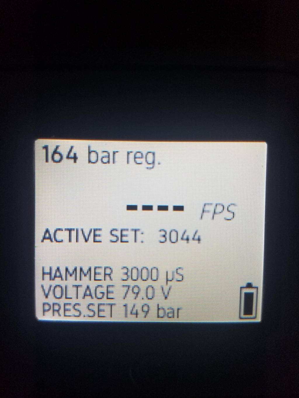

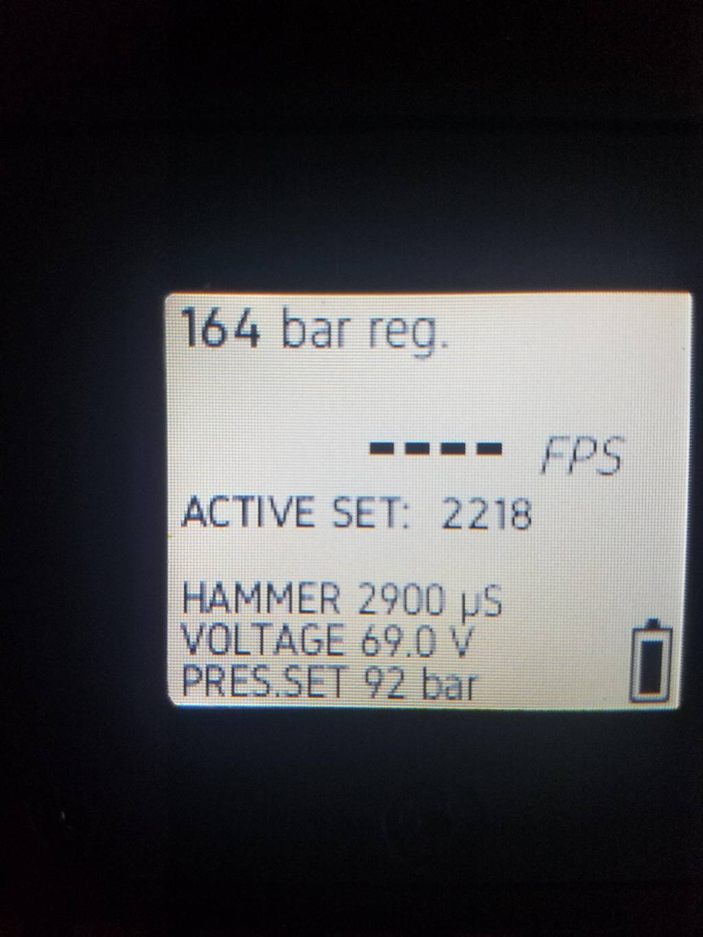

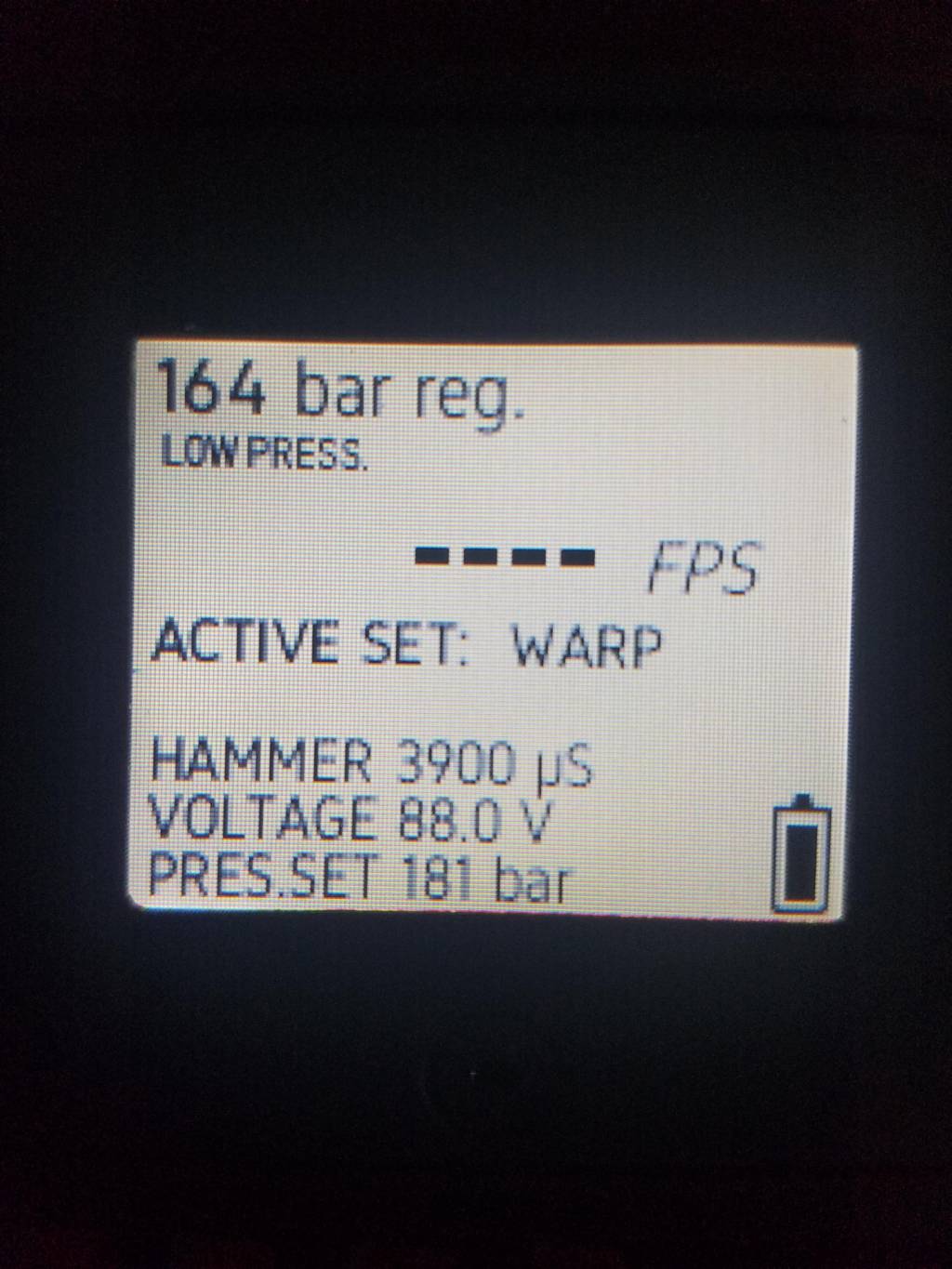

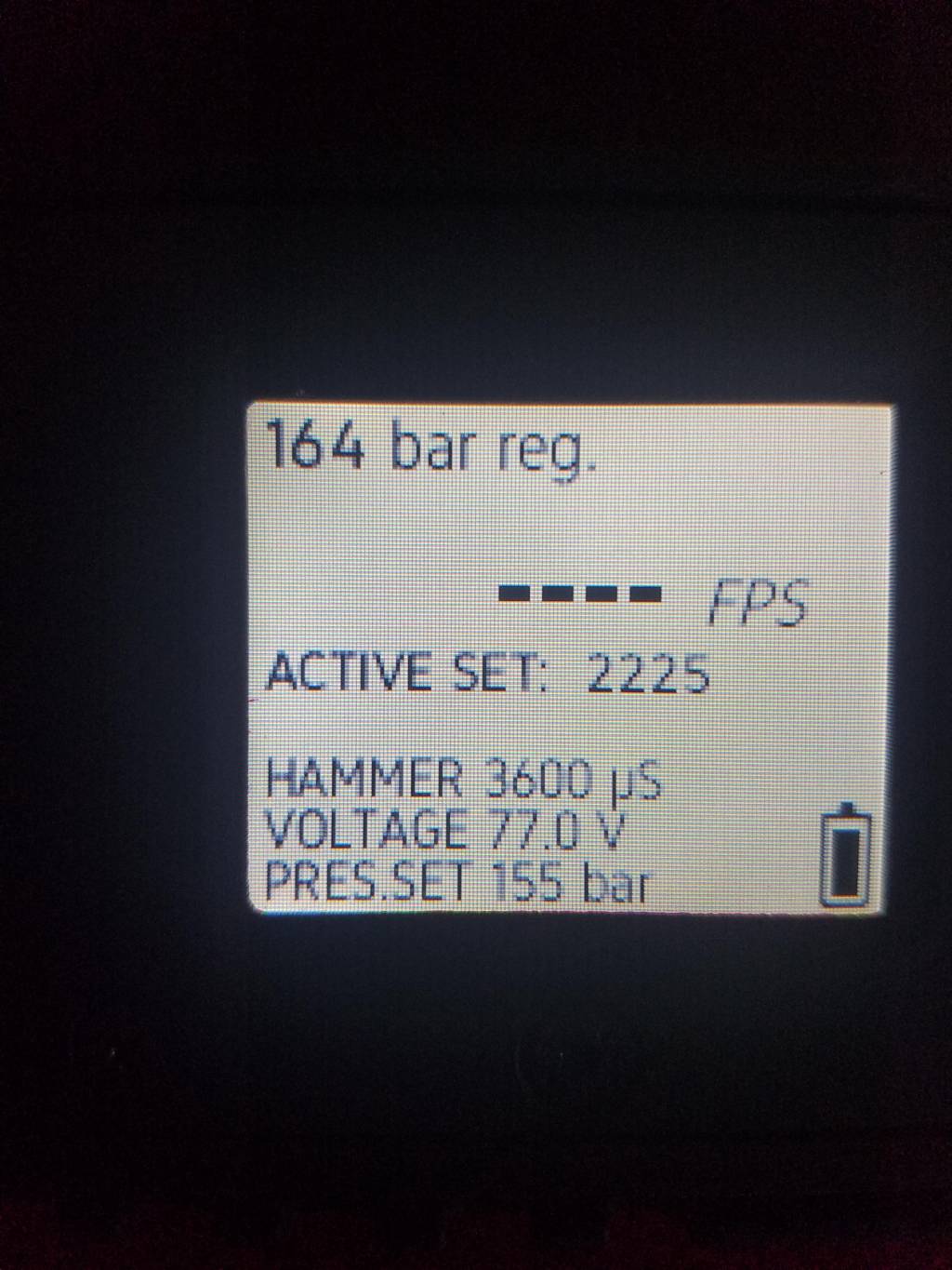

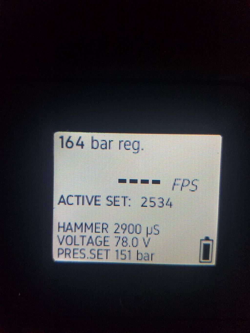

Hi all.
I noticed on AOA video on tuning the delta wolf that there are some presets in advanced settings that AOA preload into every delta wolf before leaving for the customer ( WARP, 2218,2225,3044 etc) but here in the united kingdom daystate have not done this with there high power FAC DW,s .
Can anybody in the united states give me the dwell time and voltage settings for each preset so i can load these into my advanced settings.
Thanks.
Paul
