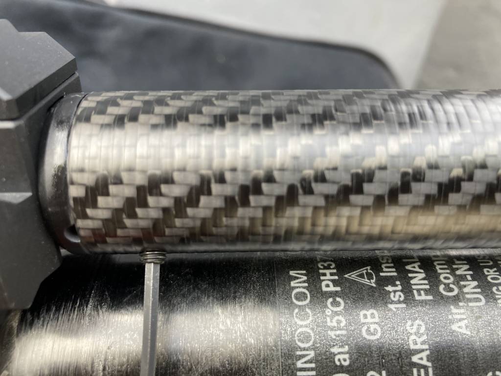

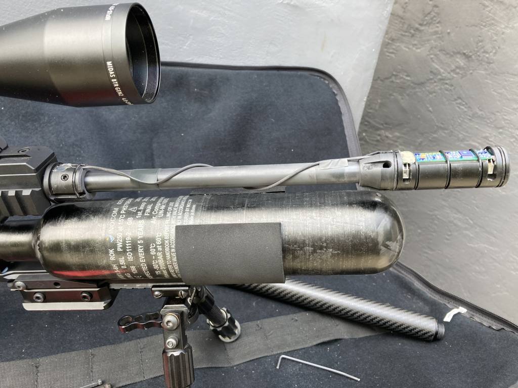

I have been wanting to polish the barrel on my DW but have been quite busy with work. I've put about 21 00 pellets through it and have cleaned the barrel several time. Barrel seems to need cleaning more regularly than when new. Do I have to remove the barrel from the shroud? If so, how? I'm concerned about the chrony while polishing and cleaning
There are two set screws which hold the shroud on and must must be removed. Then the Shroud pulls right off. After that there are the rear connector block and forward Chrony sensor block, connected to each other by three wires. I wouldn't polish the barrel without removing both of those. If you're careful its not a big deal. Take a few photos before you start and as you go in case you get stuck putting it back together.
