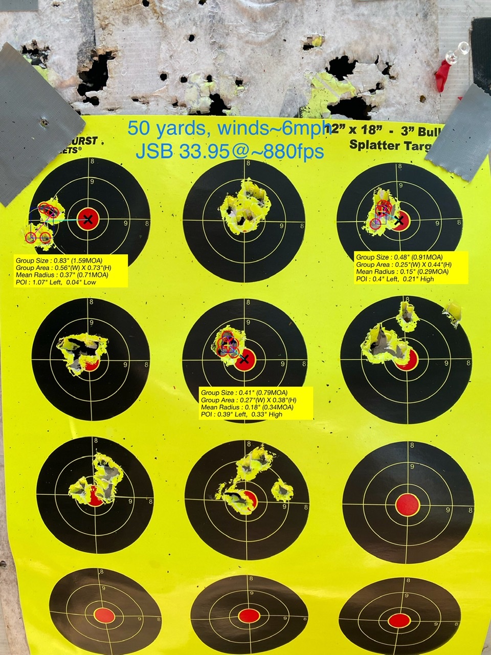

Here are some results I got using settings suggested by Centercut for advanced mode (3400 dwell, 78.5v, 146 bar). Regulator read 160 bar in my basement, went up to 165 bar after sitting outside at 92F for an hour, then dropped to 150 bar after blowing off an empty shot. Pretty much stayed there and first 20 shots varied from 869-889 fps.
First group is in upper left and got one .79moa

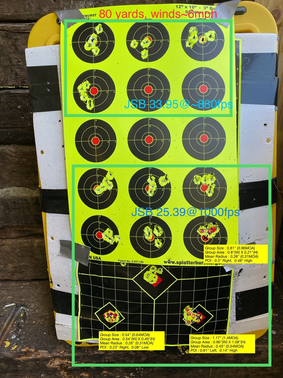

Moved out to 80 yards (couldn’t squeeze 100 into my yard) and got good results with the 33.95 mark IIs and decided to try some 25.39s. Was running out of time so shot them at the same settings and wasn’t expecting much since they were moving fast (1000 fps). They surprised me with one .64moa group! Wish I had had more time to play with the settings.
