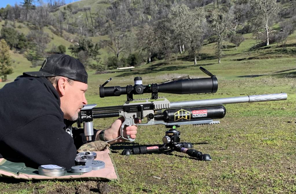

I got this scope, the Delta Stryker 5-50x56 SFP with the DLS-1 reticle, at the end of January but wanted to use it a couple dozen times, under varying conditions, at different ranges, and at different targets before I really posted what I thought of the scope. It only took a couple of trips before I knew this scope was a winner. Now though, after using it a couple dozen times, I can elaborate a little more accurately.
Delta Optical is based in Poland and the scopes are made in Japan. Delta has made a name for themselves over the past 3-4 years because they are a super great buy for the money, even at the cost of $1525. It’s that good! The Stryker comes with flip up caps, bikini covers sun shade and a removable throw lever. This scope is a target scope, designed for target shooting, more specifically, F-Class. It is not a tactical scope, even though it has tactical turrets. Because the magnification range is 5-50, I think it can be used for a lot of different purposes though. The scope’s ED glass is amazing, color, contrast, definition, brightness are all super with no distortion or aberration. It stays sharp and focuses clearly to somewhere around 47x before losing perfect clarity/focus. I used an optical calibration/focus target at 50, 75, 100, 135 and 165yds to test. The tracking is flawless, the turrets feel and sound is exceptional too. They are quiet clicks but you can hear them. The scope has a fast focus eye piece and it’s smooth! The turrets are lockable and also have a simple zero stop system. The reticle I got was the DLS-1 MIL(@40x) reticle in the SFP. The turrets are marked with 1/20mil clicks and 100 clicks(5mil) per revolution. The numbers are large and easy to see and there is a revolution indicator. It is illuminated but because just the small center dot is illuminated, I wouldn’t call it daylight usable, even though it’s bright. The reticle is simple and easy to use, I really like it although I would prefer if they had small numbers at 2, 4, 6, 8 mil for quicker acquisition. Parallax goes from 10 yards to infinity. The eye relief is between 9-12cm which is plenty, especially for an air gun. The Stryker weighs in at 35oz. It’s very heavy but I weigh 230lbs and have never considered the difference between 1 pound or less when choosing a scope. Just doesn’t matter one bit to me although I know it will to some of you. lol The scope is 15.75 inches long and has a 34mm tube. The adjustment range is 100moa elevation and 50moa windage. The warranty on this scope is 10 years. I know some of you will say “what, only ten years?” If you’ve quality optics, or any optics for that matter, you’ll know that with rifle scopes, problems usually show them selves early on. I can’t ever remember owning a scope that had problems show themselves after 10 years. If the warranty is something that worries you, you’ll have to consider it. I really don’t know what else to add other than the scope looks super, the glass, turrets and reticle are all phenomenal and the scope works flawlessly. I’ve kept this scope on 40x for the majority of my shooting although I did crank it up to 50x for testing. Very clear all the way to 50x but not perfect, it does lose a bit of clarity at between 47x-50x or so. It was hard to tell. The light gathering capabilities after dark were terrific. Although I’ve only had this scope for 3 weeks and used it a couple dozen times, I have fallen in love with it. I recommended it to a friend here on the forum who bought one and also loves it...Maybe he’ll chime in with his thoughts. I’m probably forgetting something so if you have any questions, please don’t hesitate to ask. Before purchasing this scope, I watched and read plenty of reviews. The one thing that I kept hearing, over and over was that this scope gives you the best bang for the buck and has many features, glass quality/construction/coatings as much higher priced scopes. Dark Lord of Optics and Joe (Cyclops) are two of the best scope reviewers on line and helped talk me into this scope. I’m glad they did. I absolutely love it!!!

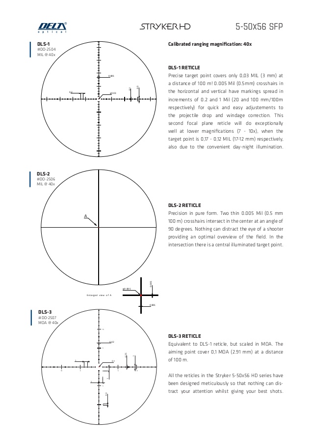

Here are the specs from Delta Optical:
Serie: Stryker HD
Magnification [x]:5 – 50
Objective diameter [mm]:56
Reticle:DLS-1, DLS-2, DLS-3
Illuminated reticle: Yes
Angular field of view [degrees]:4.04 – 0.41
Linear field of view at 1000m [m]:7.1 – 0.7
Exit pupil [mm]:7.2 – 1.1
Eye relief [mm]:89-100
Water resistance:0.3kg/cm2
Weight [g]:1 100
Length [mm]:363
One click:0.05 MIL
Max. elevation / windage adjustment range :100 / 50 MOA
Tube:34 mm (1 piece)
Parallax Adjustment: Side focus (10 m - ∞)
Reticle position: Second focal plane(SFP)
Functional temperature range [°C]:-20 — +71
Nitrogen filling: Yes
Remarks: ZeroLock

The reticle is pretty fine and definitely a great point. I prefer fine reticles and can’t stand thick ones anymore. My favorite is the Vortex Golden Eagle’s reticle followed by this one. My boys and I shoot at some tiny little targets at 100+ yards which was exactly why I wanted a SFP, fine reticle. It’s like anything else, personal preference and also depends what it will be used for.

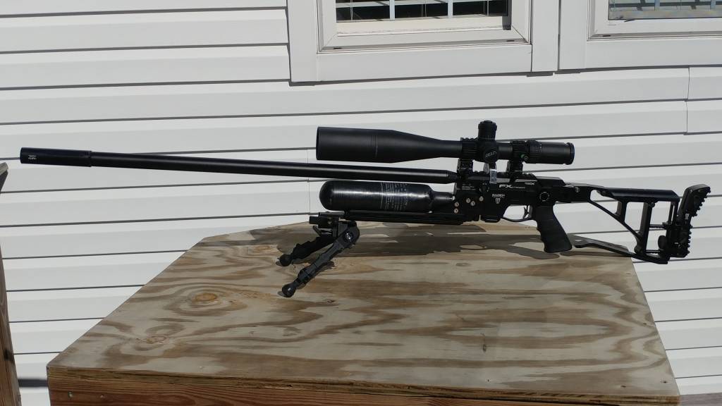

I'm that "friend" that stoti goat roped into getting one these dern Delta Stryker 5-50x56s. Totally destroyed my meager savings account and now I'll be eating oatmeal for the next 3 months. I do like it though. It sits atop a RAW .177 HV and it's as fine as a frog hair. I have the DLS-3 MOA reticle and it is just a touch thinner than what I am used to, but presents no problem, especially with the illuminated floating dot. The RAW is new and I was on the verge of getting a Sightron SIII when stoti started beating me about the head and shoulder to get this blasted Stryker. Sigh ... what's done is done. Did I mention I don't like oatmeal?

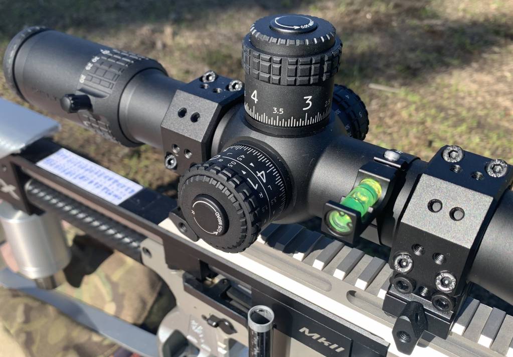

It'd make a great FT scope with 10Y minimum focus. Range at 50x, and shoot on 40x where mils are correct. 5 mil turret so you aren't going over a rev and plenty of travel too. I like mil/mil so it's good there. LOVE the big numbers on the turrets!!!
For a SFP I'd try one. I actually like the simple .2 mil reticle without numbers directly off the vertical! Like you said, we all prefer different things.
