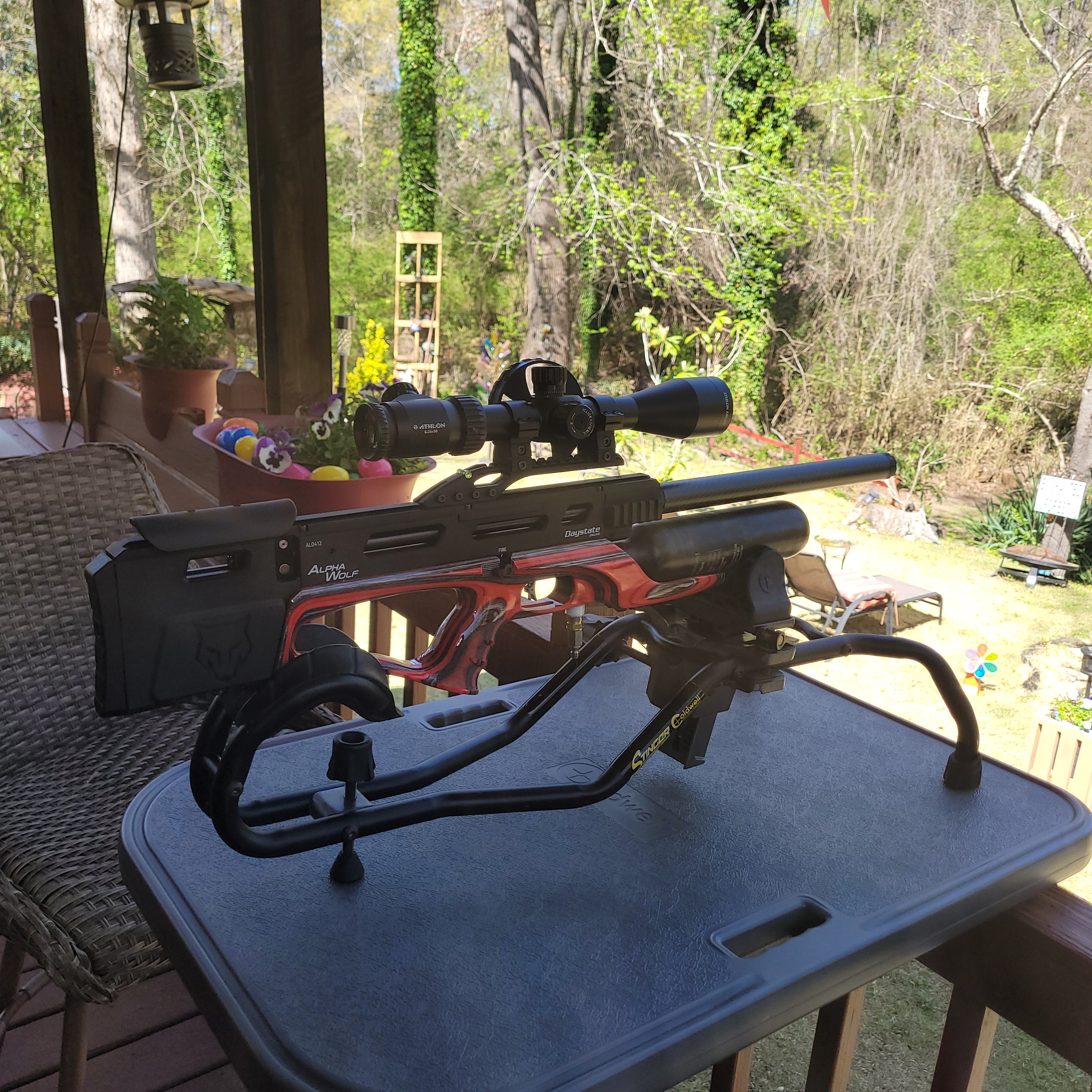

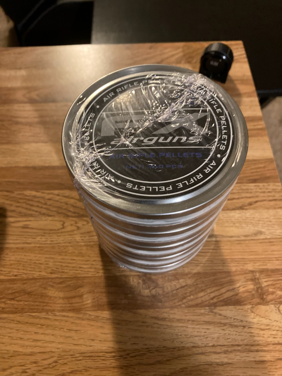

Art 5 Grove 1-30 twist .22 lite choke bbl. Love to be hotrodded. Jsb 18.1 @ 1000 fps and fx 25.4 rdn @ 970. The fx are way more consistent then jsb out the tin. Call the wind right and smashed a few eggs @ 130 yds.
