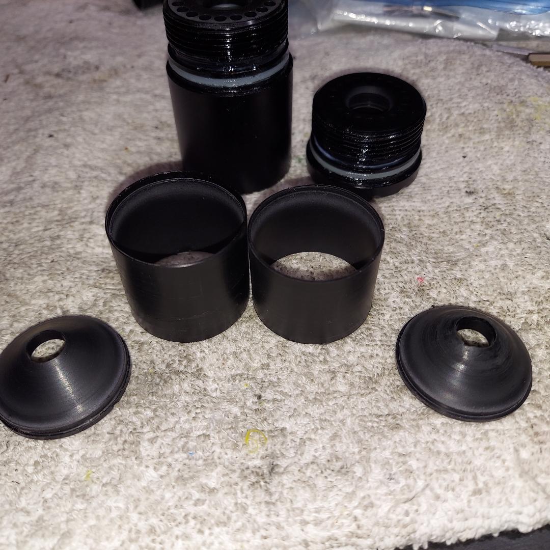

Has anyone tried using Delrin for moderator baffles? It's easy to machine..easier than aluminum..
I'm thinking of making an attachment to replace the RTI barrel centering part with the teeny-tiny (semi-useless) holes. The hole size just seems insufficient to allow air to pass into the shroud, plus half the hole OD is blocked by the part's O-ring.
The concept is to replace the RTI part and make something like a muzzle brake that will be contained inside the shroud and shroud end-cap. The part would double as the barrel centering device and allow for unrestricted air flow back into the standard ~1" OD shroud and around the barrel..
I could probably use aluminum, but feel it would be easier to test something made with Delrin..if it's strong enough.
Absolutely ... have for years ! and even BIG baffles subjected to big power.
Here some customs made up for my SKOUT .30 getting subjected too @ 100 fpe energy air blasts
