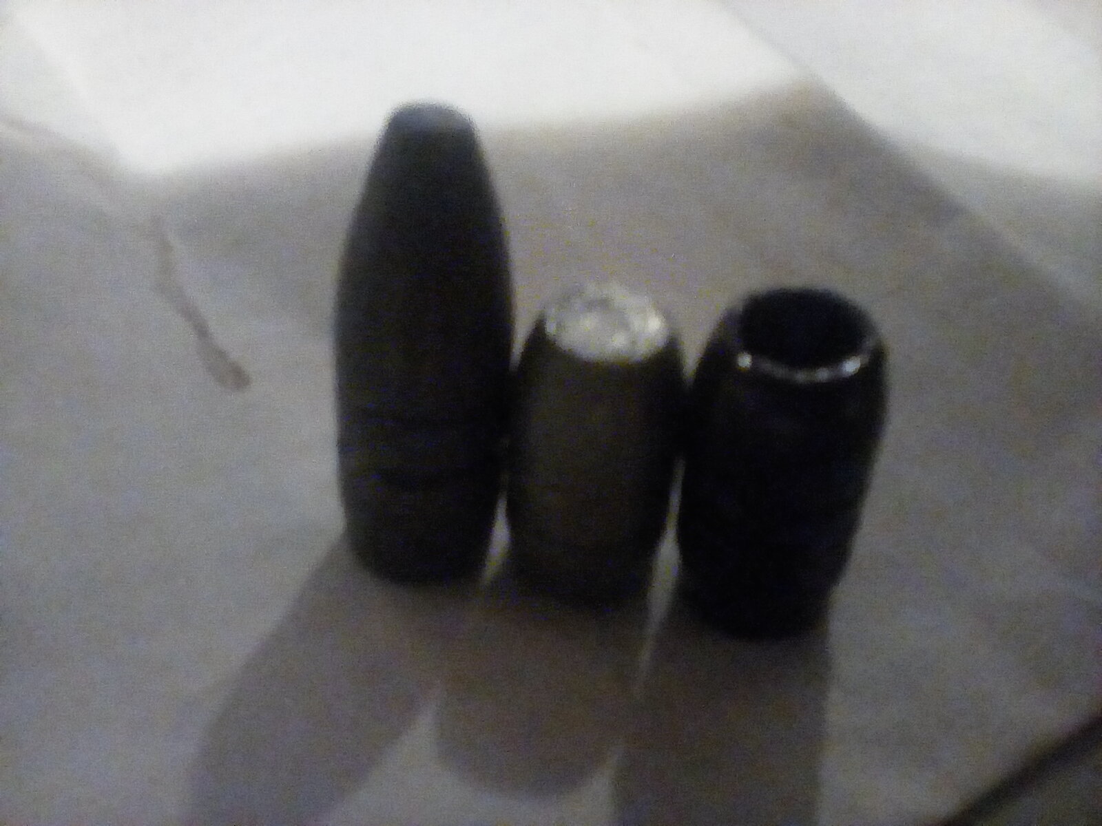

Chick thief is 100 percent right on about air sources. I run around 300 lbs of lead through my 50 Texan. Rebuilt yong heng compressor 4 times. I have know even worn out the cylinder heads. About 8-10 refills on 45mi scba tank.before rebuild. 45mi. Scba tank filled to 4300 psi regulated to 3625 gets 40 shots at most. I have N.O.E molds that shoot well 460 grain sized to 510- best weight for normal use 860 fps. Have accurate mold 650 grain spire point boat tail shoots well 750 fps. Velocity drops down in cold weather.
Reactions: Someone else
Lee.mold .515-450 grain 2 cavity mold $25.00 lee sizeing kit to.510 $25.00. They may shoot well in your gun. The regular NOE mold was only around $100.00 Lead cheap to acquire at local scrap yards. A regulator is a must for me both my Texan and Airsaber. I bought the regular Cf model and actually threaded my barrel with Donny FL and extra extension. Mine is loud with just the emperor but with the extension .ssssshhhhh . if it wasn't for the help here I would never been able to repair diagnosis the problems that come with pcp. I went yong heng route no funds. I wouldn't recommend . booster pump best option under a grand. Yong hengs work but you better be mechanically inclined. They definitely wear out.

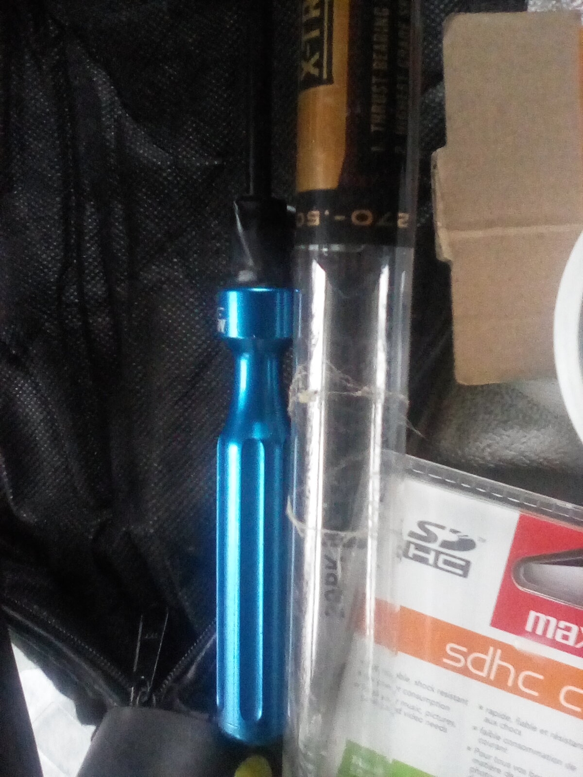

Fibreglass and even more so carbinfiber is extremely abrasice, so be prudent to wear your cleaning rods with some sort of shrink tube!
A decent muffler is way batter than none!
From there you can pick and choose, but protect those ears.
They can p
Very cool! I appreciate all the input for sure! Anyone have any tips on cleaning kits? Black powder cleaning kits ok, or are there ones for airguns?
I've seen one video where someone put an emperor on the LSS and it was really quiet. I was thinking of doing the same, but I'm working on getting the basics first LOL. I see people shooting the LSS without ear protection, and it didn't seem loud over the video, so I'm hoping the emperor can wait a little while.
Get a .50 cal boresnake and be done with it!
It'll do anything you want and once in a fullmoon you'll add a little WD40 or the like for cleaning.
That Montana extreme rod is the same type used by 1000 yard bench rest shooters. Everything on that rod is brass or softer than 4140 chrome moly. If your barrel is good a bore snake will clean and is cheap. My barrel was so rough A bore snake wouldn't remove all the lead. Im not afraid of a brass brush. Texan .510barrel same barrel as .510 muzzleloader. I'm used to accuracy and cleaning barrels is important. At many bench rest powder burner matches they would clean between every yardage. Winners cleaned often and used brushes. Barrels only wore out due to throat erosion. Not brushes or cleaning rods. I didn't clean that often and I didn't win .my observations of older bench rest shooters who won matches consistently.
