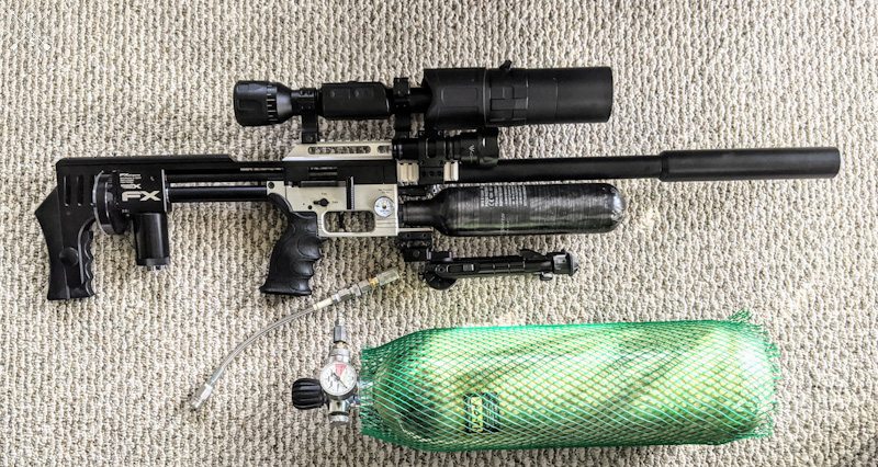

What about a smaller CF tank? A little 30 minute tank won't take up much more room than a compressor and will weigh less.
My set-up.
