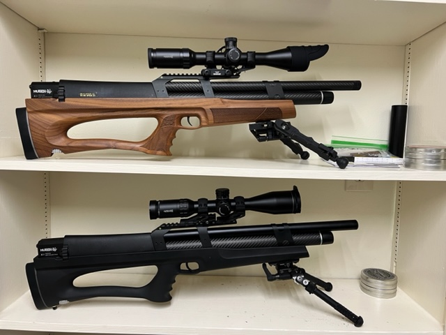

I would throw the Huben .25 cal in the mix for damn sure.
Short
Shoulders well
Stupid power if you want it
Semi Auto
Accurate with pellets and slugs
My 2021 Limited Edition is shooting 33.95 pellets moa at 102 yards if i do my part
With the ZAN .253, 6.41, 33gr slugs it shoots sub moa at 102 if i do my part
Like the gun so much i bought a 2022 in .22 cal !
