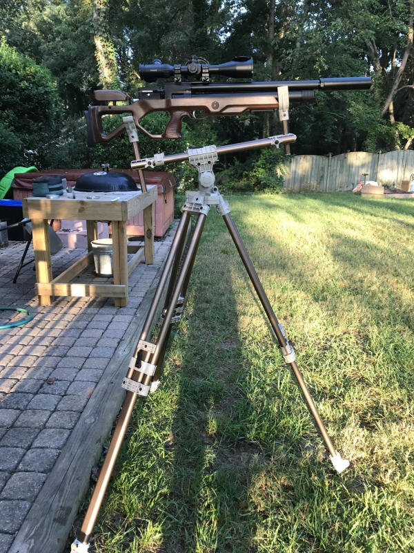

BTW. I got my Mag Fieldpod. I likes it a lot.
Sorry I corrected it. It shoots 16 gr at 940 and 18 gr at 900. Also, a little heads up about the fieldpod. Be very careful about knocking it over. Those arm rests are very thin and easy to bend. I tripped over a leg on mines and knocked it down and bent one of the rests. When I tried to straighten it, it broke completely. I couldn't find a replacement, but I was lucky enough to have a friend who is a machinist. He made me some arm rests made of delrin. You will notice the rests on mine are different. Delrin is very tough so no worries about knocking it over now.
