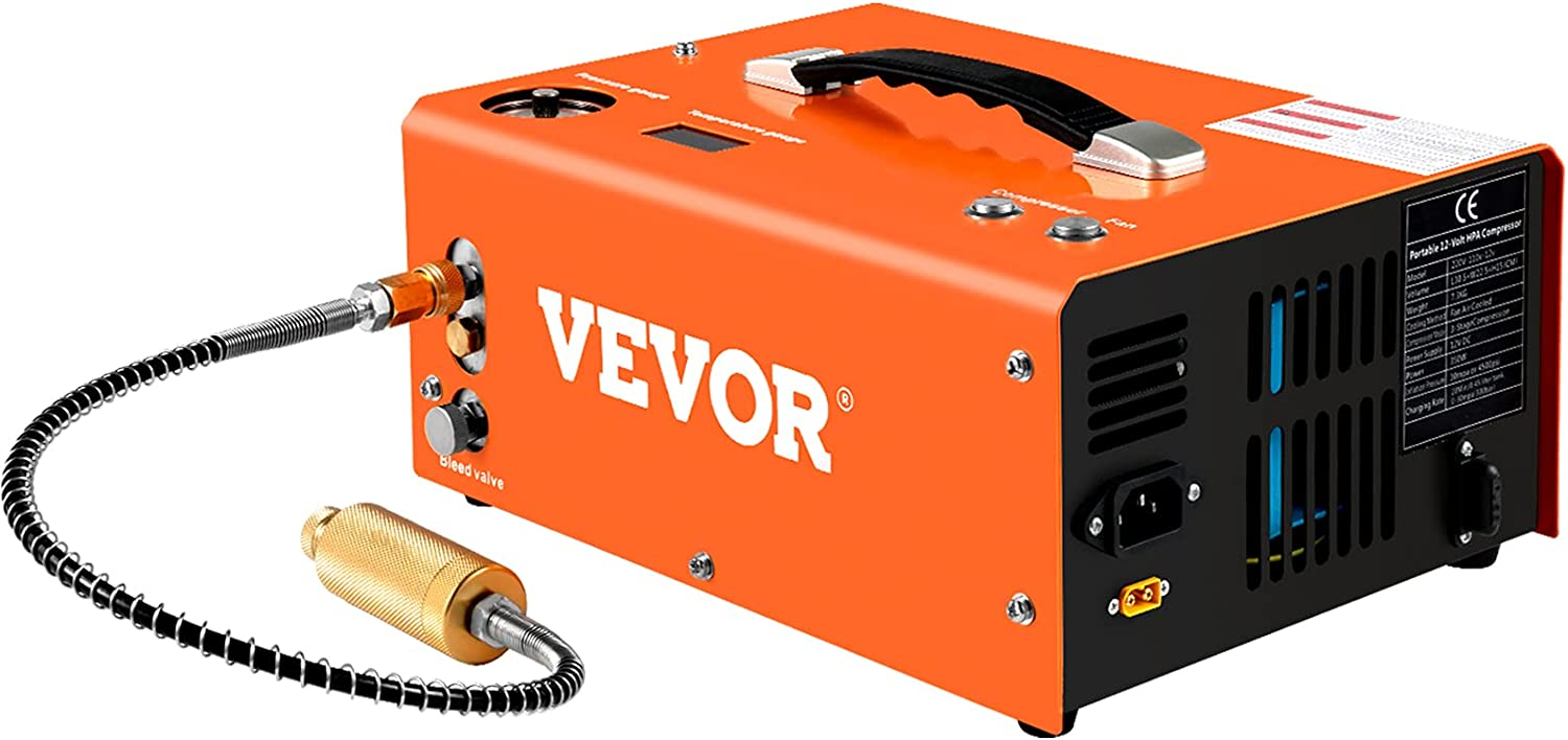

Yes I resemble that remark, and took the chance. I filled a 1720 four times, 1701 twice, and anAA S500XS once for a total of seven times used. Never got over 23c, but that is irrelevant.
During the 8th fill it shut off as though it was unplugged from the wall. Clearly an electrical failure.

Did you try moving the auto stop needle around ? Possibly a bad connection there. Good luck getting it up and running. Hope it's an easy fix.

Yes, I moved the auto stop needle back and forth. But when the auto shut off kicked in, the display and the fan stay on. It’s either the transformer or the circuit board.
