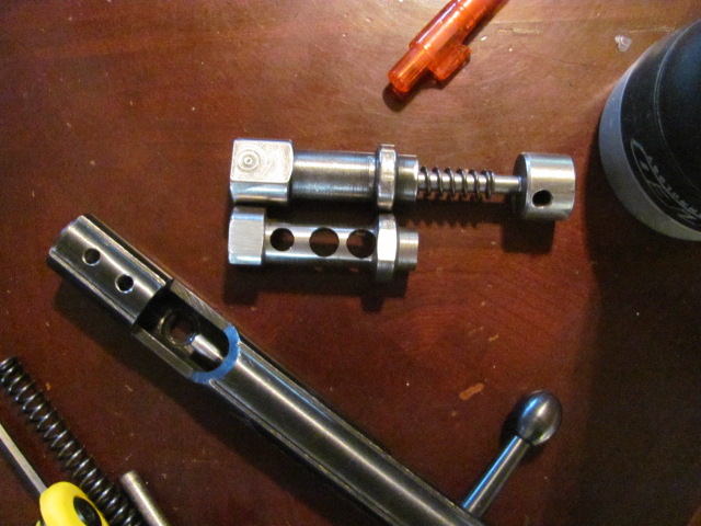

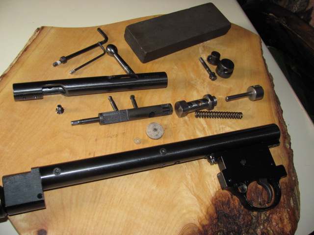

Mine is a QB78 on HPA so don't really know exactly what to expect on Co2. Also have a custom valve & stem so...
Just a picture of the lightened hammer and the Felt "stopper" (like a bstanly before it's time) made for a table leg or such.

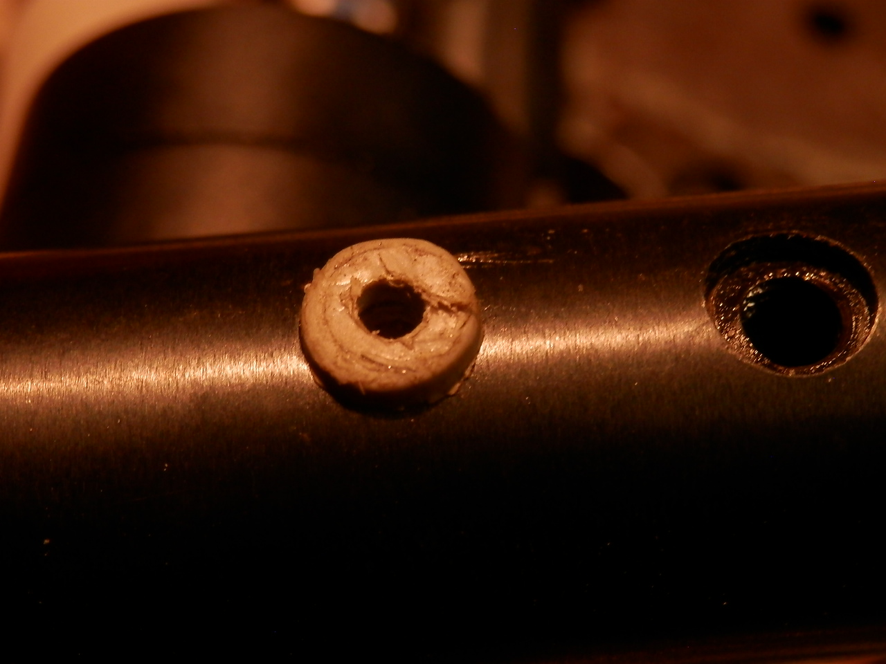

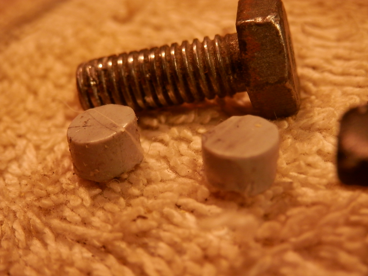

The o-rings are size #113. You can find them at just about any good hardware supply place.
I made the transfer port seal from the plastic of an unused toilet lid. (Us welders do tend to keep scrap piles.) I drilled out the nipple end of a used co2 cartridge with a 1/4" bit and used it as a punch (in a vise) to make a slug, then drilled the inside of that out to what I wanted. Pics attached. You need one about .243" wide and .120" thick. Mine was a bit tall and I had to file it down some.

Hey Kenny,
